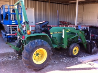

Here is a picture of our Deere
/ John Deere 770 tires?? #10
Deeregirl85,
I recently purchased a "04 JD790 and have been doing research on its operation. The old saying "Don't know what I don't know" applies with me so proper ballest and weight distribution came to mind whenlooking at the 770 picture you posted with the Loader, I don't any wheel weights nor a ballast box if you're doing any heavy lifting. I noticed grsthegreat mentioned the "go bang" front end, you might want to read this thread, again not sure if it applies to the 770 or the tractor pictured is 4WD..........
