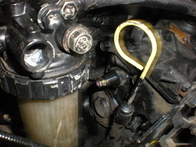

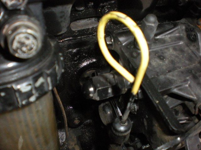

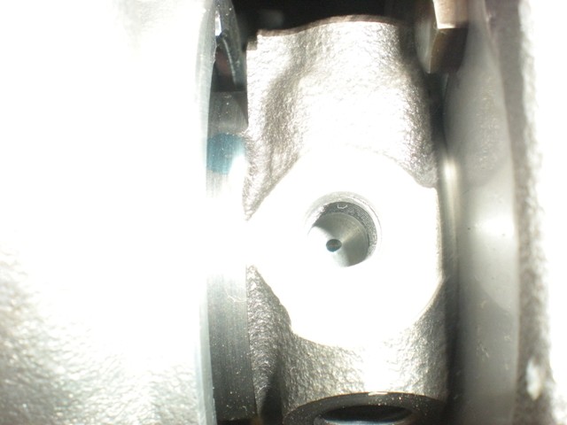

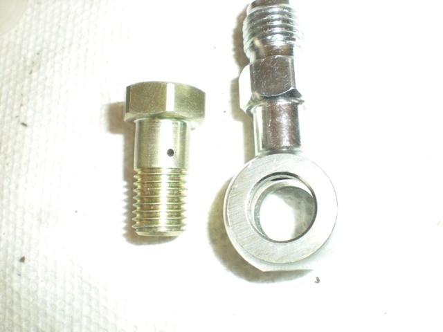

I did a little work this morning on the install project. It didn't go as well as planned. I need to get some parts to fix my welder.
Iwheel the oil line is restricted by two small holes.

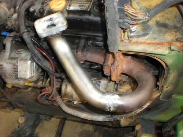

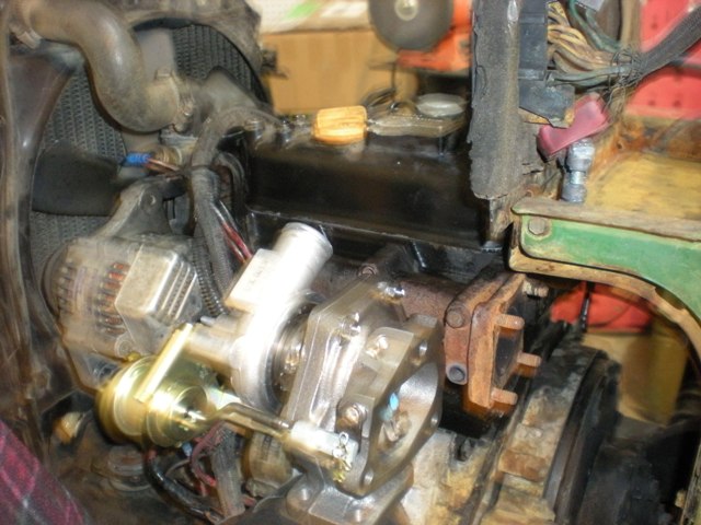

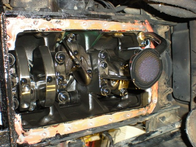

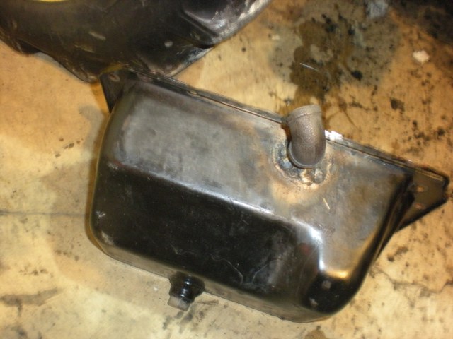

I did some more work on the turbo today. When I pulled the valve cover I thought someone might have been in the engine before. When I pulled the oil pan, some was definitely in the engine before. The oil pan gasket is no longer available. The pan was RTVed without a gasket and the bolts were loctited. I broke one, so tomorrow I will have to fix that. Anyways here is todays progress.

I got the tractor running today. I haven't turned up the fuel yet, but I got 3 psi driving in the driveway full throttle in high range.

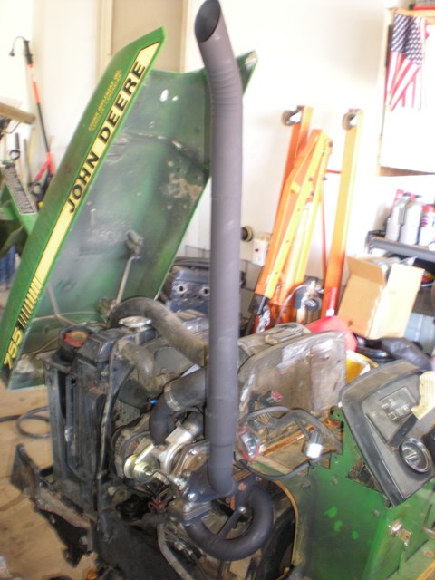

/ John Deere 755 Turbo
#24

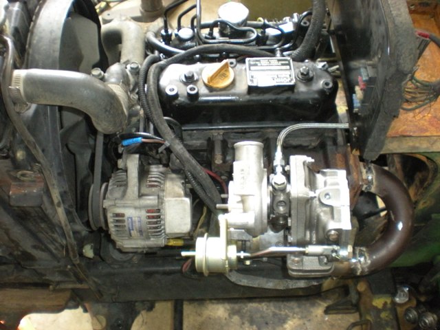

Here are some photos of todays work. I still have some work to do before I take it back apart and paint it. The turbo has a good sound to it. Hopefully I can get it finished this weekend. I have to make a thumb and some forks.

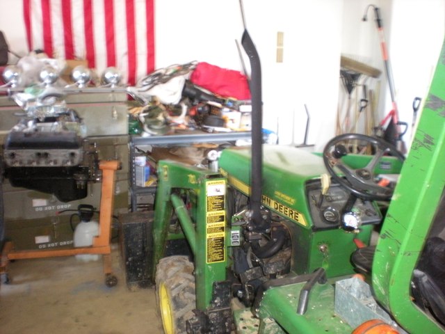

#25

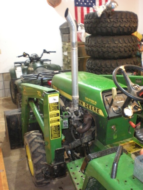

I finished the exhaust today. I don't think it is that much louder than stock. I turned the fuel up a half a turn or three flats. The turbo really woke up the tractor. I was doing some loader work today, and the engine was starting to bog a little. I looked down and I had it in high range. It runs better now in high than it did in low.

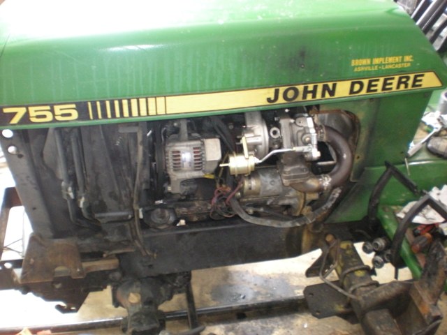

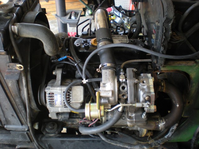

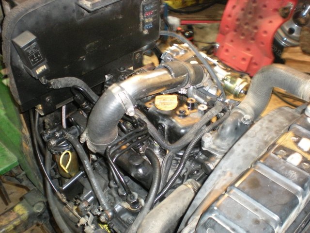

#34
So far I put over five hours on the tractor since installing the turbo. It runs a lot better than before. When I plowed the garden, it would hold four psi in low range. It sounds like a larger piece of machinary than it is.

/ John Deere 755 Turbo #35
Did you play with the smoke screw?
#36
I put about one turn on the smoke screw. I don't want to go more until I put my pyro on it and a temp guage.

I ordered the turbo from Ebay. I ordered from someone who claimed 3 to 5 day shipping from California. Two weeks later it came from China.
I got a Mitsubishi TD02 twin scroll. It was harder to hook up the twin scroll over the single. I was told they are better, but I would be willing to try the single. Going with the single will save you about $100.00. Small Garrett's will work too, but they cost more.
