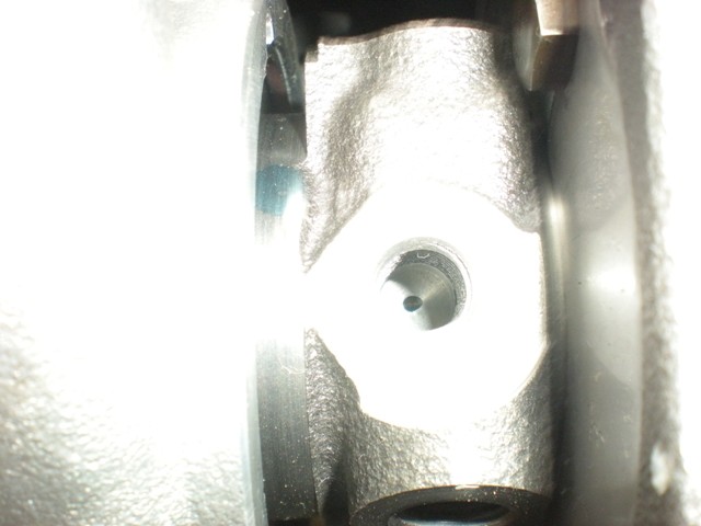

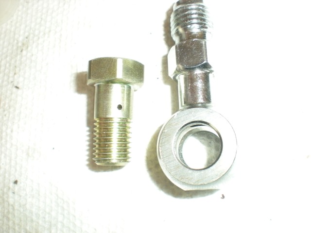

I did a little work this morning on the install project. It didn't go as well as planned. I need to get some parts to fix my welder.
Iwheel the oil line is restricted by two small holes.

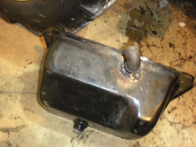

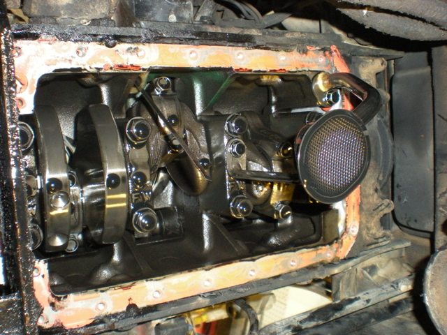

I did some more work on the turbo today. When I pulled the valve cover I thought someone might have been in the engine before. When I pulled the oil pan, some was definitely in the engine before. The oil pan gasket is no longer available. The pan was RTVed without a gasket and the bolts were loctited. I broke one, so tomorrow I will have to fix that. Anyways here is todays progress.

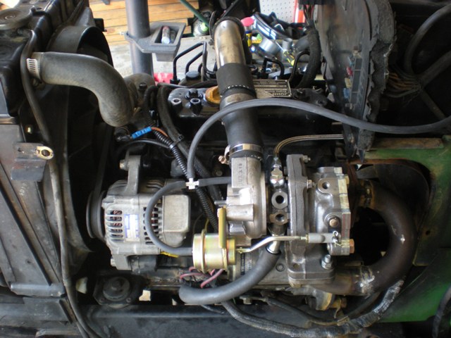

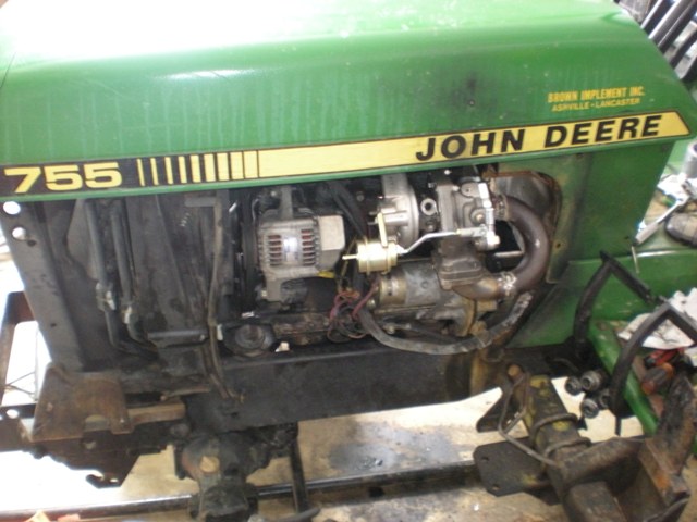

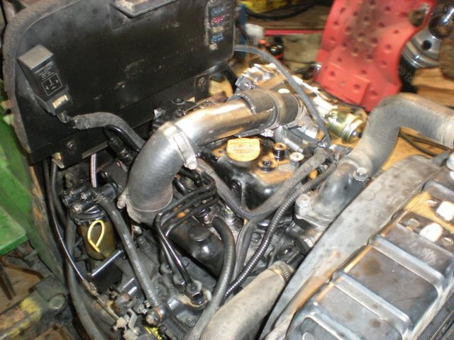

Here are some photos of todays work. I still have some work to do before I take it back apart and paint it. The turbo has a good sound to it. Hopefully I can get it finished this weekend. I have to make a thumb and some forks.

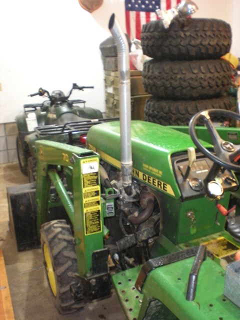

#25

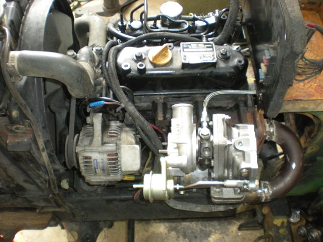

I finished the exhaust today. I don't think it is that much louder than stock. I turned the fuel up a half a turn or three flats. The turbo really woke up the tractor. I was doing some loader work today, and the engine was starting to bog a little. I looked down and I had it in high range. It runs better now in high than it did in low.
