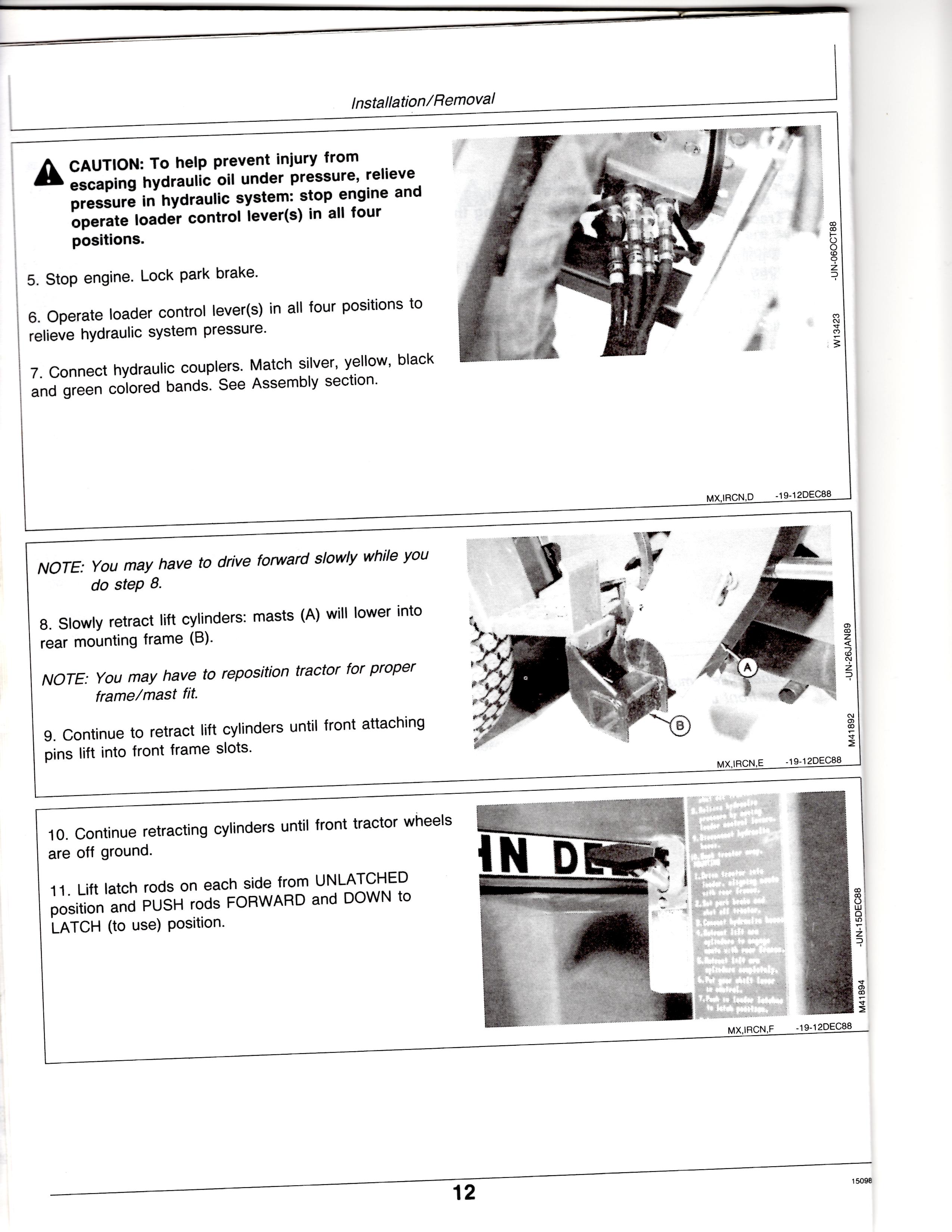

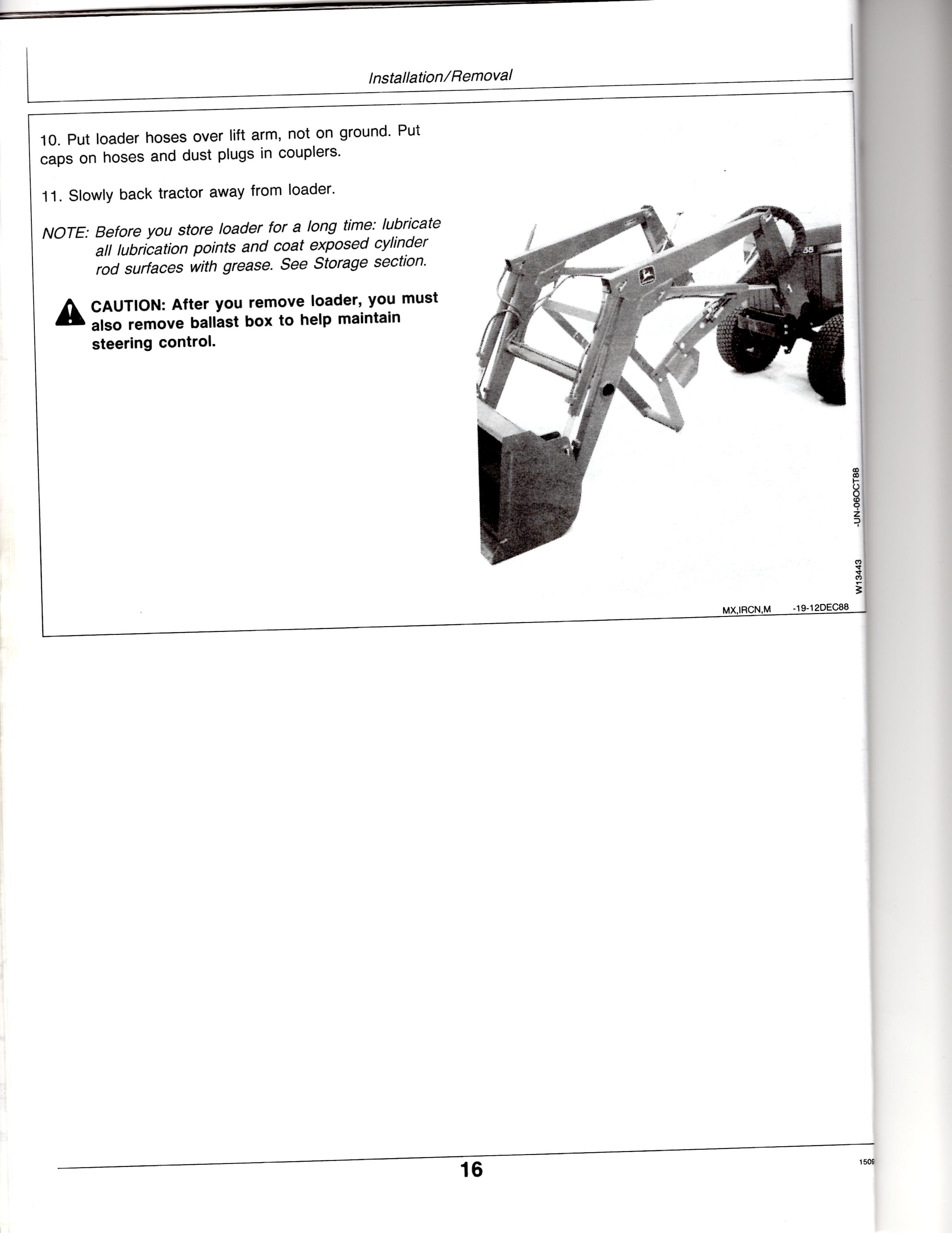

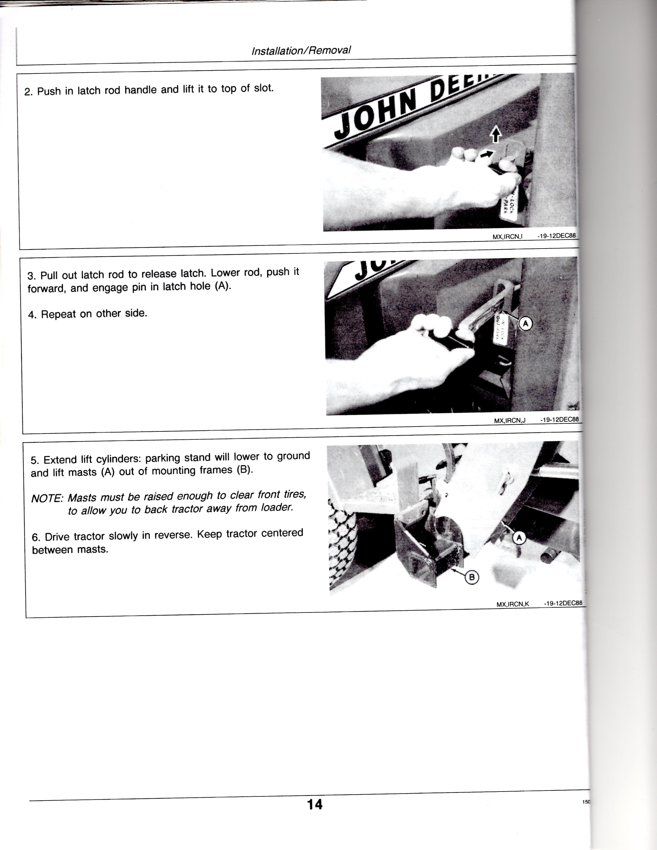

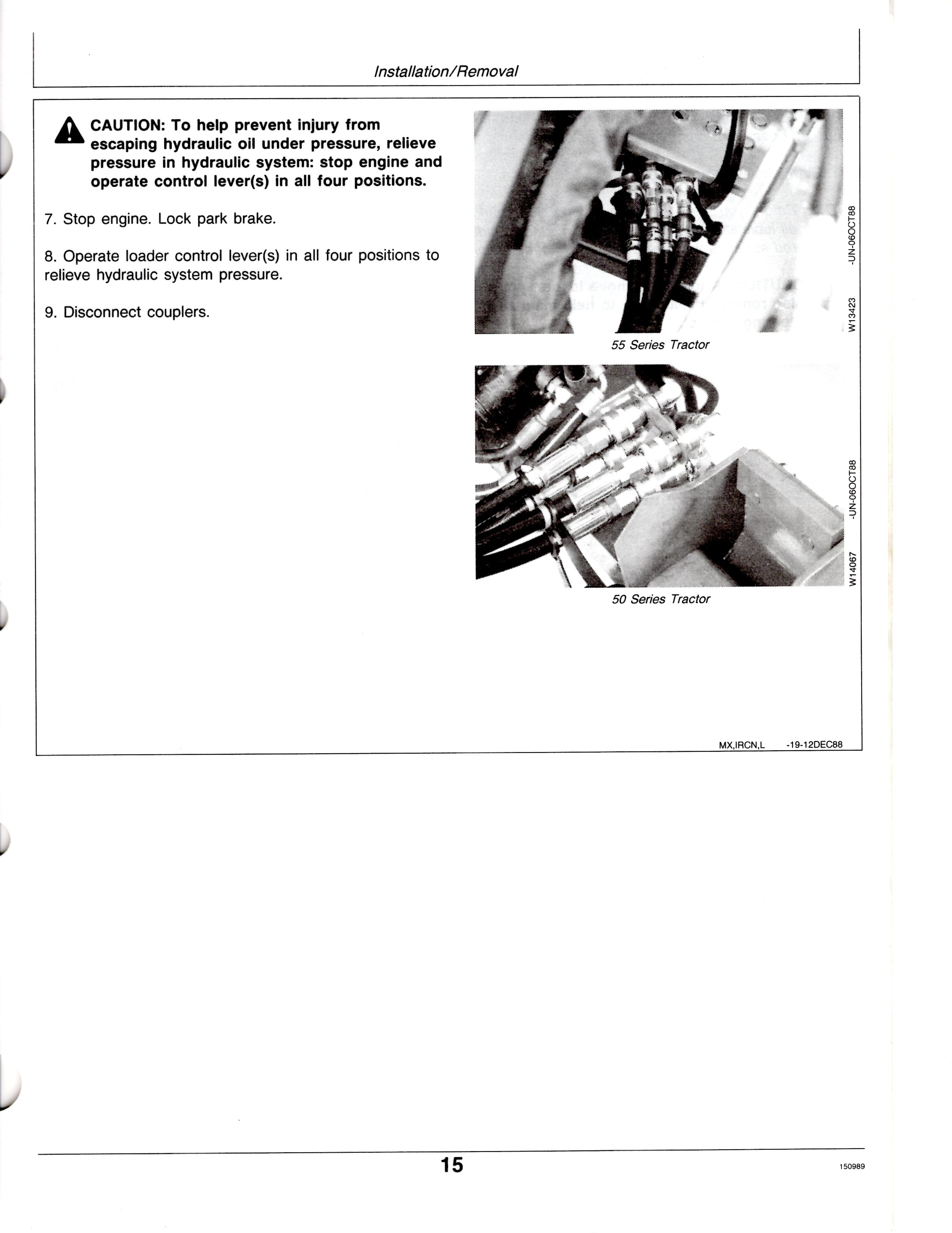

70 Loader instructions attached. Note that you need to use the loader to raise the front tires off the ground when latching/unlatching the loader.

Update to where i am. Got the FEL off with no issues. Thank you so much for the video hotrod1016! One less oil leak, setting until i get time and parts to fix; should be easy enough........Now for the oil pressure. I finally got a manual gauge and ran tractor a little today. Sure enough, psi is about 18-20 at start, and drops to right at 10 psi on a warm engine at mid-throttle; hence the idiot light coming on. It is doing what it should. My pressure fluctuates with RPM; from about 11-12 at WOT to about 5 at idle. Is it safe to assume from this that oil pump screen can be ruled out? Sounds more to me like worn rod and main bearings? Please help me with some options/advice:
