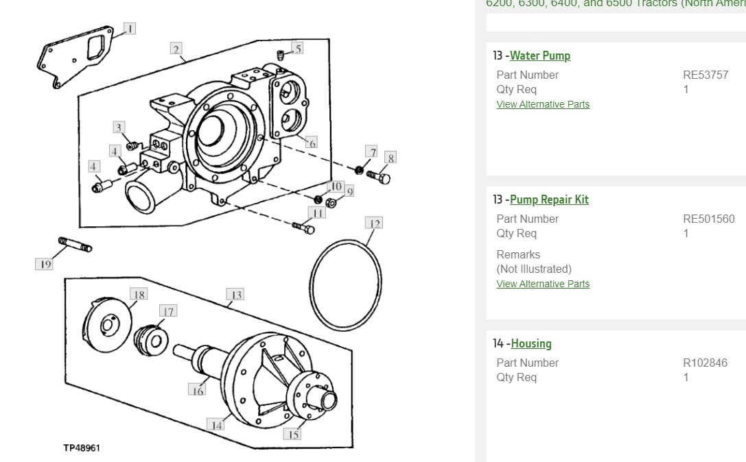

Anyone replaced the water pump? Do I have to pull the whole front end off first? Not much on Youtube.
Any pointers?
It is dripping after you shut it down. Don't see it leaking while its running.
/ John Deere 6400 Water Pump replacement! #2
Consider rebuilding it verses replacing it. They wanted $650 for a rebuilt one at the JD dealership - not that Id go there unless I had to - but the rebuild kit was only $53.

Did you remove it yourself?
/ John Deere 6400 Water Pump replacement! #4
Yes
It will most likey be fairly integrated into the front of the engine, even so its better than having Jd come out and service it
/ John Deere 6400 Water Pump replacement! #5
Yes
Ya looking like I have to take the front end off and that doesnt look appealing to me.

I recently replaced the water pump on my 2005 jd5105. Dealer wanted $866 for a new one. I found a new aftermarket pump for $230 total on Amazon. I wrestled with the job for about 3 hours total. I’m getting old.

trying to revive this we haven't fixed it yet. Only video I could find online was horrible and basically said you must remove the entire front of the tractor radiator and everything to access the pump
/ John Deere 6400 Water Pump replacement! #10
Not planning to attempt it until after you find a video that shows how without removing the radiator?
#11
no it is a small leak and obviously needs to be done it is still working not overheating. Just trying to get it planned and the plan of attack.
