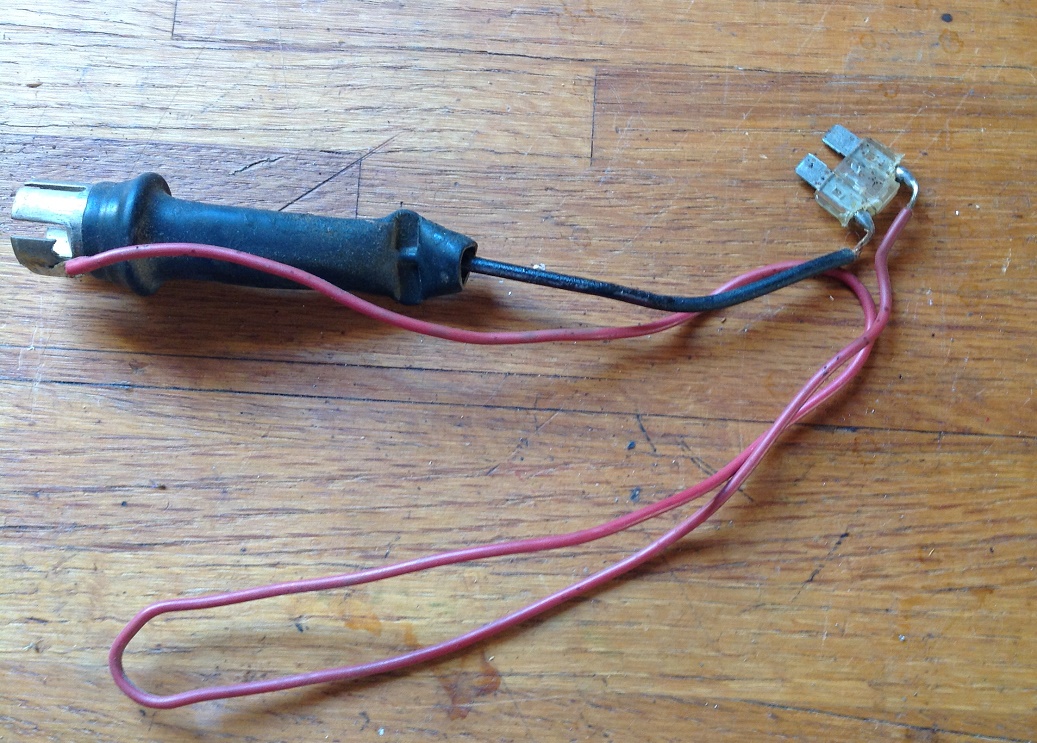

One way to find a short, and not keep blowing fuses, is to rig a 12v bulb to plug into the fuse spot. If a short, the bulb lights up. When the short is tracked down (moving wires around, or lifting them from their terminal) then the light goes out. Saves blowing fuses.

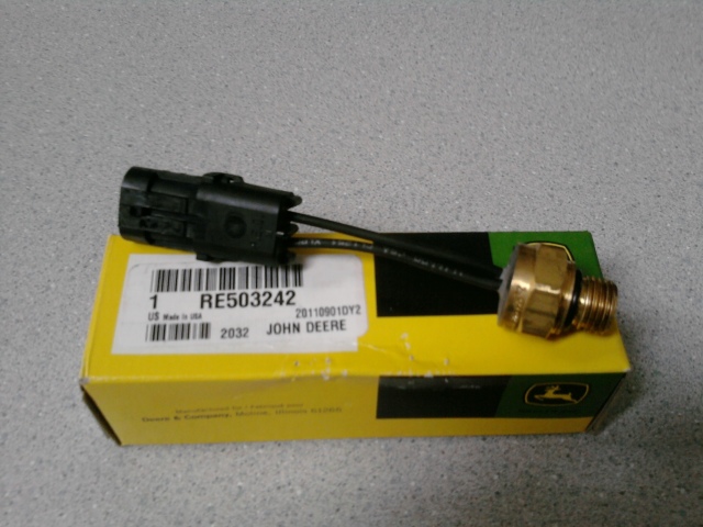

Which fuse are you blowing? I have a include a link to your operators manual.
If it is "26-Fuse F18, 10-Amp: Fuel Shut Off Solenoid, HVAC Relay, Elx Relay, Seat Switch, and Wheel Speed Sensor ", I believe the problem is the thermistor sensor (thermistors are temperature variable resistors used as sensors.). On the thermostat housing there is a sensor that is connected to a two wire harness that goes to the injection pump; this is the "cold start advance" portion of the system so it starts easier when cold by advancing the timing.
When the sensor on the thermostat housing fails it shorts out and blows the fuse. Try unplugging it, replace fuse and see if it starts and runs. The part # is RE503242, if you are quick changing it, you don't have to drain the coolant, just make sure it's not hot at the time. You will want a pan under the tractor to catch the coolant, so as not too have to clean it up.

You can disconnect the CSA & it will still start . It has been a big problem with the 5000 series, including mine.

What if you’re having this exact problem with the same fuse being blown but the CSA (cold start advance) is not the problem. I’m having the same issue and I’ve unplugged the CSA but still having the F1 key switch fuse being blown as soon as the key is turned on.

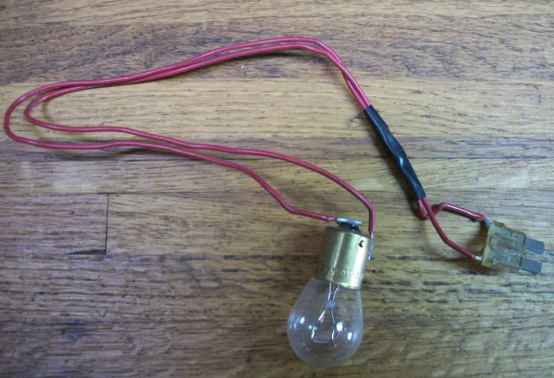

4320 blows fuse when you turn on ignition switch . lights & acc work with switch off . Have changed ign switch and have disconnected thermostat sensor . still blows. I was just taking tractor to shed when it just died . Any advise besides thaking it to jd dealer and paying $159 / hr ?
/ John Deere 5525 electrical problem #10
Welcome to TBN
Put a light bulb in place of the fuse that blows. Then look for what is shorted out. When the bulb goes out, you have found the problem.

yes .. well I've been using a cicuit breaker mini fuse instead & it resets after it clicks . It seems odd the it would be a wire short . After reading of sensors shorting out . It would be great if i could get the schroud off around the seering column .

I had this exact same issue last week on my 5083e, and it was the cold start sensor. Unplugged it, and it fired right up and ran fine. Went to the dealer and got the sensor, and he said he had sold 3 of those the day I was there. Talked to the service manager and he said most people just unplug it and leave it, as it seldom gets cold enough to need it here.
