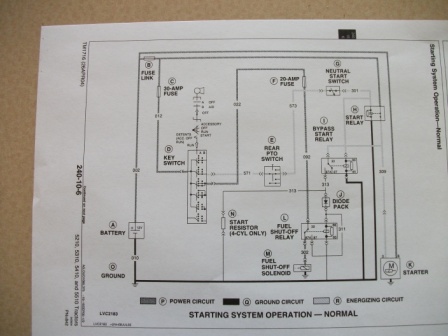

I have a 2000 model John Deere 5310 that when you try to start it, it will turn over, but the fuel shut off solenoid does not open, therefore not allowing fuel to start it. You can run a jump wire from the battery positive to the top of the fuel shut off solenoid, and it will crank. All fuses have been checked. What is keeping the fuel shut off solenoid from opening up during normal operation? Any help is appreciated!

I know you said the fuses look could, but could you check them again, namely the fuel solenoid fuse. It is on the top second from the left 20 amp. I have included an online manual. Post back if this is the problem.
If the all the fuses look could it could be a safety switch, the one for the PTO or the neutral switch for the transmission. If you go to JDparts you will find diagrams to help locate the switches.
The problem also could be a bad starter relay or starter bypass relay, both of these are located behind the instrument cluster. Again JDparts will give you a diagram.
I also attached a wiring diagram.
I have also include some other URLs you may find of value.

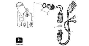

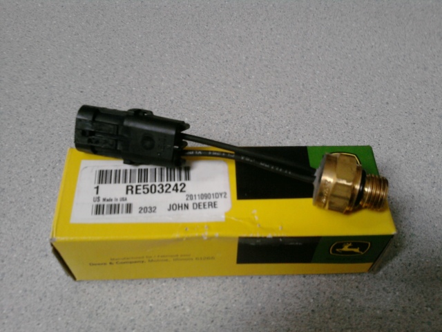

To answer your question on the thermistor sensor (thermistors are temperature variable resistors used as sensors.). On the thermostat housing there is a sensor that is connected to a two wire harness that goes to the injection pump; this is the "cold start advance" portion of the system so it starts easier when cold by advancing the timing.
The part # is RE503242, I attached a few pictures. You can try unplugging, but if your not blowing the fuel solenoid fuse, most likely this is not your problem.
The thermistor plays a different role on the 3029 engines, then it does on other engines. On the 3029 its role is only for the cold start, while on other engines, its role is in opening the fuel solenoid. Once you unplug it you can ohm test it to see, if it is working.

Not the best picture, but here is a picture of what makes up the starting system. The only thing not shown is the thermistor sensor, which I addressed in my previous post.

Here is how I would proceed. I take it you have a volt/ohm meter
I would replace the 20 amp fuel solenoid fuse or at least ohm test it. While I had the fuse out I would see, if I had voltage there, not sure which side comes from the key switch. The key should only have to be in the run position. No voltage on either side the problem is in the switch or the wiring from the switch. The wiring from the switch is 022.
If you take off the left cowling there are 4 little boxes from front to rear they are diode pack, by-pass start relay, fuel shut off relay and accessory relay. I would take off the negative side of the battery, then take out the diode, by-pass and fuel shut off relays clean up the contacts and put them back in.
Still not working pull the fuel shut-off relay and see if you have power on 30 ( you should see 30 on what the relay plugs into) this would be wire 092 from the 20 amp fuse. No power either relay is bad or not getting power. See if you have power on 86, if yes the most likely the fuel shut relay is bad. If you have no power the diode pack of the by-pass relay is problem.
Let me know what you find and we can see about testing if there is power to the by-pass relay. I attached a pdf that may help.

Here is a better picture of the start system and should make my earlier post easier to understand.
