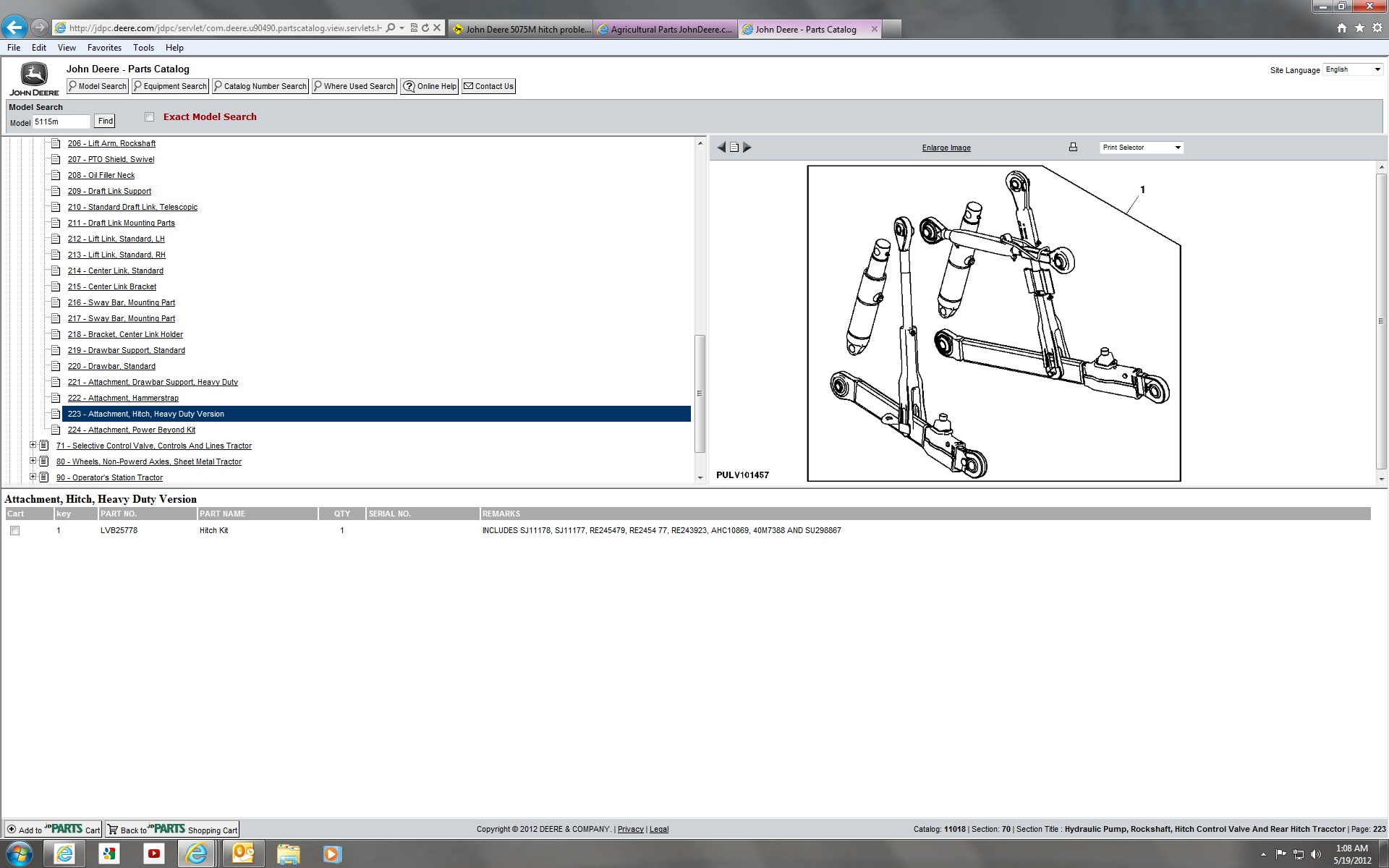

Stumbled upon this today while surfing the net for more information. At least I know Im not crazy....it exists.
Heavy-duty hitch
I found that as well yesterday and sent it to my dealer.
I basically asked him to explain what the difference was between LVB25778 (what is shown in the link above), and option code 8458 (the 63mm cylinders).
Btw, the link to the LVB25778 kit describes the cylinders as being 53mm. Not sure if that is a typo or if option code 8458 includes even larger lift cylinders. I did see the number "63" stamped on one of my cylinders. I'll measure the diameter with a caliber just to make sure what I have.

Im currently browsing the JD parts program. If you search for a 5115M (which is the new top-of-the-range 5M, under the hitch section it lists "Draft Link, Standard, Telescopic" and shows a picture of exactly that; the standard duty draft links....the exact same ones that are currently on my tractor down to the same individual part numbers.
At least in the MY 2011 and previous, if you bought a 5105M (now 5115M) you got the HD draft links (with lift-type telescopic locks) as STANDARD equipment. Apparently, the MY2012 range doesnt offer the HD set as standard. Its shown as an attachment or option. See attached picture.
Like someone else previously said, they scratched off the "Standard Duty" markings, and over-stamped them with "Heavy Duty".....wait you see isnt exactly what you get.
I checked the next tractor down MY2012 5100M and under the hitch section, the HD kit appears as listed....the pictures match the HD kit I am currently requesting from Deere...right down to the pull-up type telescopic locking system.....
This just gets more weird by the minute.....
