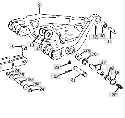

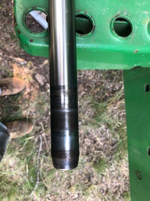

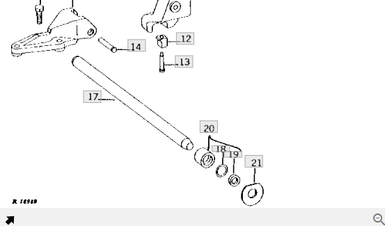

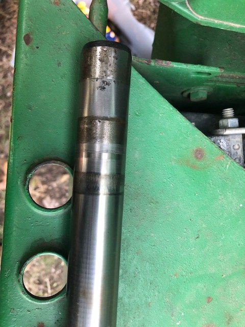

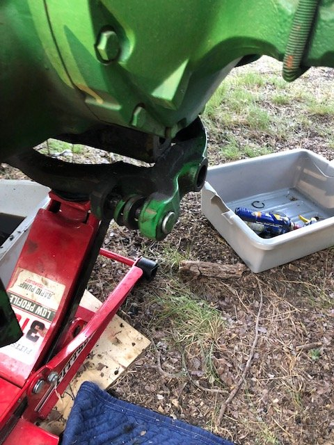

Hello all, i have a JD 4430 that is leaking hydraulic fluid around the load control shaft. I removed the load control shaft, pictures attached. I am guessing that i need to buy a new shaft because of the ridges on the old shaft. The ridges are not deep, but may be enough to cause a leak. I am thinking that i will just replace the seals # 18, and #19 and not replacing the bushing #20. the bushing looks tight in the transmission housing. I really don't want to try to drive out bushing #20. what do you think?
also, is it critical to replace the #15 bushing, and #16 snap ring on the yoke #9? there is quite a lot of play between the load shaft/pin and the bearing in the yoke.

I agree shaft appears worn enough to require replacement. I was taught when i served as a JD dealer service manager to replace L/D shaft bushings only if showing some significant wear. Do you pull heavy 3 pt hitch loads? If not I personally would not replace frt bushing/pin(items 10 & 11).

L/D=load & depth. L/D bushinngs are item 20 in the 1st parts diagram you posted. Item 15 & 16 are bushing & bushing retaining snap ring that is located in drawbar support that load & depth shaft fit in. I don't remember ever seeing enough wear to replace them but check for excessive wear before reassembly

I agree with TxJim, do not to replace the bushings (key 20) in the transmission case. R&R of these bushings can cause the transmission case to be damaged = more expensive problem.

I received my load shaft, load shaft seals, and o-rings. i heated the shaft seals in hot water before I installed the seals. heating the seals made installation fairly easy. with the load shaft oiled, the installation of the shaft was easy too. thanks for all the help.
