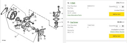

/ John Deere 430 Overheats
Where are you getting your prices? I'm looking at $34 for a tiny thermostat and gasket right now. If you found the belts that cheap, maybe you know someone who sells thermostats, too.
I got my belt, and I just tried to install it. It looks like you have to remove the driveshaft from the rear of the engine. Someone tell me I'm imagining things. I'm going to look at the service manual, but that hasn't been helpful so far. When I looked for info on the thermostat, the service manual said "see operator manual," and the operator manual doesn't contain the information.
I found the instructions for changing the belt. Here they are: "remove fan/alternator belt." The alternator belt is not the fan belt, so that's a little odd.
This tractor is really badly engineered for people who work on it, but surely they don't expect me to remove the driveshaft in order to replace a belt. No one could be that stupid. I mean, okay, they did put the hex for the lever that controls the speed range in a place where it is literally impossible to move it more than 1/8 turn at a time, but surely everything can't be that hard to work on.

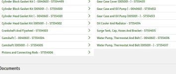

/ John Deere 430 Overheats #9
Through my John Deere dealer, via the jdparts site.
John Deere Parts Catalog
s/n above 5001 shows. Maybe that stands for 50,010 break point at 1989 year.
