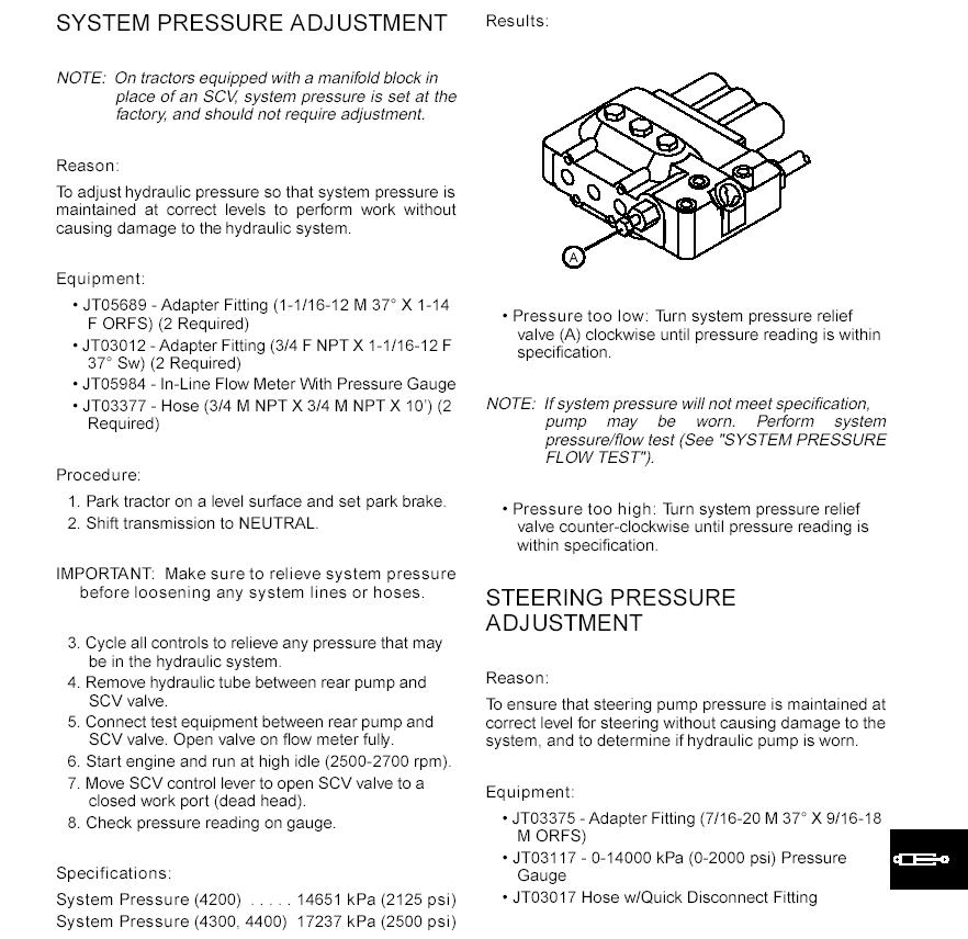

:thumbsup:My problem is solved (for now)
I rechecked the suction lines and all were in good shape with no problems found. I started tractor still no action from loader.
I checked the pressure using a setup described by KENNYD ( gauge found at harbor freight 12 bucks, hose with male QD from my log splitter and 1/2 too 1/4 bushing from hardware store) max pressure at all QDs approx 105 psi.
I then pulled off the R fender to inspect SCV. All linkage connected and properly adjusted.
I removed the only relief valve I could find. A non adjustable relief threaded into the SCV. I found no junk in the valve but I operated the valve by forcing open the relief piston with a 3/16" pin punch followed by a solvent cleaning.
After reinstalling the relief valve I rechecked the system pressure and found it to be 2050 psi. I reconnected the loader QDs and the loader worked like brand new!
I would like to thank everyone for your help in solving this mystery and saving me $$$$ I hope this thread will be of help to others with simular symptoms.

/ John Deere 4200 loader slow #29
I poked around in the CD for this Deere, and found there is an adjustable valve on the SCV block (am thinking this is the one the OP found to be sticking) and have two pics showing it here. A third pic shows the placement of the two Forward/Reverse valves mentioned by Egon that are only for the tranny, not the hydraulics as being discussed (just for clarity here :) )

#33
Just to clearify things I used a 0-3000 gauge and my readings were taken at the lift and curl quick disconnect fittings.
The pressure I found at these fittings was 105 psi ( the gauge needle was slightly over the 100 mark) while the control lever was accuated and dropped to 0 psi when the lever was in its neutral position.
The relief valve I played with is threaded into the loader control valve body and looks like the one in the picture that Super member Beenthere posted with the exception that the one I found is is non-adjustable.
I did not run the tractor with the the fender remove to gain access the the control valve so I don't no if it was generating any heat, although it makes since that it was.
After accuating, cleaning and reinstalling the relief valve my pressure at these fittings was 2050 PSI
Yes the 3 point hitch did operate properly thru out all of my testing.
Once again, I thank you guys for your help!
Dan :D
/ John Deere 4200 loader slow #34
Just some casual observations. The gage should have been in the pressure hose from the pump. Even if the relief valve was stuck fully open, the gage should have read relief pressure when the levers were actuated. The 3 pt with no load only takes about 100 to 200 psi to operate. In order to build up pressure, there should be something in the fluid path to offer resistance.
