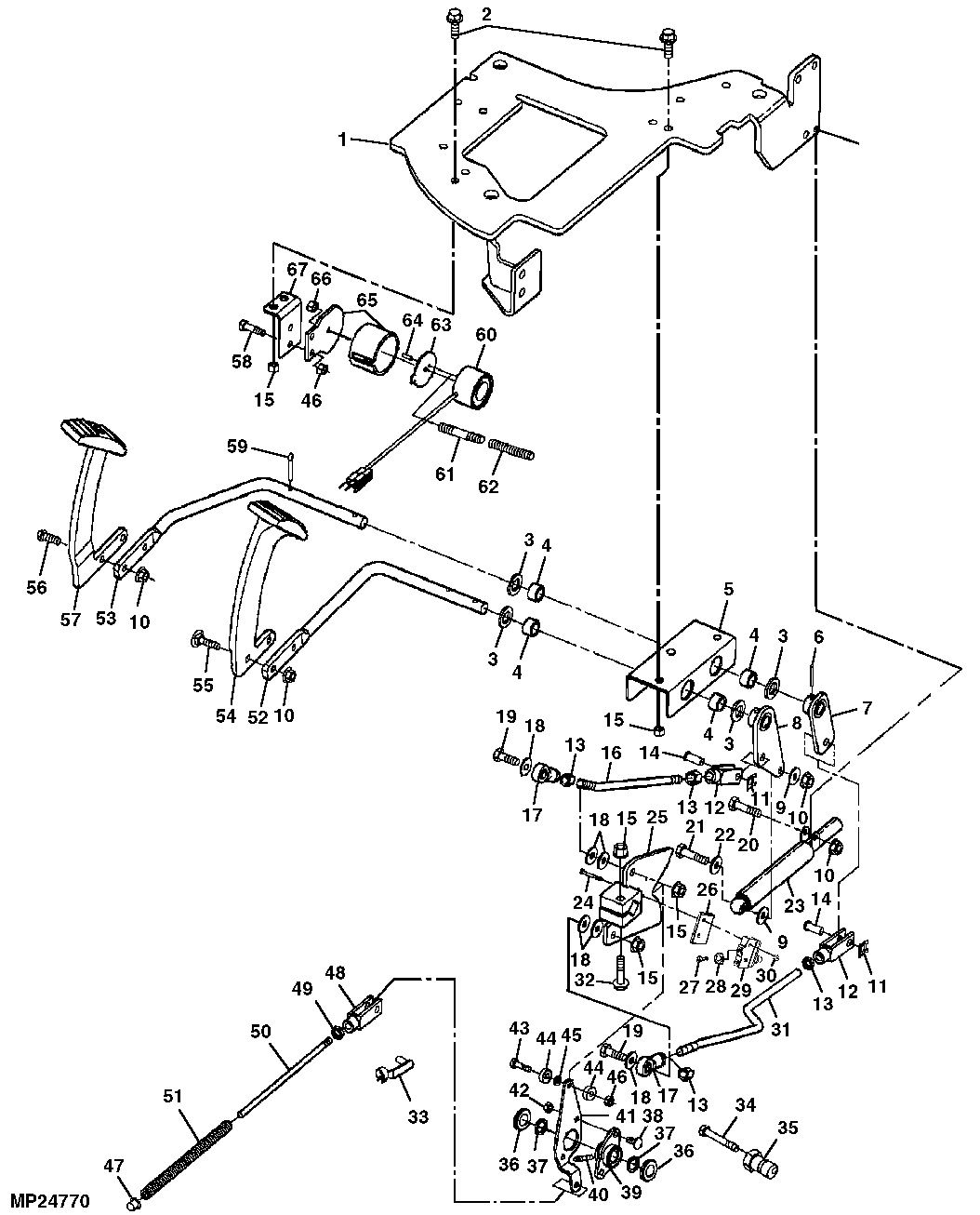

I have a JD 4200 and the forward and reverse pedals stick. You can push down on them and take your foot off and they will stay down. Only way to stop the tractor is push the other pedal. My foot is big enough that I have just been covering both pedals but my neighbor almost crashed my tractor into my Jeep so I think it is time to fix it.
I have put grease on the parts that come up through the floor board but that didn't help. Is there some other simple thing that I should look for that would fix this problem?

If you look at the attached parts layout, you will see there are lots of pivot points that need to be checked and lubricated, as well as the shaft/spring combo (#50 and #51) that is for returning the pedals to neutral.

I think there's also a spring to return the pedals to neutral make sure it's not broken. There's a grease fitting up in there somewhere also however all the pivot points don't have fittings. When I grease mine I also squirt a little oil or wd-40 on the pivot points that don't have fittings. Don't use too much or it may attract dirt and cause the same problem. A dry lube would probably be best.

take a can of fluid film and kennyd's diagram
and get under the tractor and lube any place that the
shaft pivots, bushings etc. then, work those pedals,
over and over and over, spray again, and then , work them some more.
back and forth.
that's all mechanical linkage there, no electronics like the 10 or 20 series,
and once you get things freed up you should be fine.
it would be a good idea to hit the shafts under the seat where
the rockshaft control is, and also transmission range selector shaft,
along with any brake linkages.. sometimes the brakes will start to sieze
up also because the shafts etc are drying out.

check out #23 on the diagram. is that a hydraulic cylinder (think tailgate lift cylinder on an suv) like is on the 41xx series? i know mine sticks sometimes when it is cold because that little cylinder is cold. once the trans warms up all is well. it seems to be getting worse with age. if you have this cylinder i wonder if it might have leaked and de-pressurized?

I just checked my shop manual for the 4200 - 4400 series, and the part Rocco refers to is listed as a shaft, nothing more. A couple of these shafts are spring wound, and the shop manual text lists one as the neutral return rod. It's on the right side of the tractor, and I'd guess that may be the culprit.

I just looked at John Deere's parts lookup online and that item #23 is listed as "23 AM127753 TORSIONAL DAMPER" on the parts list. I think there are actually two different diagrams for a change in the 4200/4300 based on serial number. Perhaps your shop manual is the other diagram.
