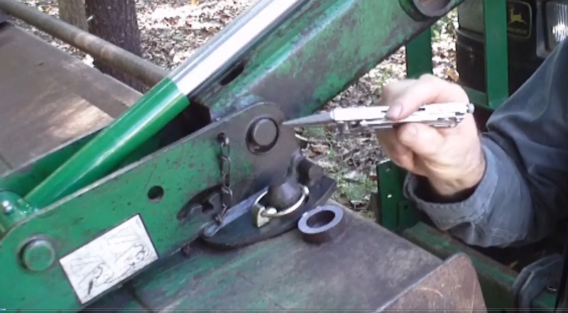

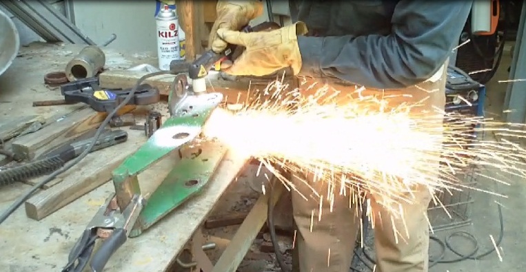

The quick hitch on my John Deere FEL was almost worn out. The lower pin holes had walled out to the point that it was difficult to change attachments without getting off the tractor. I repaired the pin holes by cutting the holes large enough to accept a pin boss made from DOM tubing and welding it in. The DOM tubing provided a nice new 1 inch hole with more wear surface.

I'm not sure which wear spot you are referring to but the only broken/missing keeper pins were on the rod that connects the quick hitch parts. I had replaced the missing keeper pins with bolts. The bolts allowed too much play. I have fixed that problem by drilling out the holes and inserting tight fitting spring pins.
The worn out enlarged holes were caused by bad enginering. The sides without pin bosses enlarged. The sides with pin bosses did not wear out. I covered this all pretty thoroughly in the Youtube video

Yes we are talking about the same pins. I got tired of mine breaking so I drill out the rod and quick hitch and installed the next size larger. I have to agree it is a piss poor design if the rod was a litttle longer they could have put a pin on both sides of the quick hitch or better yet they could have fixed it staight from the factory the same way you fixed yours. Maybe I will have to do mine soon ,they not as worn as your but better to fix it now

I considered the DOM tubing approach for both, but decided to make
the holes smaller by welding. I think your approach should last longer,
but you can not do the DOM method on the locator pins.
