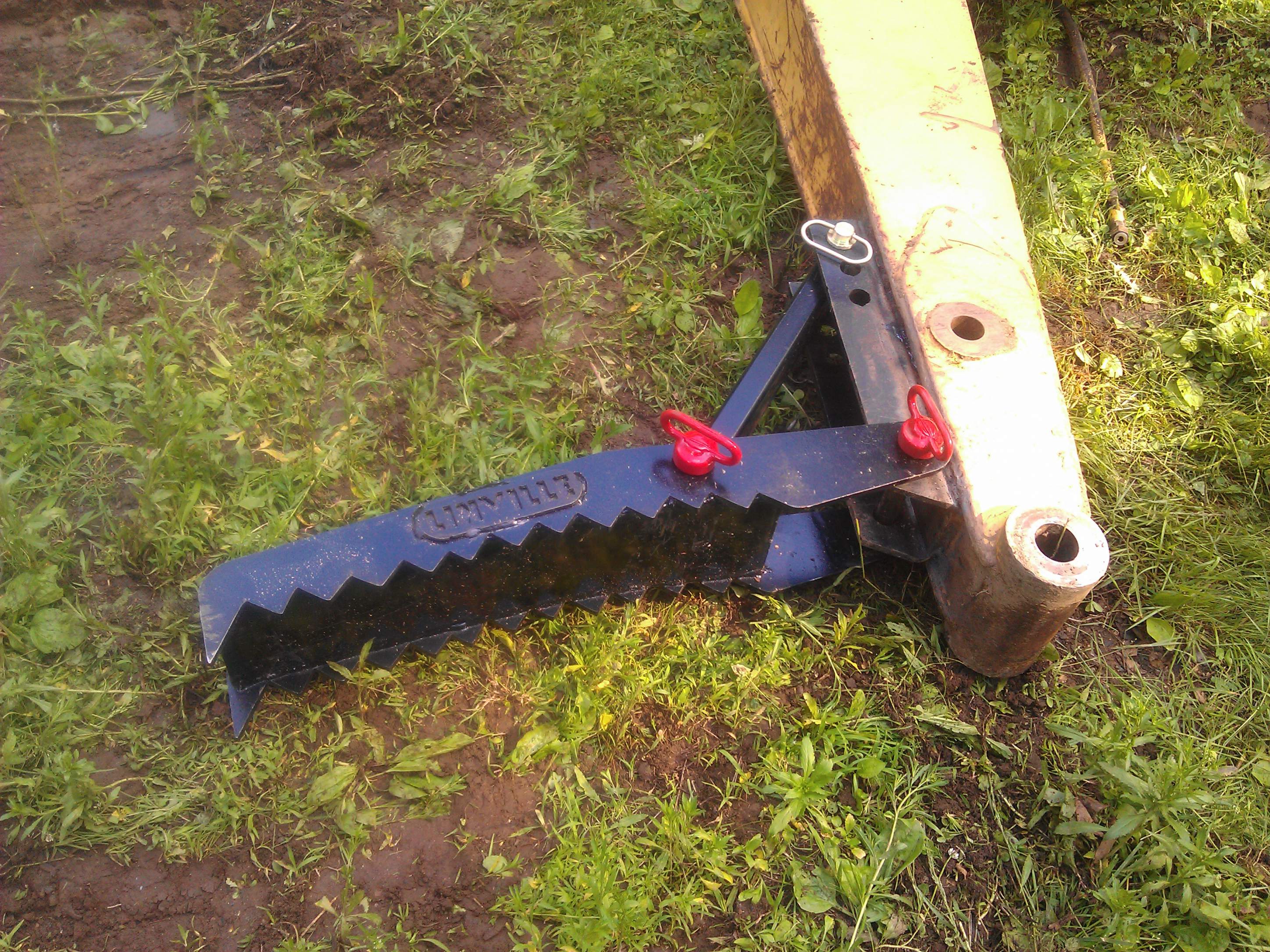

Welded on a 32" Thumb.

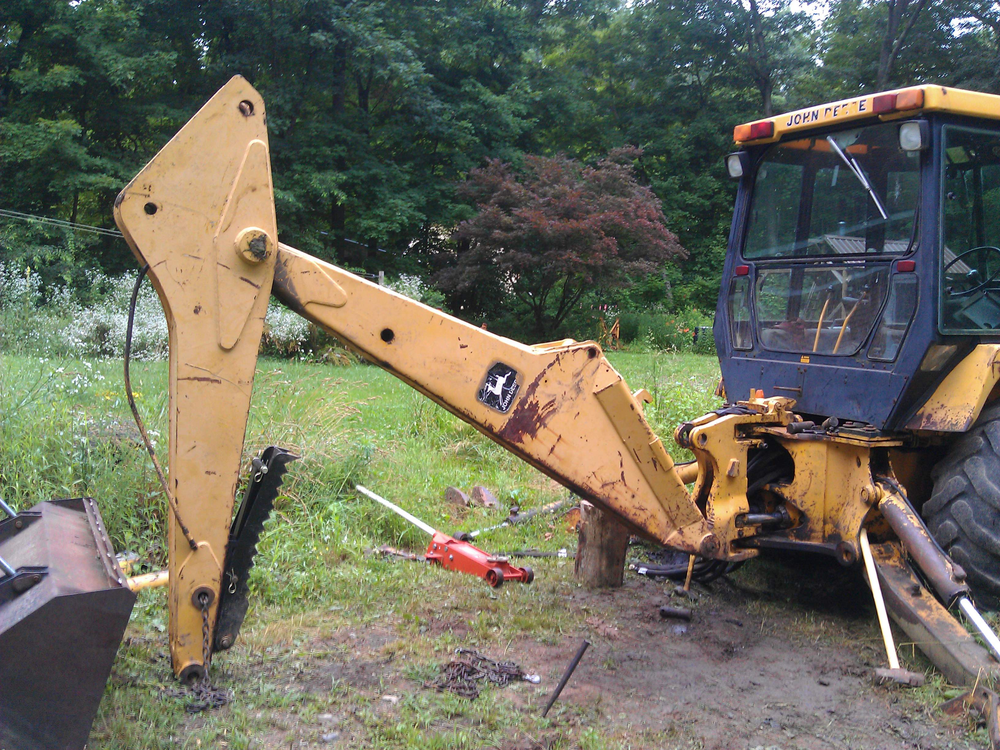

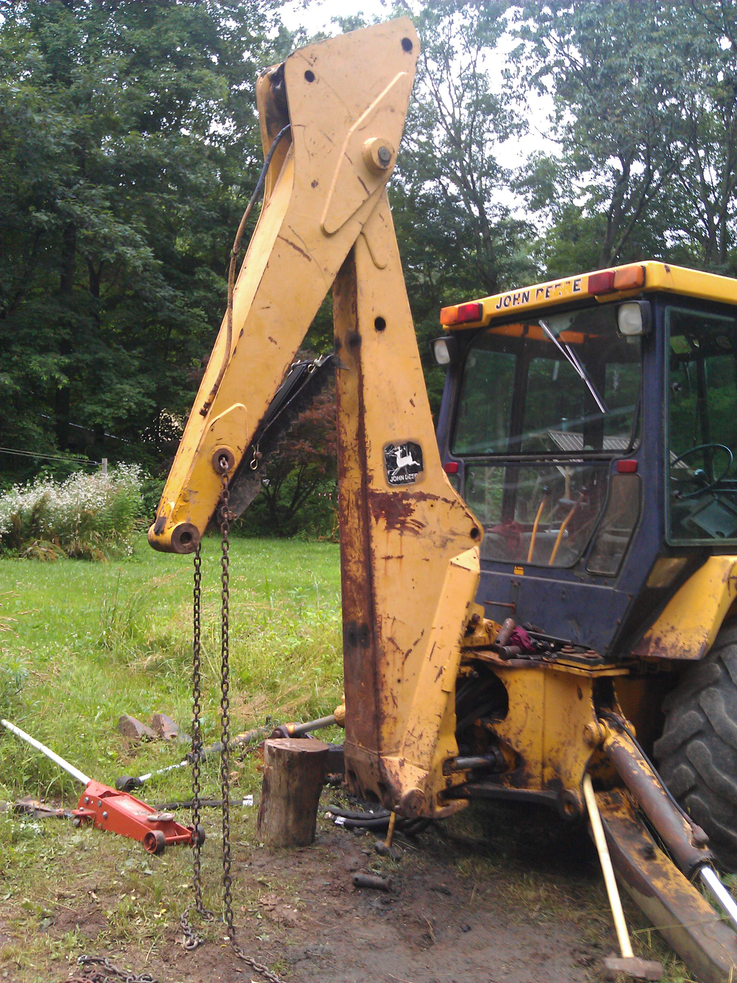

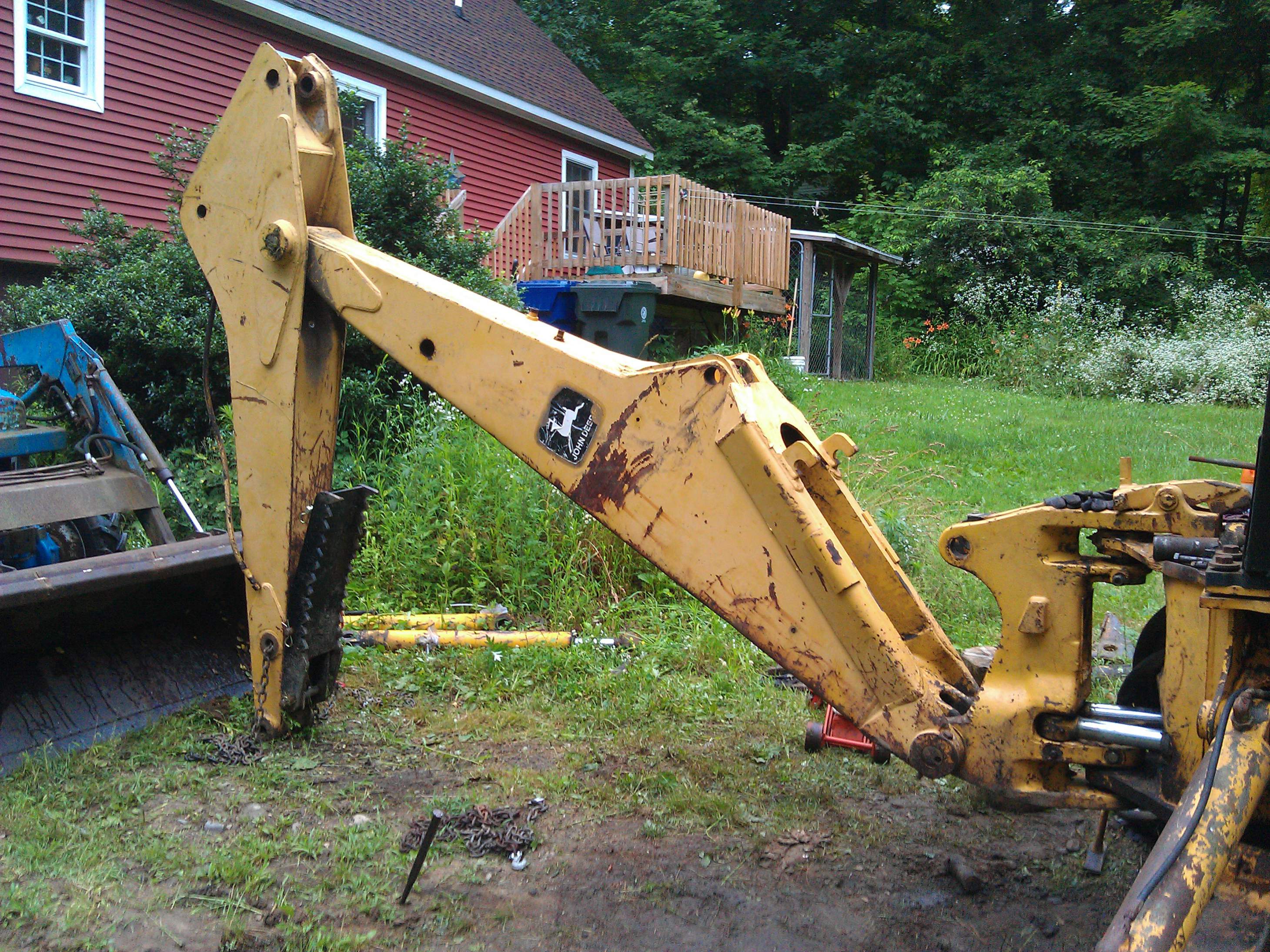

Used my Trusty 1710 to carefully get the new boom, and Dipper Pinned on.

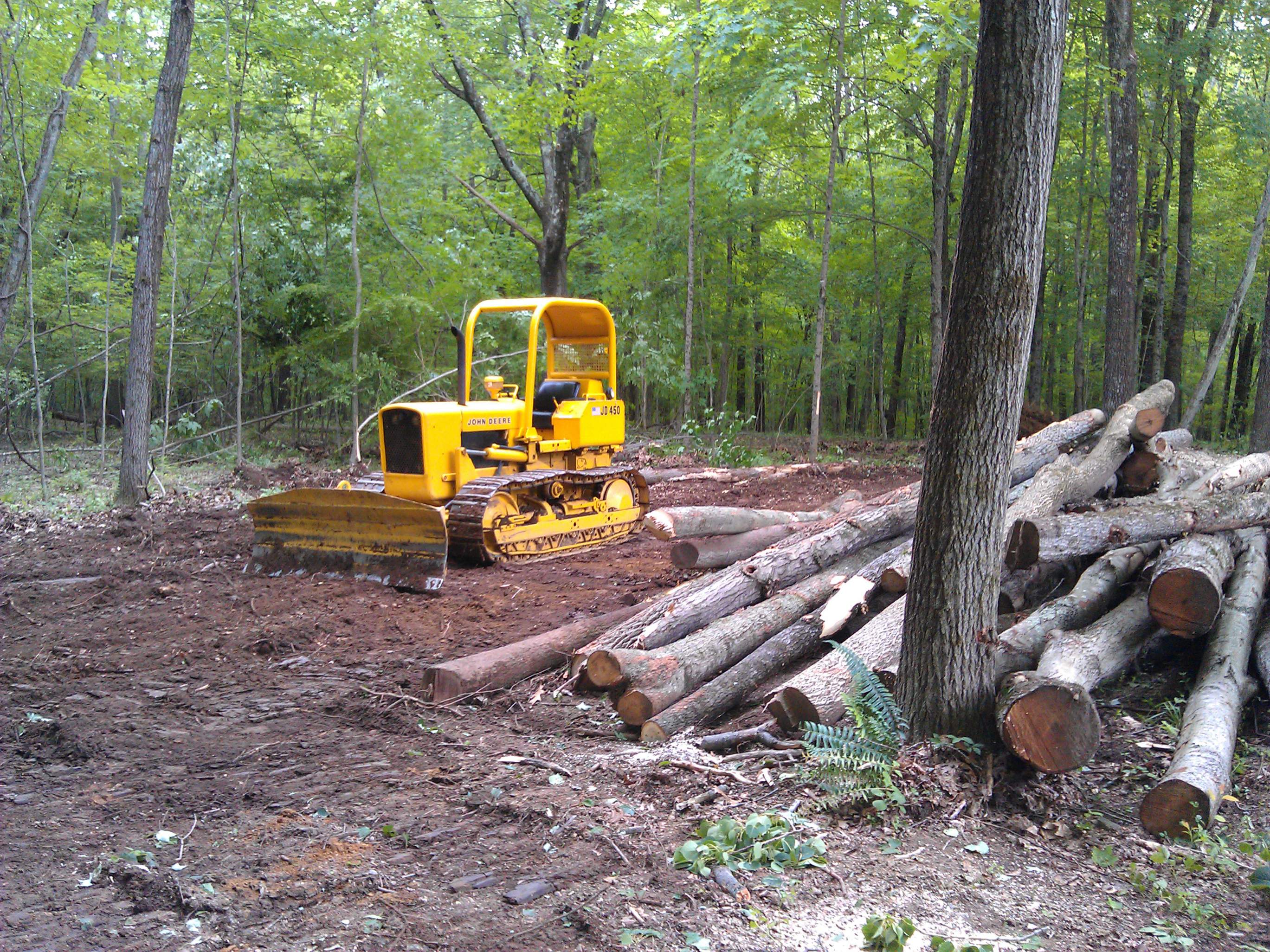

My house project got delayed as did this. But now I'm almost there. Tree work on my property is done with about 2 1/2 acres clear cut. Just finishing up this Hoe so I can get out there and rip my stumps out..

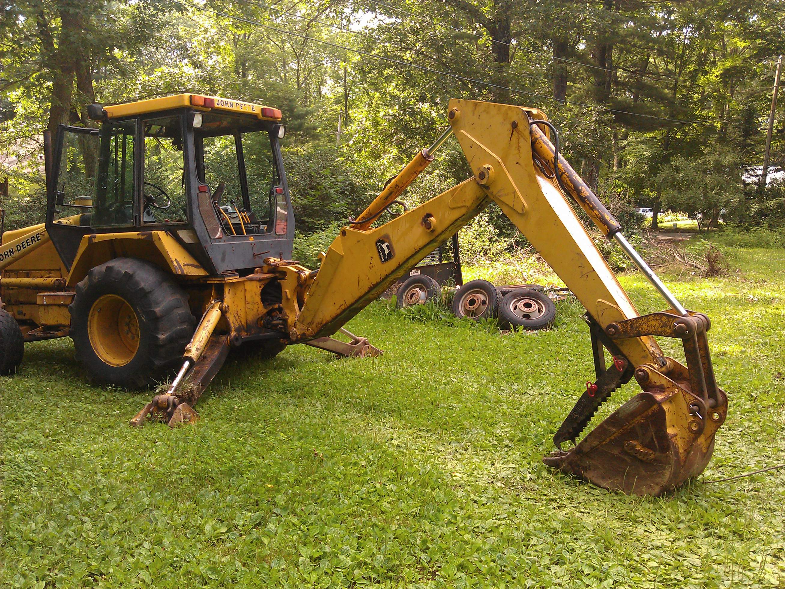

All back together and working nicely! A little slop, but definitly homeowner worthy. The swing to boom pins still need to be replaced, that should tighten it up a bit.
