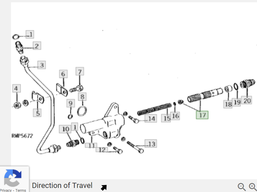

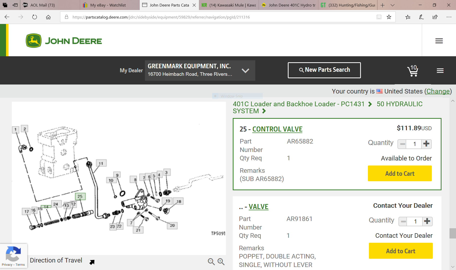

What parts do you need for it? Looking an JD parts, parts appear to be available, most are O-rings, fittings, the internal valve and spring are available. If the housing is OK, you should be able to get any internal part. The housing is BIG money, but available too. $1625
Can anyone tell me what #5 (dowel pin) is for? There isn't one in mine. I was able to find the parts through another JD dealer. Waiting for calls on used/new parts in the meantime.
   / John Deere 401C Hydro trouble #56
The AG version does not have the pin key 5. It also does not have the cap at the rear key 17. So my guess is the pin is to prevent the internal parts from coming out the front/forward end of the housing, if the fitting for the hydraulic line is removed. Key numbers are for 401c PVC First drawing. Second drawing is for JD 2030 AG tractor PCV

   / John Deere 401C Hydro trouble #57
That makes sense on the different housings usage but I can't find where the dowel pin is inserted. I gather you don't have a FEL on your 2030.
   / John Deere 401C Hydro trouble #58
85bj60;5866816 I gather you don't have a FEL on your 2030.[/QUOTE said:
IIRC Z5's 2030 has a FEL. But whether Z5's 2030 has loader installed or not has no bearing on pressure control valve configuration & related parts or not. All 2030's came from factory with pressure control valve & no FEL attached. Also ag tractors were manufactured with some different parts than industrial tractors.
   / John Deere 401C Hydro trouble #59
My 2030 has JD 245 loader, see my signature. Pressure is connected by a tee after (behind) the PCV. Return is to a ported transmission filter housing.
   / John Deere 401C Hydro trouble #60
Total blindness on my part :confused 3: So a PCV of a 2030 or among others can be fitted on a 401C if I'm reading this correctly. This would greatly increase the odds of finding a used one or a cheaper new one. Also thanks to Zebrafive!
