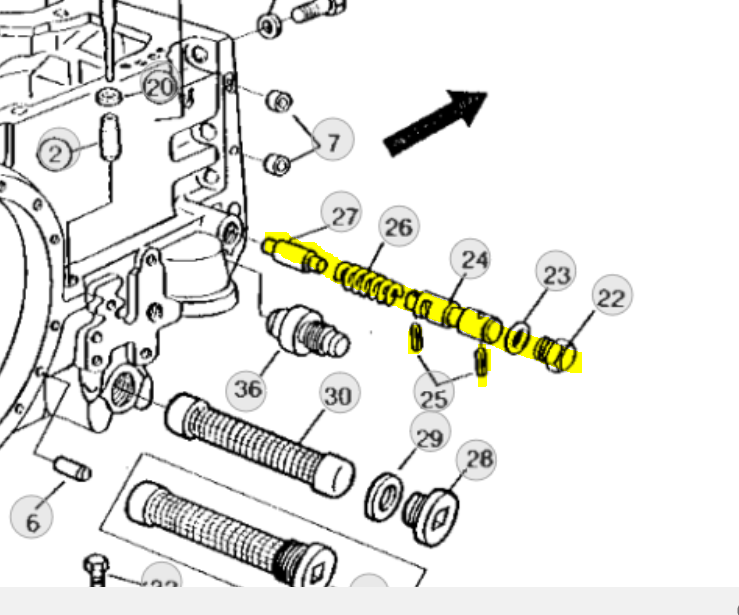

I didn't test the flow from the transmission pump as time was against me as Fall as arrived and will be cold soon. How does the pressure relief valve come out? You would figure it to be somewhat under spring pressure as the cap is tightened but it's not the case here! Can it be seized in the housing?
I am not familiar with the Industrial Deeres, on the AG version a sleeve comes out with a spool and spring inside between two roll pins. Parts drawing show an exploded view. Drawing is 2030AG, NOT yours

My pressure relief valve is in the exact spot on the transmission as shown in your pic. It should be loose in there or am I overlooking on how it comes out? I do see the rolled pins inside, are they there to hold the assembly together as one part?

Yes, it should be loose enough to slide right out. The roll pins hold internal parts (spring and spool) in body (at least that's how AG tractors are. Over pressure causes the spool to compress the spring and open a passage back to sump.

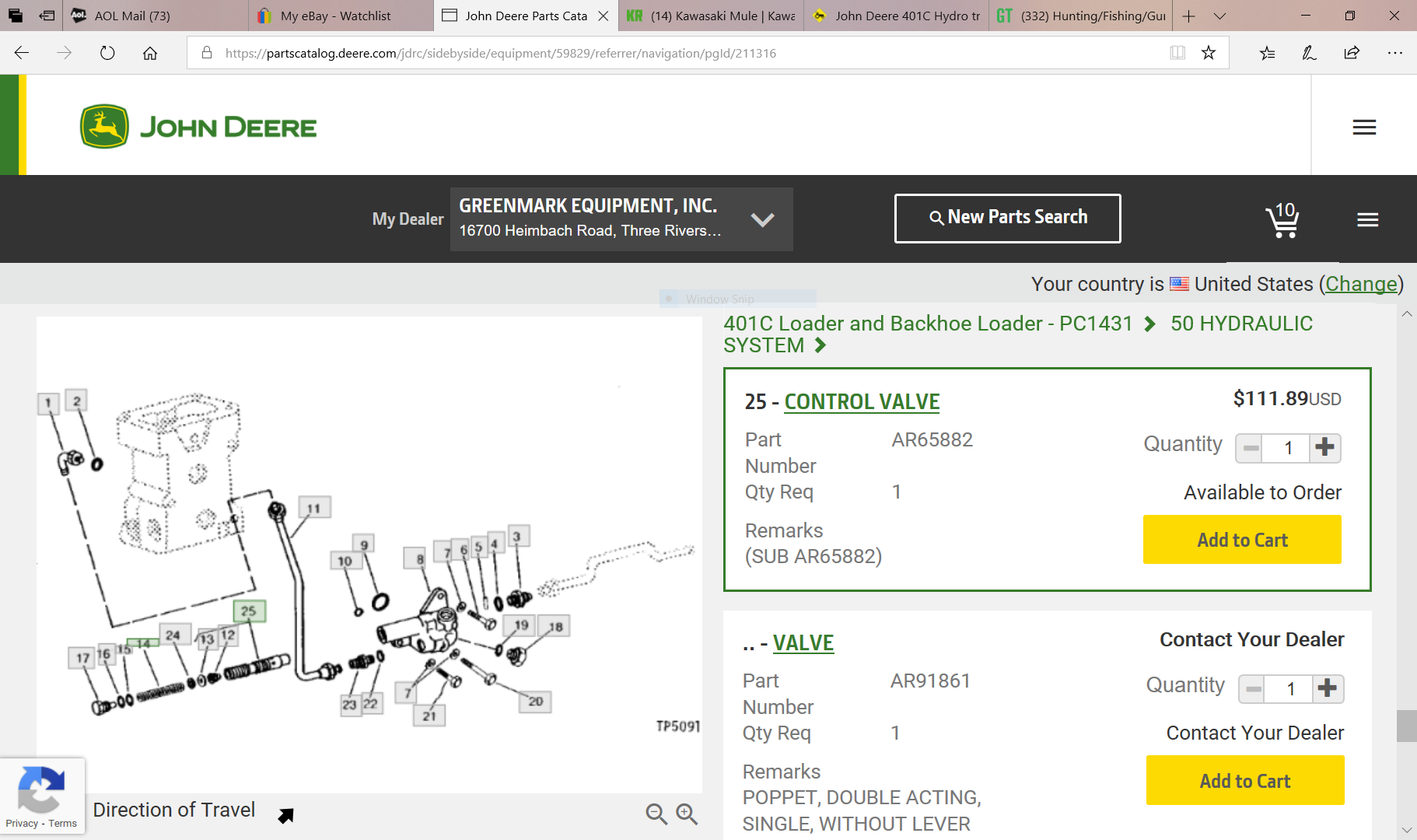

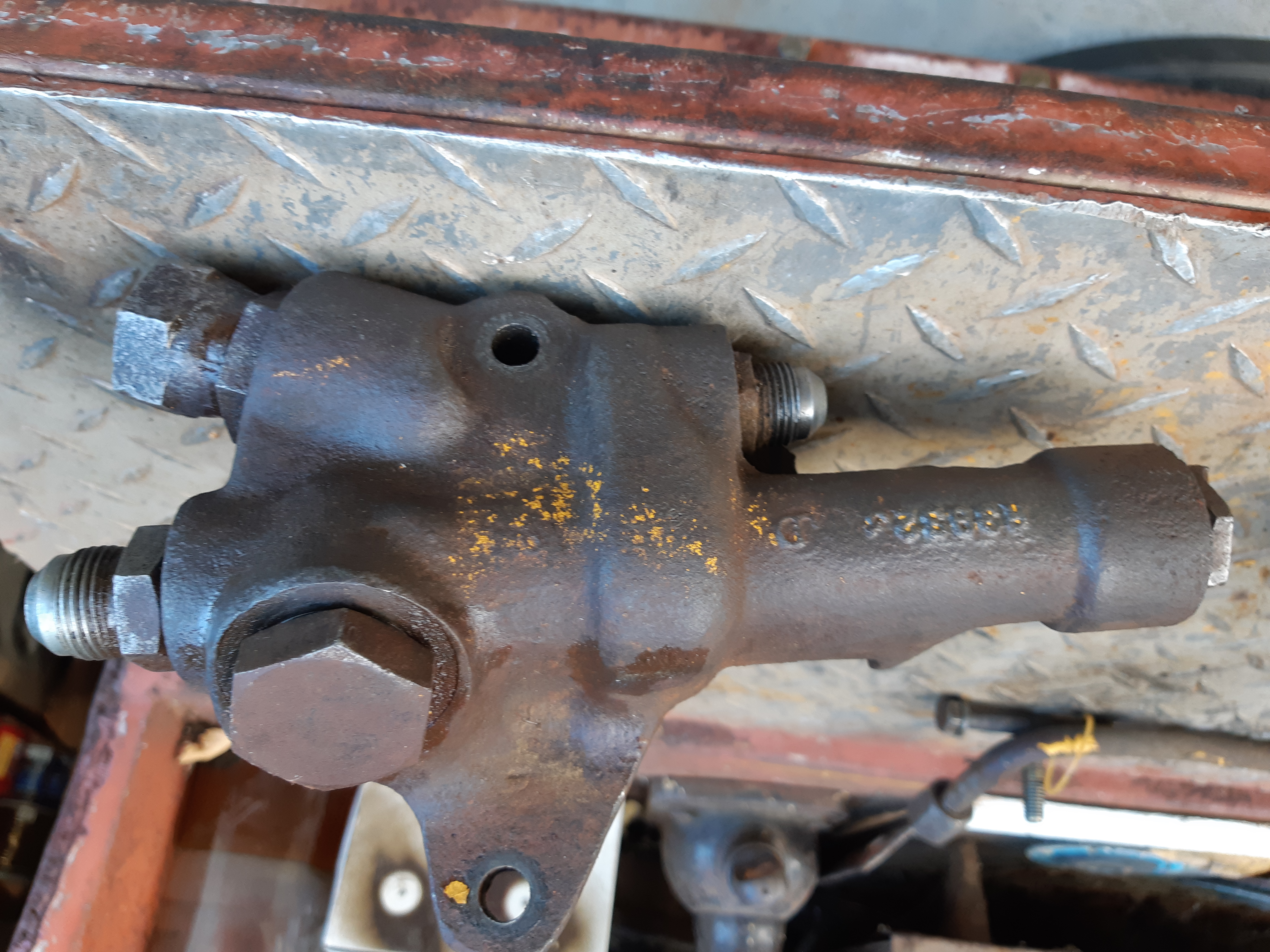

I pinpoint the culprit of my FEL and steering woes on the Pressure Control Valve. Local dealer is unable to get one or kit and says they're discountinued. Any other source to find one. What's the correct part #? I could fabricate another style into the system by blocking off the transmission two holes with a plate and maybe using one hole for return of over pressure.https://www.tractorbynet.com/forums/asset.php?fid=584263&uid=344904&d=1603539926
What parts do you need for it? Looking an JD parts, parts appear to be available, most are O-rings, fittings, the internal valve and spring are available. If the housing is OK, you should be able to get any internal part. The housing is BIG money, but available too. $1625
