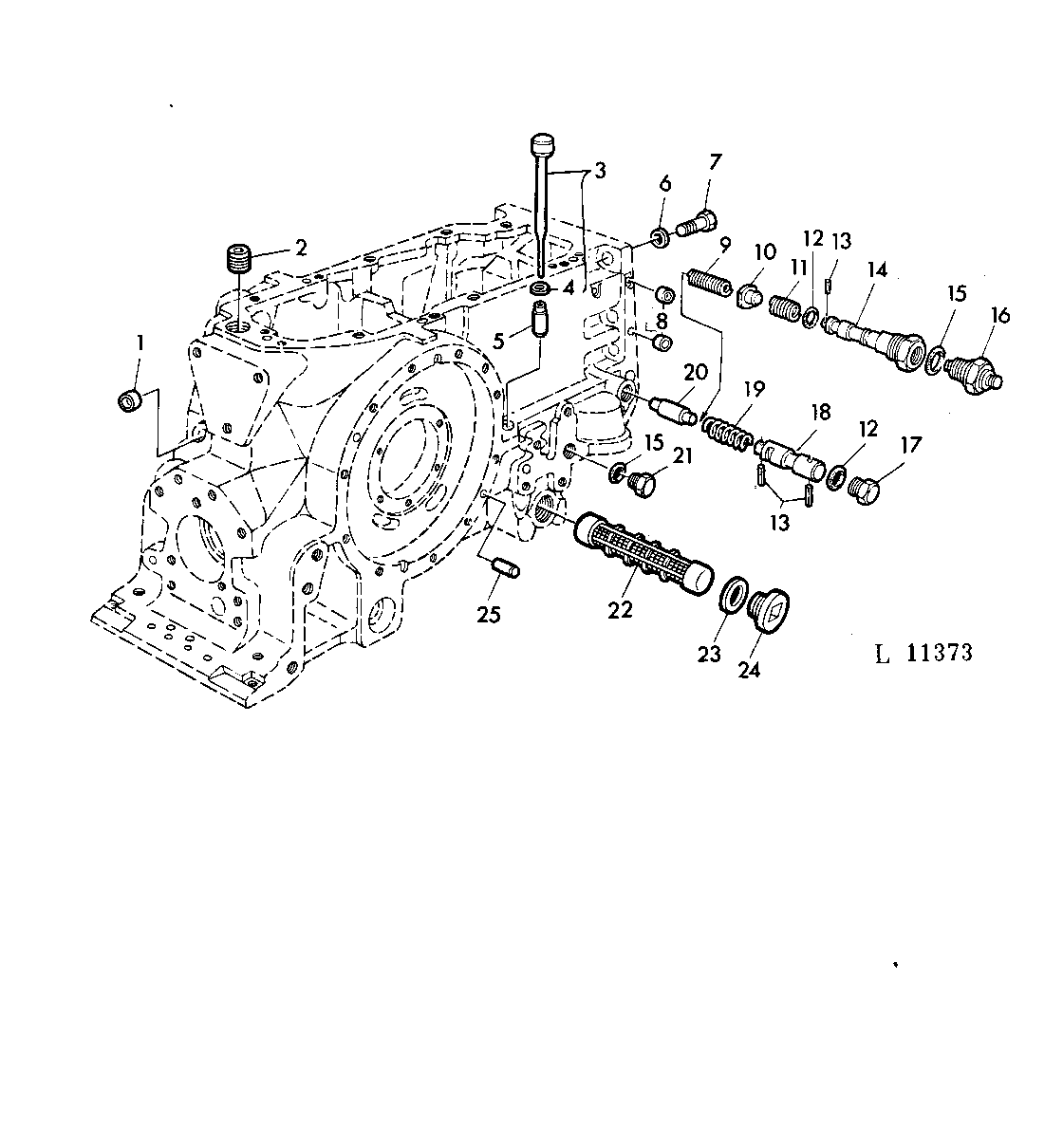

I recently got a 401C industrial tractor it has front loader 3poit hitch live pto and shuttle shift unsure of year but serial # tag is 401cd. Ran fine for a few days moved about 60 tons of dirt before it started to shutter and lift slow. I have read on here that it has a sump screen I can not seem to locate it. do they all have this ? Have replaced both filters and didn't change operation. any help would be grate. Cant seem to locate anyone here that knows anything about the rig.
/ John Deere 401C Hydro trouble #2
Here ya go parts key # 22 is the screen but I think on an industrial tractor one needs to remove a fitting & hose to access the screen.

Thanks I will look again tomorrow. Is their anything else that would cause tis problem?
/ John Deere 401C Hydro trouble #4
Several things can cause hyd failure including internal leaks & debris stuck in stroke-control valve among other things. Pump Coupler drive could be slipping on pump shaft.

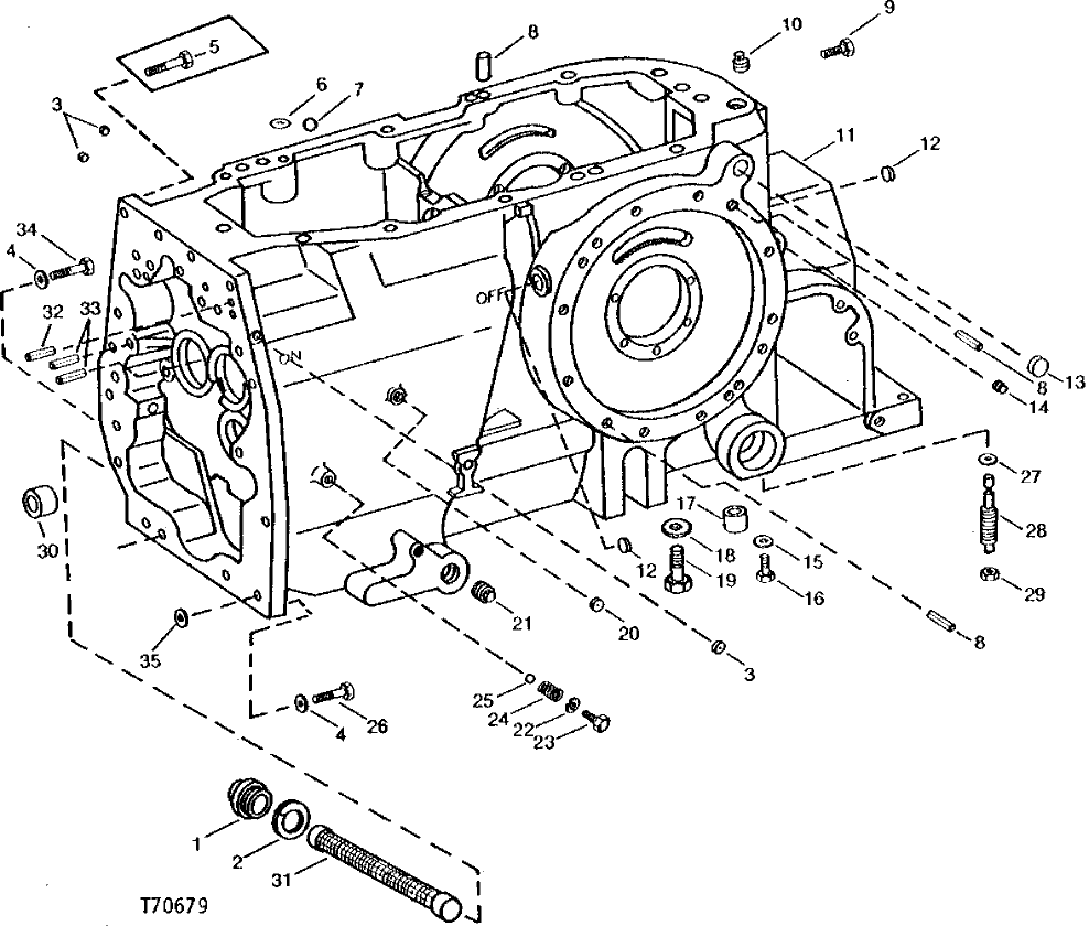

still cant locate the sump screen we even pulled the priority valve off to make sure it was not behind it nothing their will try to take some picks of it
/ John Deere 401C Hydro trouble #10
Remove cap(parts key #1) to access screen. Sometimes there's a fitting with a hose in place of the cap.

Their is a fitting that supplies the filter housing it has about 1.25 " house with clamps on it. To remove it looks like the filter housing will have to be removed. It is in the right area. Will pull it off Monday and look their . Sure hope this is the problem. We have not checked the with the tractor running it dose show full while off will try that also

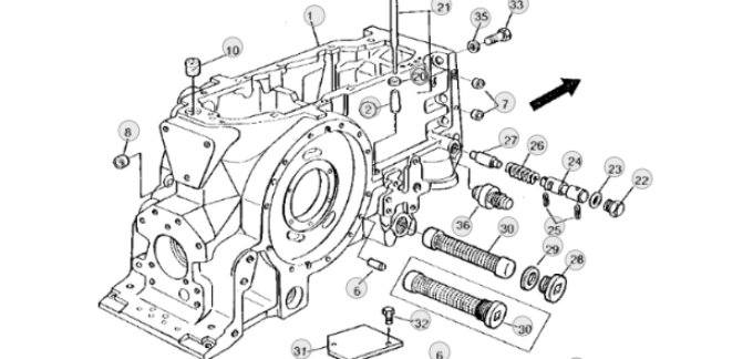

Hyd filter relief valve is keys 24-27

Ok, now I see what you're talking about, I just remove and clean it?

R39273 is the pressure control(priority) valve(2nd photo) which ISN'T the hyd filter relief valve that I was referring to. I don't locate R39273 in 401C parts catalog. I think industrial tractors have hyd filter relief valve located in the external hyd filter housing BUT due to the fact I as employed at at "AG only JD dealership" my knowledge of JD ind tractors is very limited.
