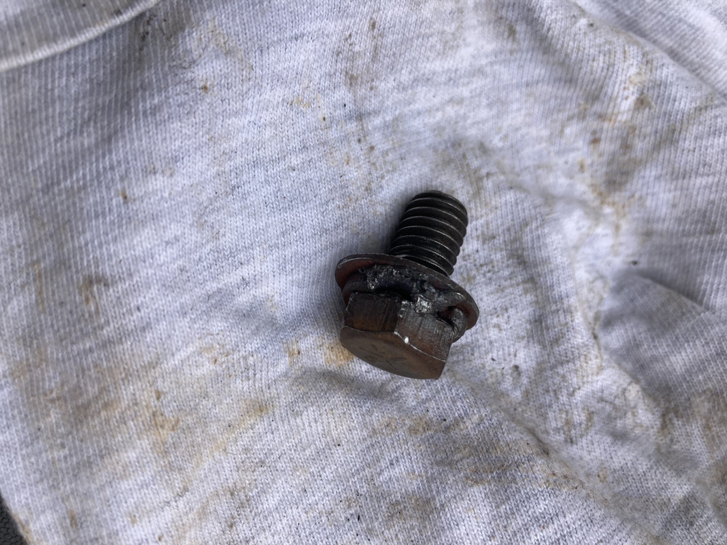

Had the same symptoms on a Mahindra. Bad ground. Take the ground wire off at the frame and scrape / clean the connection to bare metal.

I did remove and clean both connections, at the battery, the ground to the engine, and the positive to the starter, pretty sure its a loose connection in the dash. The repair guy is here today between 9am and 11am to start fixing it. He also going to do a major? service on the engine and the hydraulic system.
