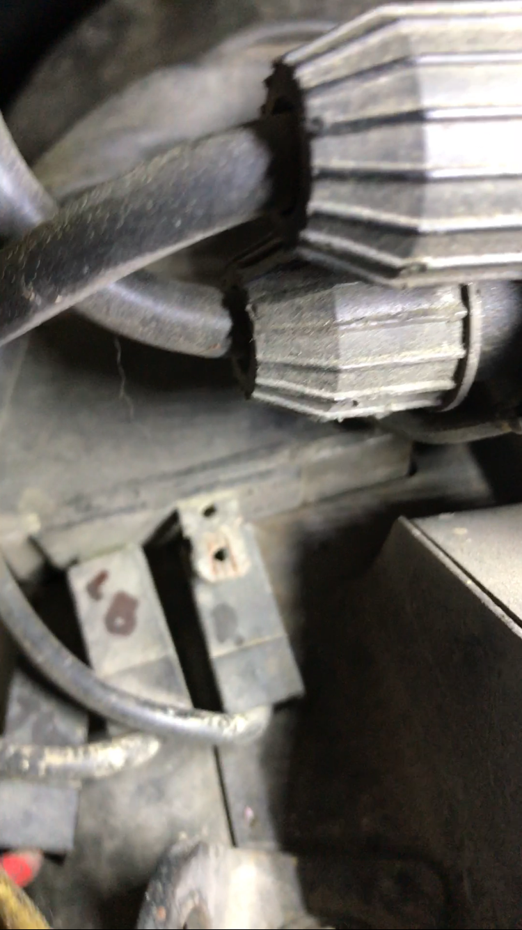

Do you have a pic of the old regulator? Not sure I've seen one different than this type.
I do have a picture, but I can't figure out how to add a photo from my phone. I'd have to wait until I'm at work to use the computer.

#33
It's a bad picture. But those are the connectors. One is undone as I took this picture when I was taking the connections off while doing a valve adjustment.
   / John Deere 318 voltage regulator #34
Great, thanks. I'm getting a multimeter today. So test it before starting, then fire it up and test it at WOT? Or should it be at a different throttle range? I really don't want an explosive issue haha.
For point of info, the voltage mostly stays the same regardless of throttle position. The only time it varies greatly is when a 'load' like headlights are being used and the battery would be 'drawn' down if the voltage regulator didn't compensate for the draw down.
