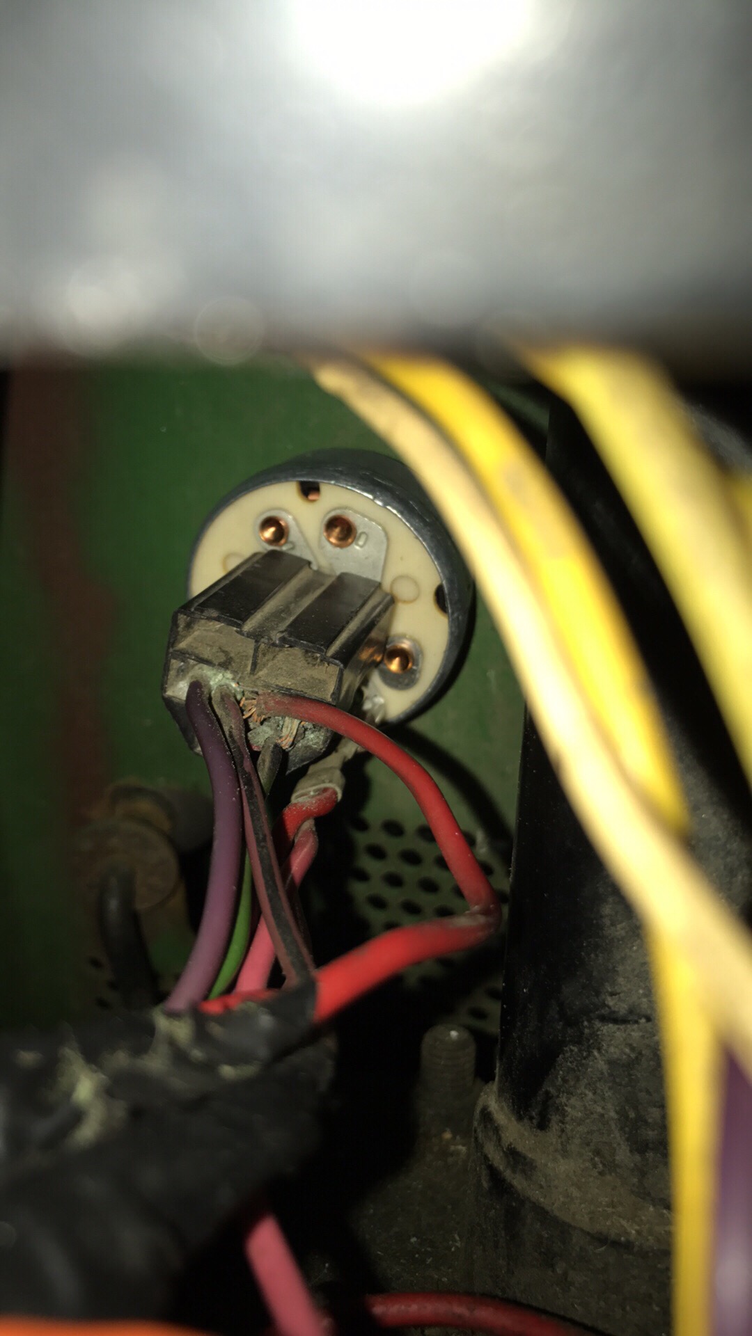

My wires at the ignition switch are frayed. Could that causing the cutting out? I took a picture, but I'm not sure how to add it. And how do I remove the metal plug that's inside of the plastic plug to make a repair. Does that make sense? I don't know how else to describe it. There are two wires that go to a metal looking "spoon" that's inside of the plastic plug. The metal "spoon" is plugged onto the ignition switch.
/ John Deere 318 voltage regulator #10
The fact that you changed the ignition switch and it changed the behavior suggests you could have a loose connection in that area. If it's a standard 5 prong plug then you can replace it with something like this.
Amazon.com : Stens 43-223 Wiring Harness : Lawn Mower Deck Parts : Patio, Lawn & Garden
You'll need a crimper/stripper tool and butt terminals to install it. Disconnect the battery before you start and write down where each wire goes before cutting the old plug off.
This plug doesn't explain the bubbling battery, so like I said you may have a couple things wrong. Listen to Coyote's warning about battery acid vapor.

ignition.JPGI think I figured out how to post the photo. I order the plug you suggested. I'll pick up the other necessary tools today.

First thing you ought to do is put on safety goggles, or at least safety glasses and gloves and carefully remove the negative battery wire connection from the battery and put it aside. THEN, look at how the wires at your ignition switch are laid out. If they are frayed to the point that they can touch together bare wire to bare wire, you could use electrical tape to temporarily tape each frayed wire so it cannot contact any other wire or any metal on the mower.
With a VOM, ( Volt-Ohm-Meter), put the black lead on the negative post of the battery and the red on the positive post. Read Voltage present in the battery, without the engine running. Next, hook up the negative battery wire and start the mower. Now read the voltage. It should be at 13.5-14.5 Volts Maximum. If it reads any higher immediately shut off the mower and re-disconnect the ground wire, (neg) at the battery. At this point, IF the voltage is higher than what I wrote, you have a n overcharging problem, likely caused by a bad voltage regulator. The Voltage regulator is likely a separate box, about the size of a pack of cigarettes, that has wires going to/from the alternator. It could also be part of the alternator, as in a integrated Vreg, but less likely.
Report back the results of the tests I outlined above.
I also suggest keeping the mower outside, away from anything that could catch fire if the battery/ electrical system were to catch fire due to over-voltage being present at the battery. Though unlikely, it's not outside the realm of possibility.
