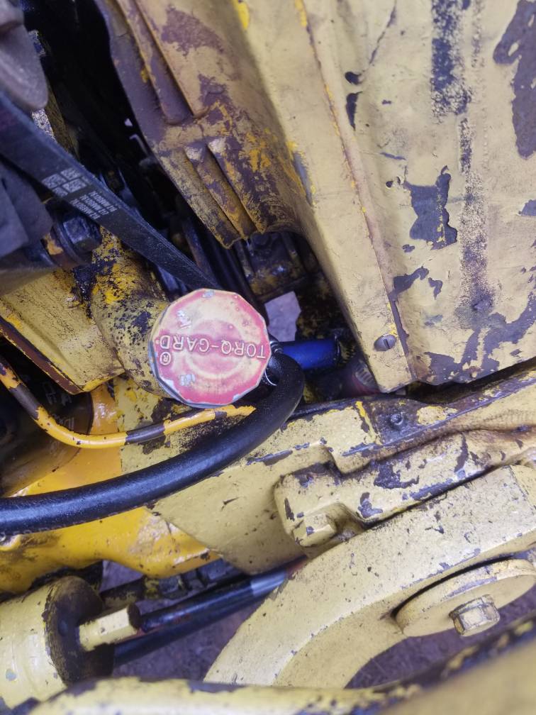

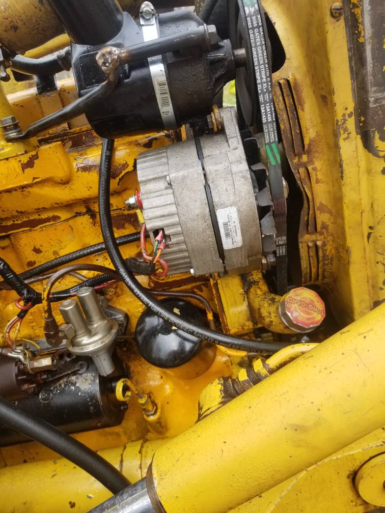

Original open center power steering pump utilized trans case as it's oil reservoir. Can you post photos of how you have the automotive PS pump plumbed to tractor hyd's?
/ John deere 301a power steering pump

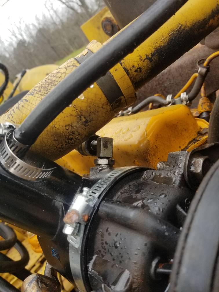

Im using an old ford power steering pump, i had it laying around it, has its own reservior, but pressure side out of pump is hooked to pressure inlet side of steering valve, return side of steering valve is connected to low pressure hydro line, and the supply line close to hydro pump is connected to return side of ps pump, and a bleed line is connected to reservior on ps pump to reservior hydro tank.... essentially the ps stteering pump is connected exactly like oem pump........... lets say someone put the incorrect steering valve in the tractor but would that cause the pressure to build up, forcing hydro fluid out of both power steering pumps? Oem and the ford? Ive replaced seals and bushings twice in oem pump and it worked great until i used the front loader heavily, then fluid would start filling up crankcase.... is there anyway to identify the steering valve as open center or closed center?
/ John deere 301a power steering pump #8
Your tractor must be a model 300 not 301A if it had a PS pump mounted to RH frt of engine. Open center steering valve housing should have casting # T22829. I'm not understanding how you're getting return oil from PS control housing back to Ford PS pump because factory PS valve housing returns oil out the bottom via a galley in clutch housing that connects to trans.
#9
/ John deere 301a power steering pump #10

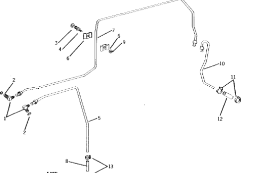

After viewing your photo's I still don't understand how you have Ford PS pump plumbed to tractor. Can you elaborate? After closer inspection of parts catalog I determined I made an incorrect statement about open center steering return oil being routed to clutch housing similar to closed-center steering. As you're probably already aware of OC power steering has a dedicated return line(key 5). What's the casting # on your tractors PS valve housing?

Also key 10 is my supply line to power steer pump and 7 is pressure line, when i first mounted the ford ps pump i isolated the open center system by attaching key 5 to return side of pump and key 7 to pressure side, the pump has its own reservior, after filling reservior with about 1 gallon of fluid and i still had nothing returning to reservior i figured someyting was off, fluid would stay in reservior until i moved the steering wheel in either direction, it would draw fluid but never return it,

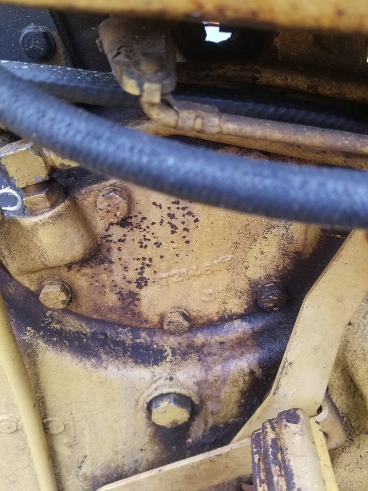

How much psi is needed to operate the system, i cant find a part number on steering valve

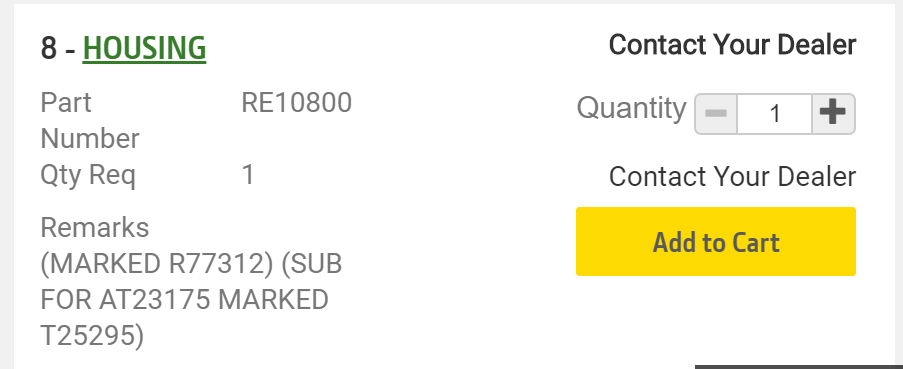

Ok its been a while since i have posted, i had a child so tractor had to wait, anyhow im back at it, im going to upgrade my open center steering to closed center, i removed the old steering valve today p/n T22829, which is correct for open center, however im looking to put a closed center valve on it, what part number will fit, and besides the pressure valve downstream from reversor what else do i need?
/ John deere 301a power steering pump #16
If your tractor has an open center pump then it's older than a 301A more like a model 300. CC PS valve housing casting #s are shown in photo below
