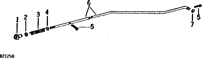

Nothing electrical. Either a lever or cable to the injector pump. Early model has lever, Late model has cable. Early model has spring return, check that if you have early model. Late model with cable has clamps to hold the cable that may have slipped.
Confirmed everything today on visit to the Farm. The Tractor has the lever, and everything seems to be working as built.

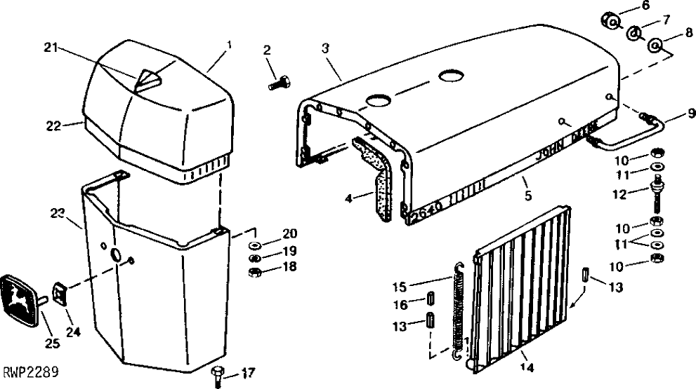

This sounds like an excellent way to determine if it is getting fuel, Do you know how to remove the Hood on this Machine. How is it fastened.
Nuts at each corner, side shields/grill come off to get to front nuts
Noticed Yesterday that there is some sort of container, Maybe Glass located behind the fuel pump that the line from the Fuel pump is connected to. What is this and does the line coming into the Diesel Pump come from this container. it appears to have about an inch at the bottom [about where the line from the pump enters that has different coloration. It looks like it might be some sort of settlement device. Any ideas about this. Thank you both for your comments.
