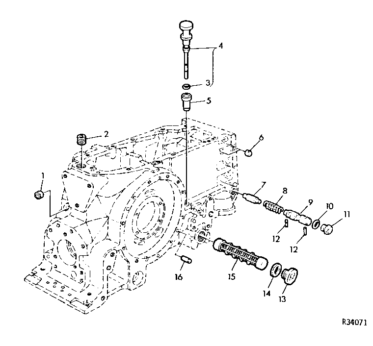

What type valve controls FEL? Does tractor have hyd ind pto &/or hyd hi-lo? How long since sump screen(parts key 15) was checked/cleaned?????????????????

Has john deere controls for fel.ind pto. And i started getting to screen. Wasent sure ware it was. But i found it. Just havent taken it out yet.

Ok well i checked screen and it wasent to bad. Alot of fine metal in tranny filter. No chuncks
