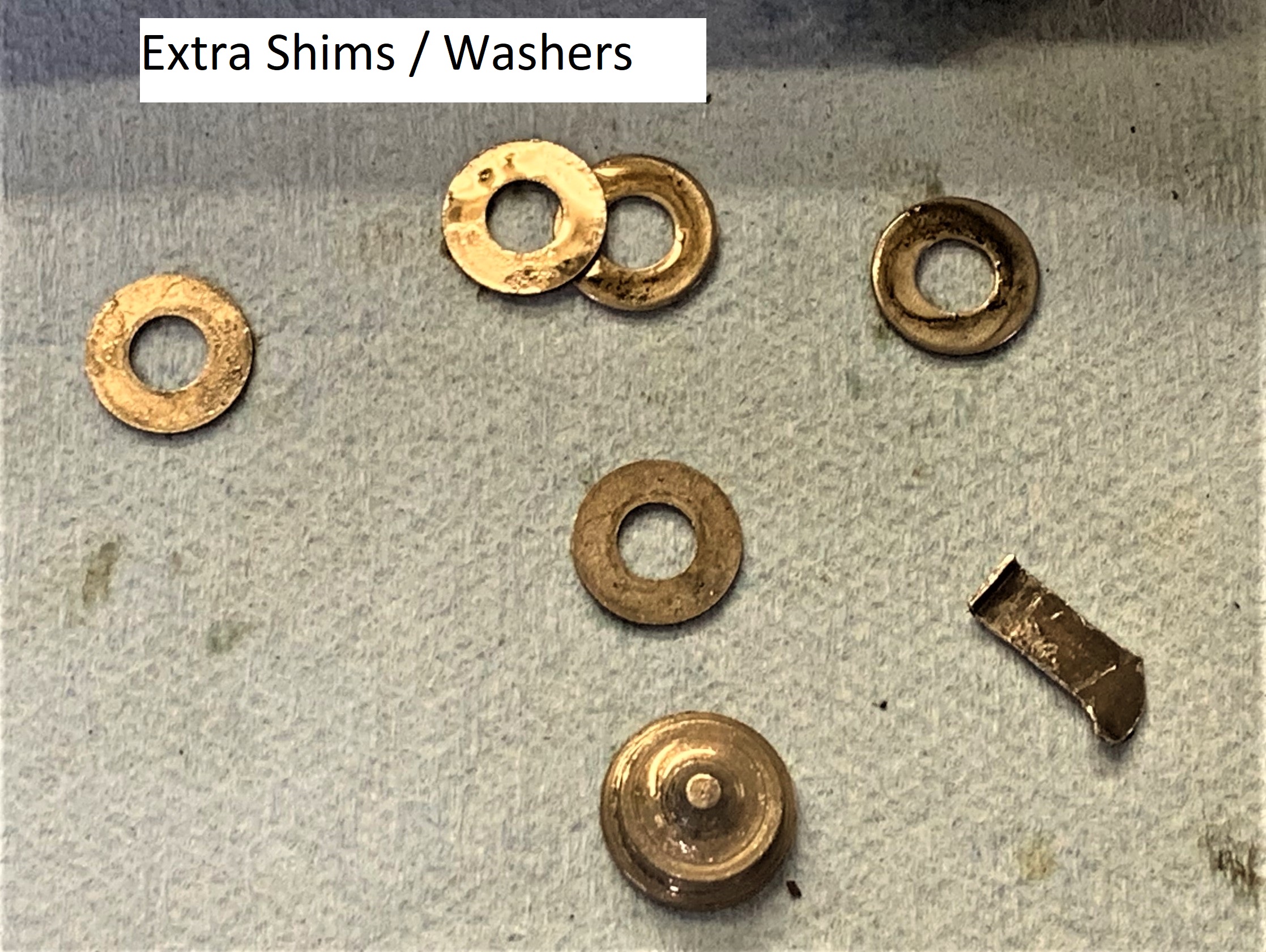

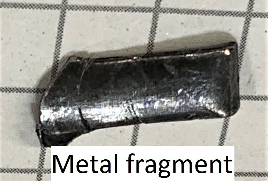

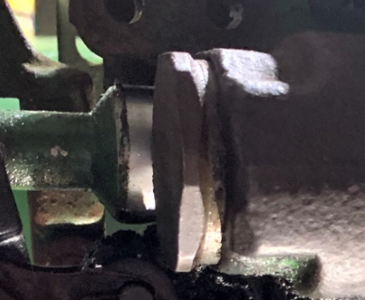

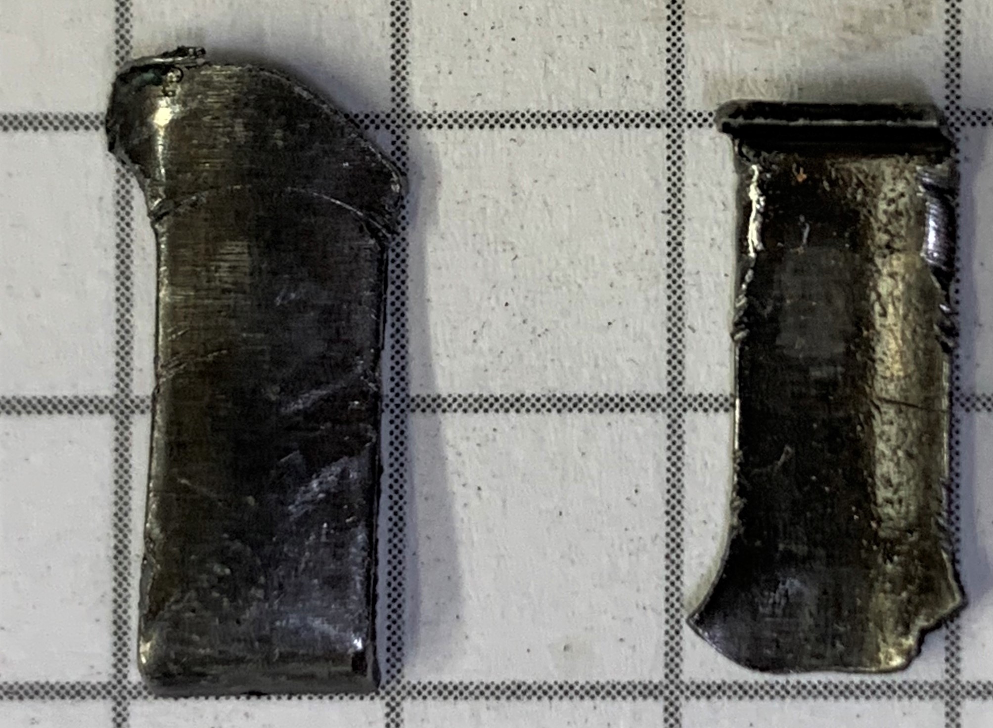

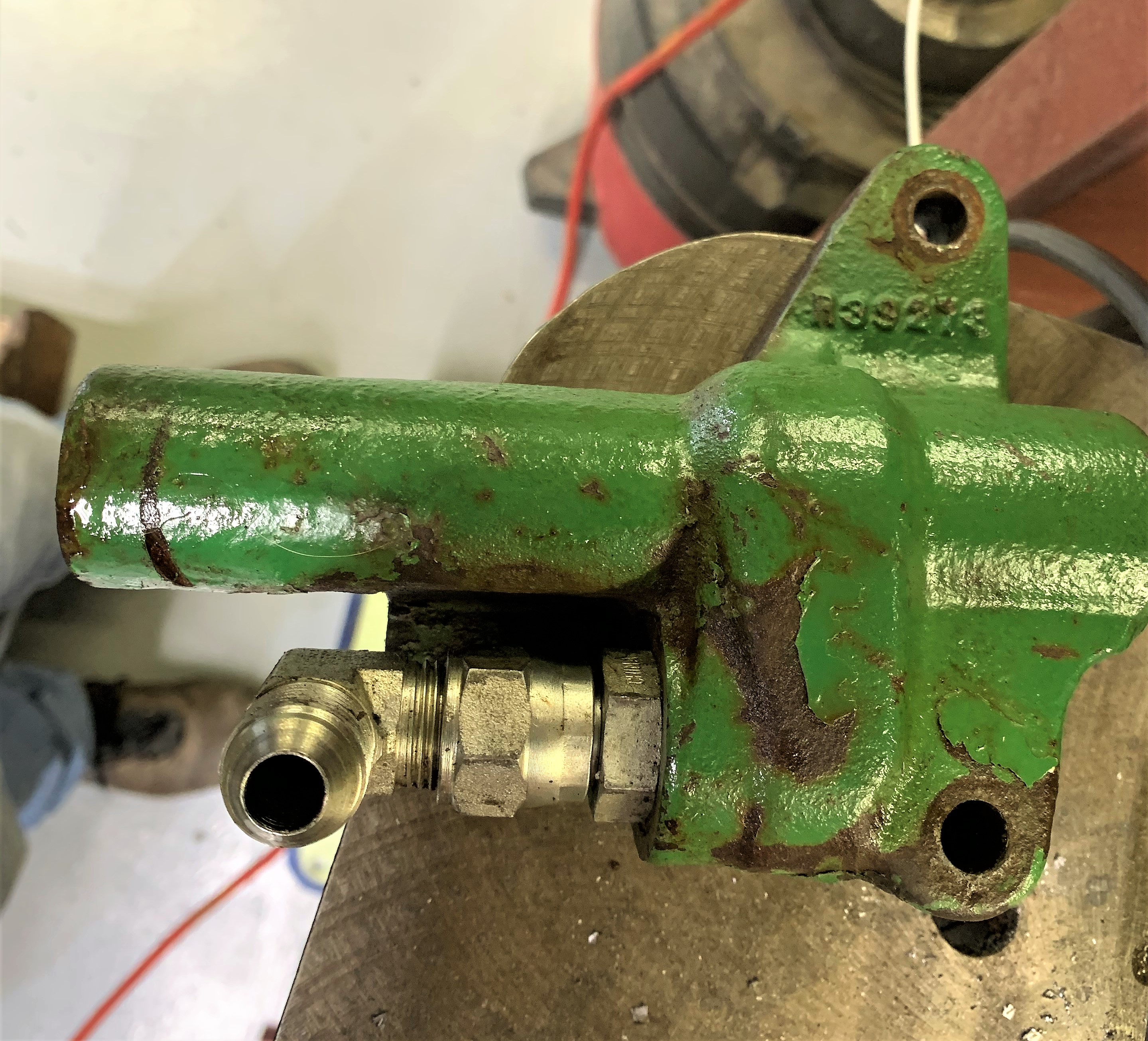

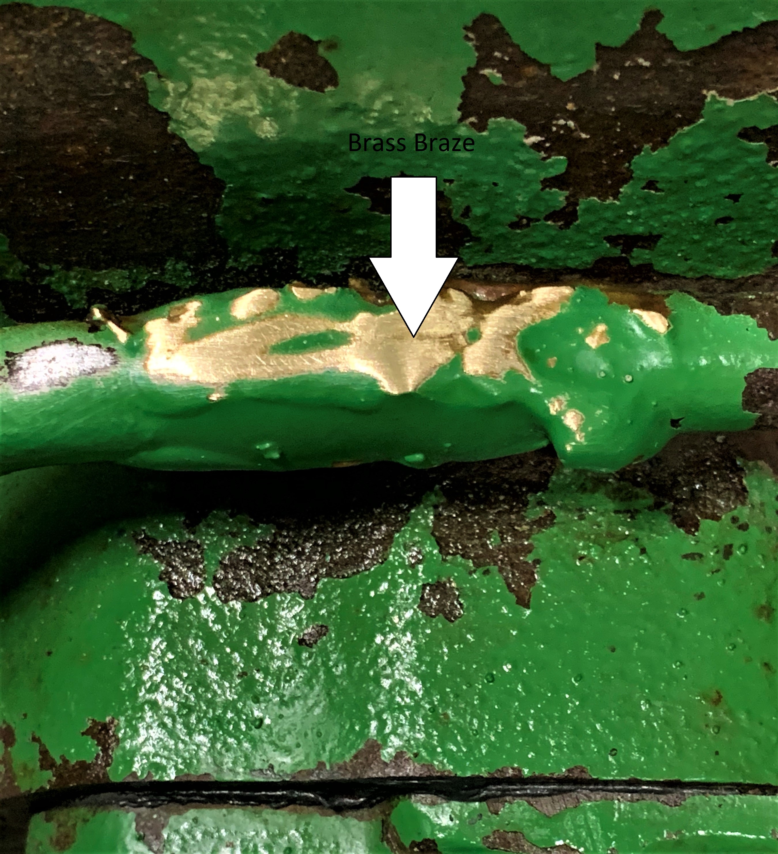

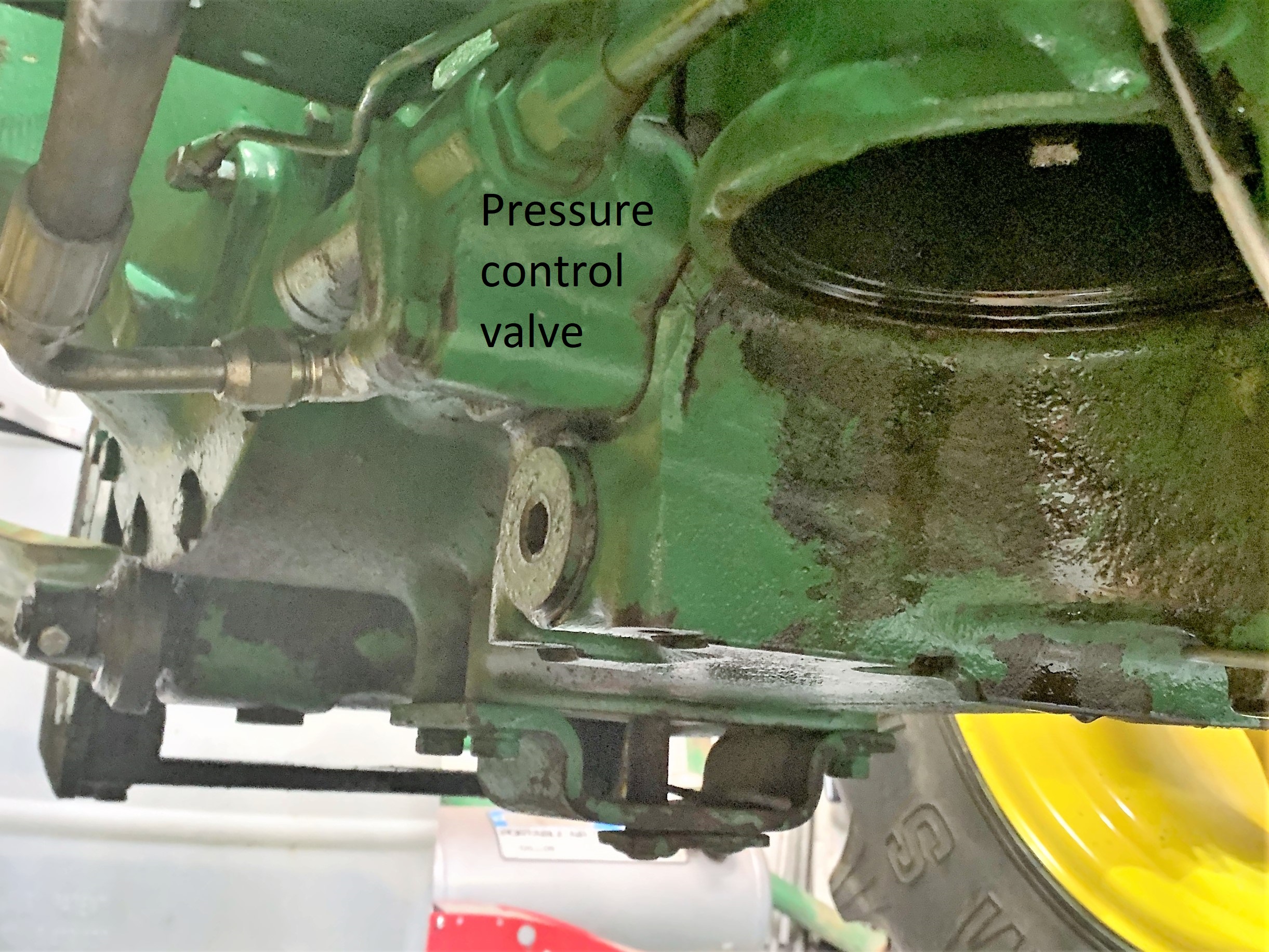

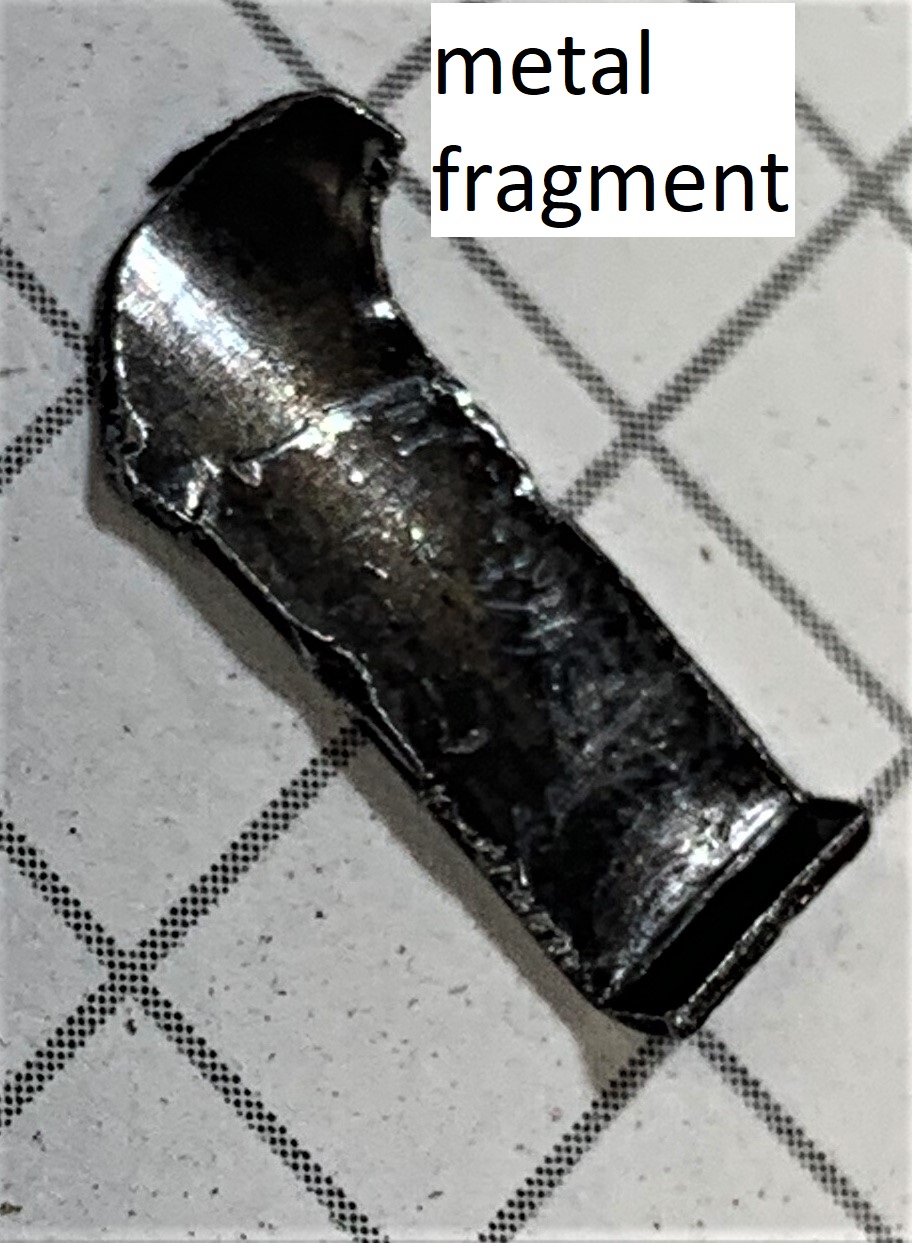

Looking through the Hydraulic fill hole with 3-point raised I didn稚 see any fluid splashing around, rockshaft piston well sealed. I read one blog where a fellow said he had lots of debris in the Hydraulic PCV (Pressure Control Valve) R39273. I decided to look in mine. The line coming into the PCV looks like it was a brazed repair after sanding the paint. Once I got the PCV off and removed the inlet fitting I couldn稚 get the piston out. As you can see in the picture I looked like it had a clip holding it, strange. I discovered a piece of metal ス long シ wide (a ***** to get out) was holding the piston retracted. Once out I also noticed 3 extra shims/washers.
I have new O-rings and parts to reassemble. Do you have any idea where the metal came from? I assume it was down stream of pump and missed the filters. Is this a part of the front pump? I appreciate your help and anything else I should look for.View attachment 652665View attachment 652666

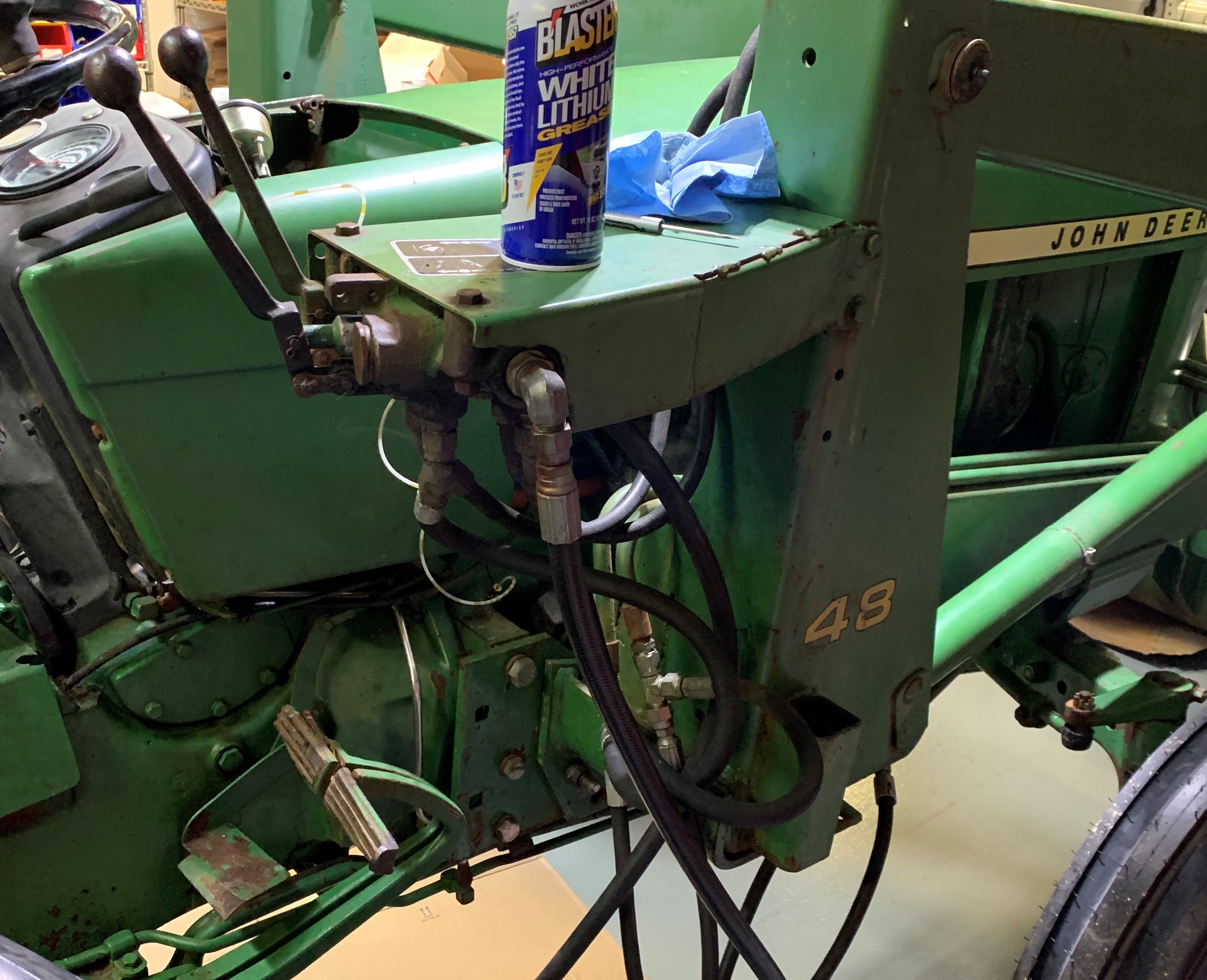

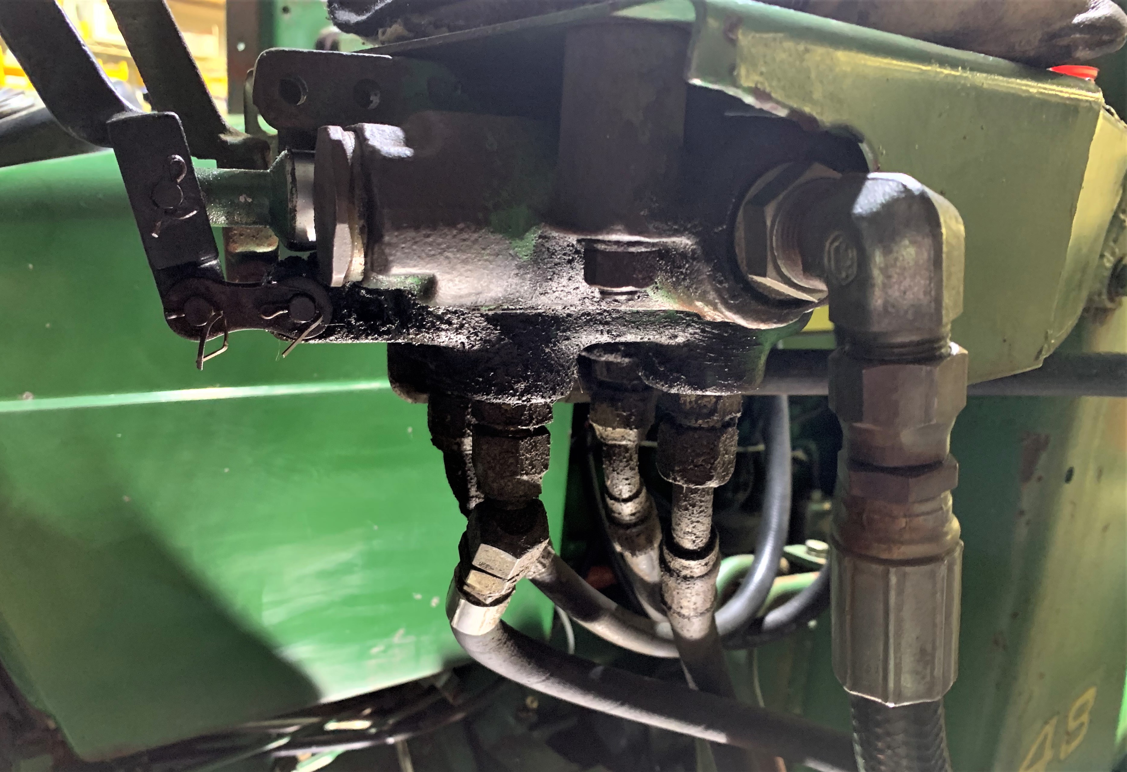

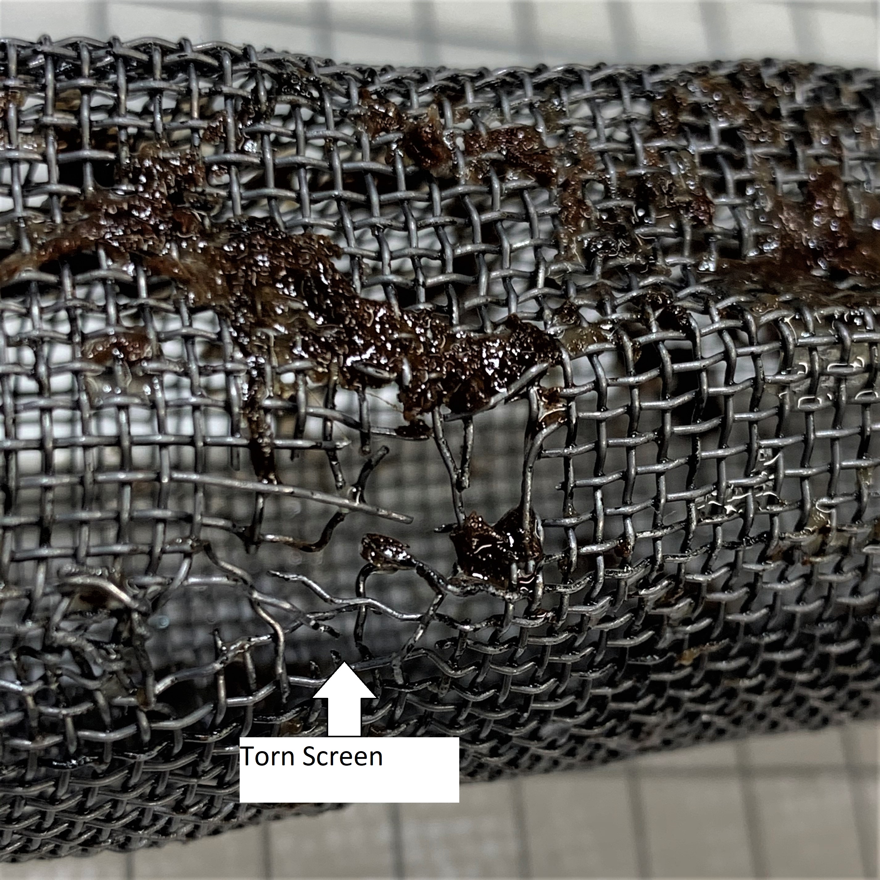

1st thing I'll recommend is replacing sump screen if it is in photo #5. Is the 48 loader controlled by a 2 spool valve? If so can you post a photo of the RH side of the valve body?

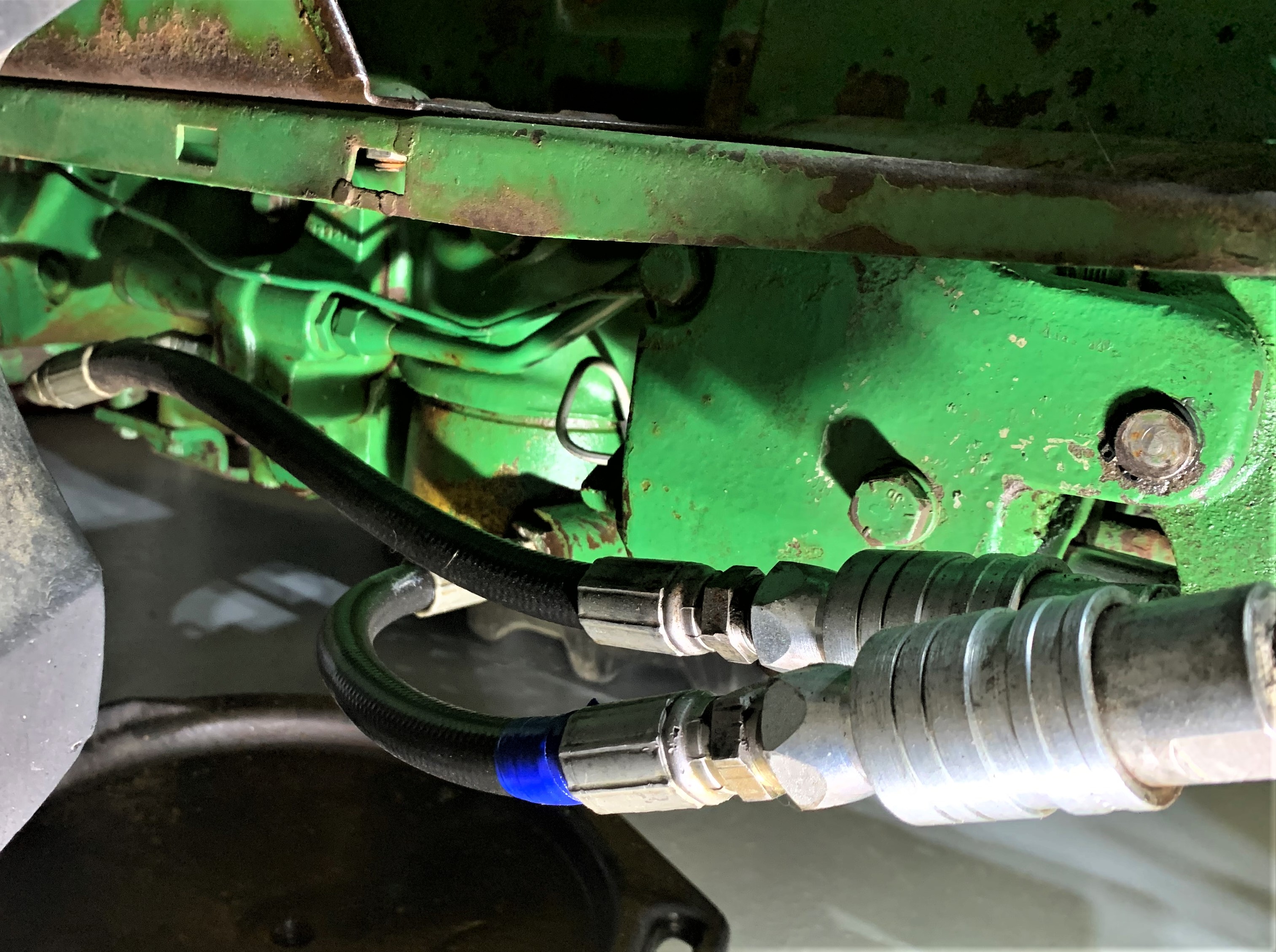

I've replaced the screen with a new one from Deere. I'll post pictures of the plumbing. thanks for the reply Tx.2 plumbing .jpg7 .jpg4 13 filter housing off.jpgloader controls.jpg

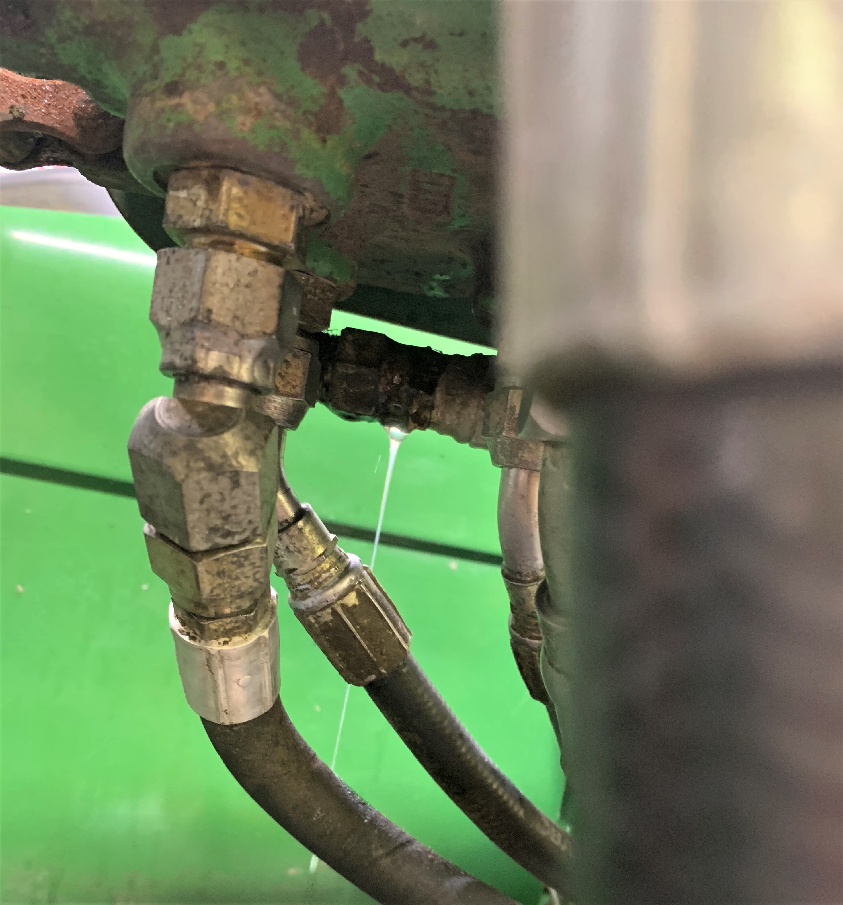

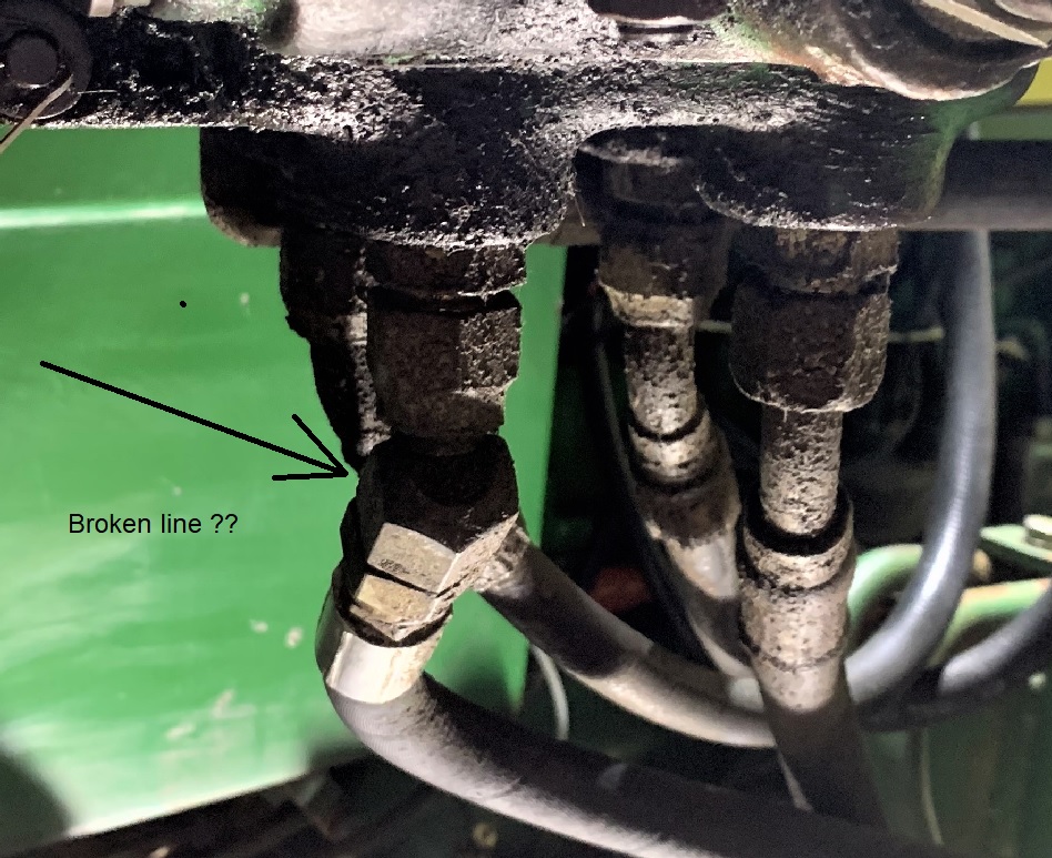

In your last pic, is that a broken line under? arrow..

Good catch Beenthere, I think it's a shadow. I'll look in the morning when I go to the shop. I'm surprised I didn't see a fluid leak.

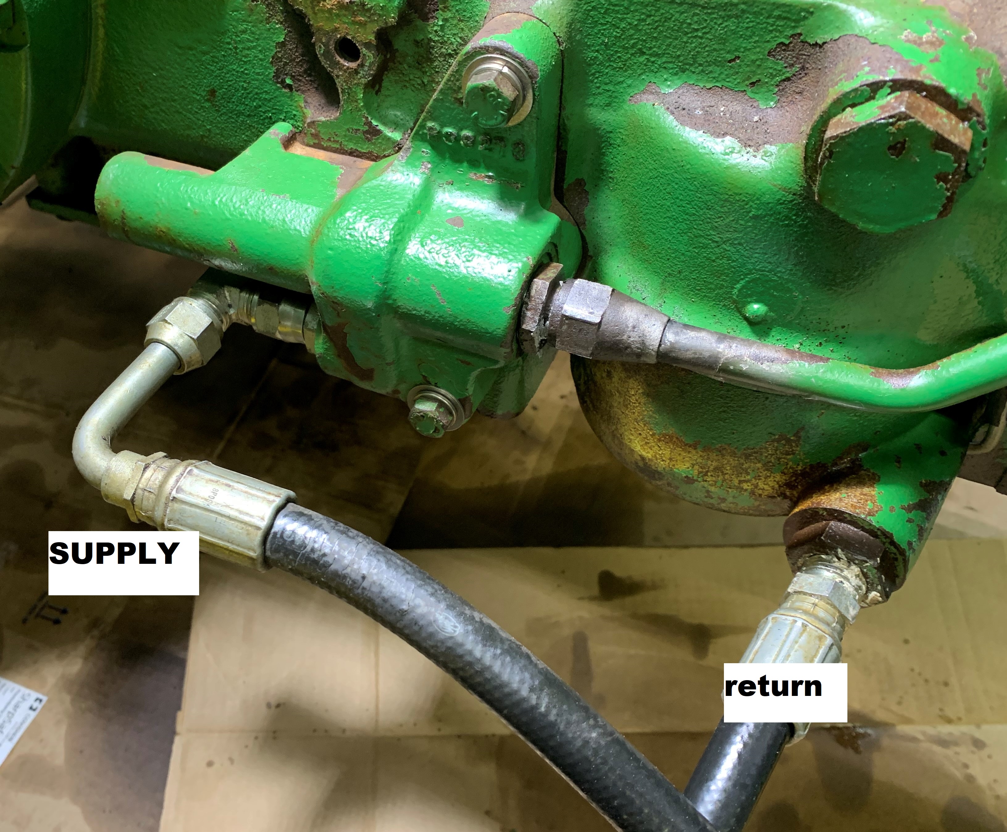

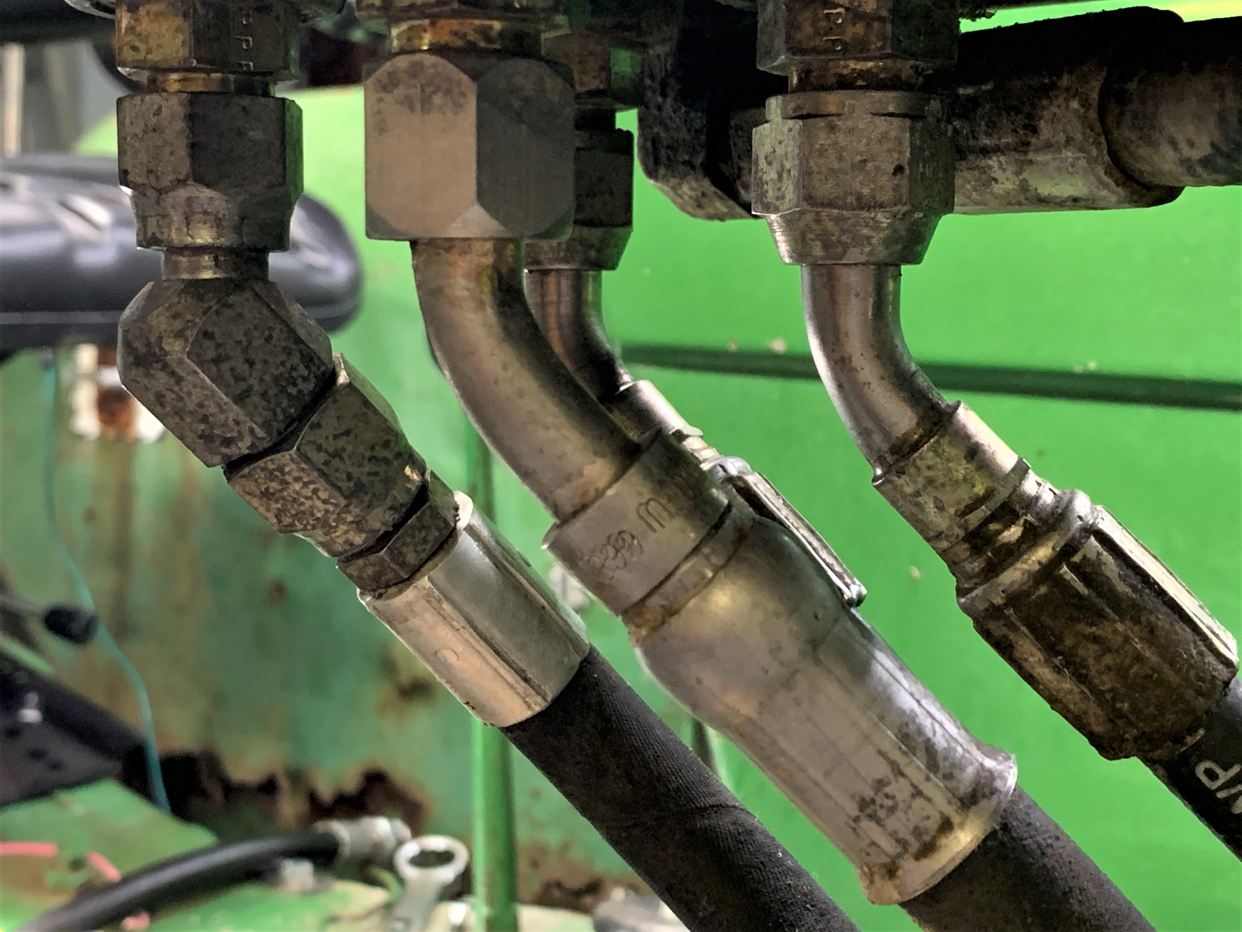

TX I did as you requested with the both loader valves in neutral position. Hydraulic fluid started squirting out the return. However, I loosened the Return connection on the controls, the coupler end was so **** tight. I also found another piece of debris in the supply line to the spools. Attached a closer picture and you can see none of the connections are broken. TX do I need to rebuild the spool now at this point of my adventure? Is there a kit with everything I need?supply return.jpg in the supply to the FEL controls fel hoses.jpgFel return line.jpg

Remove plug in photo & post a photo of the plug & associated parts. If a seal or seat isn't faulty after inspecting parts then complete valve will require being replaced to help cure hyd problems

1st thing you need to understand is trans pump is a gear pump that lubricates trans shafts/brgs,supplies low pressure(155 psi) oil to operate(if so equipped) hyd hi-lo or reverser & hyd pto. Then excess trans pump output is sent to frt pump. Picture labeled YT is a valve not a piston. Pictured below encircled in pink is photo of frt hyd pump piston. I have no idea from viewing your photo where your broken part originated.

I was going to say the same as TxJim (he gets up a LOT earlier then me) your picture is not anything to do with the transmission pump. Where is it from?

Thank you both for getting up early. Jim the mistaken valve picture from YT looks a lot like the ends in that picture. I've never had one of these apart and wonder if maybe it's item #15 in the IPB you posted? The shape and ends look to be similar, just a thought.Greasen loader 2712 valve AO 6.jpg
Here is what I found in the Gresen control, nothing else just these items. Greasen loader 2712 valve AO 4.jpgGreasen loader 2712 valve AO 5.jpg
