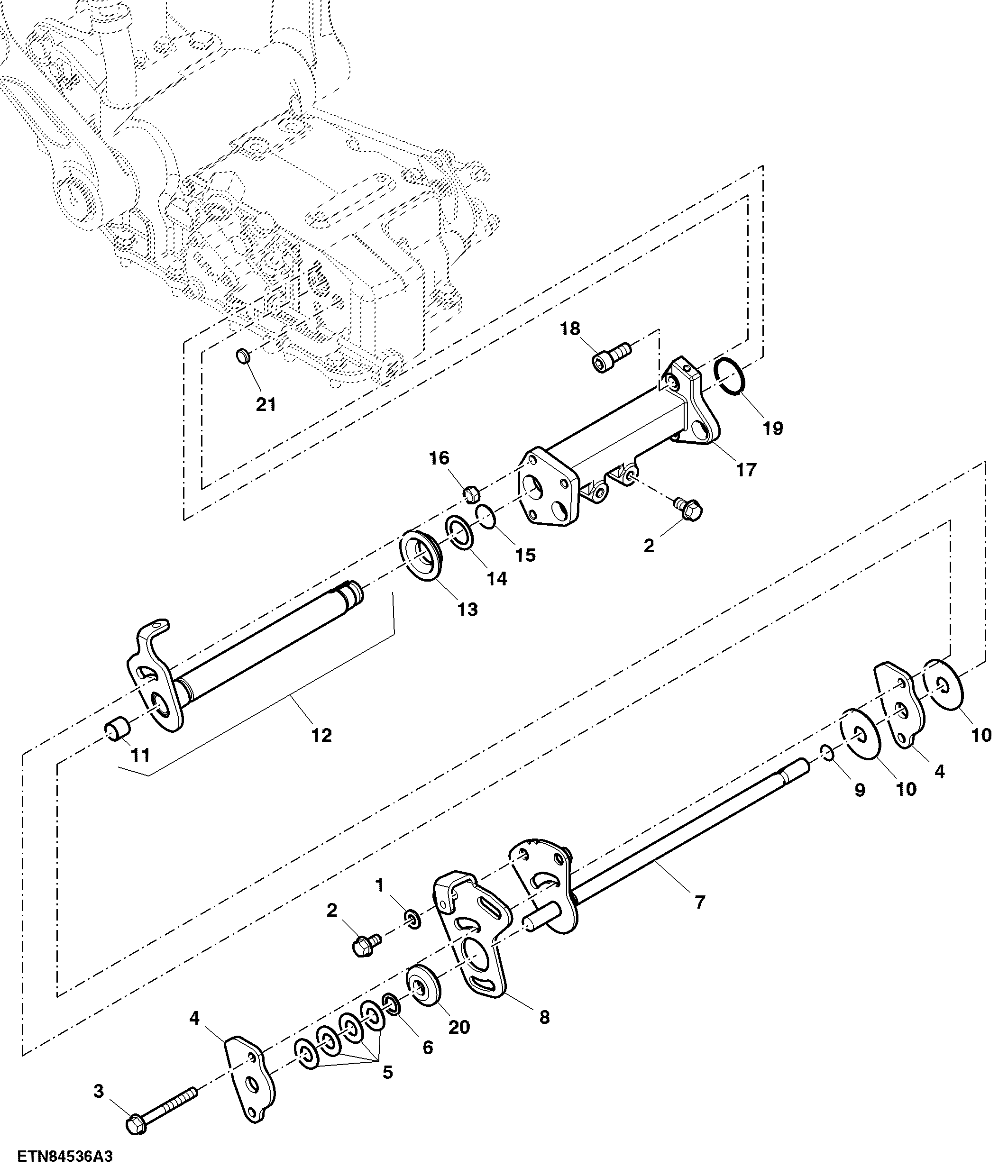

Loudon, thanks for the reply, and I hope you can get the 3 pt hitch problem fixed. Mine started gradually slipping down a few months ago, but it didn't come back up. The friction control on the levers just needed to be tightened up and that fixed it. I thought it was strange that I had to adjust that after a little over 2 years of use. I ran my 5210 for 13 years and never once had to adjust it.
It sounds like I should have been harder on my dealer about fixing my brakes. Nobody ever offered to buy mine back or extend the warranty. I sent that video to my dealer's service manager and he sent it to a higher up at JD; their response was that it was "in specs". I wonder if I could sell that video to Kubota? :)
How is the friction control adjusted?
My 5055e cab has a really tight rockshaft control lever.
   / John Deere 2013-2015, 5E series brake problem? #50
My guess without access to a 5055E tech manual is by tightening/loosening cap screws(parts key 3) note that washers(parts key 5) are spring type.
