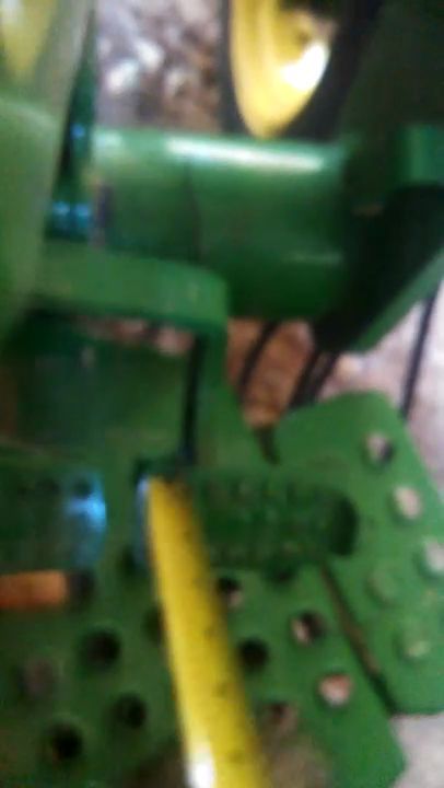

To the OP - Has JD done anything about your brakes? I have a 2012 5075E that has this issue and I posted about it in another thread here a couple of years ago. My warranty is out and I've just learned to live with it. I think that after putting 300 hours on the tractor it might be just a little better now. Here's a video from a few months after I bought it:

Your video is a good depiction of the issue.
I stopped posting my story on here a while back since my dealer's general manager, his service technician and a representative from John Deere came out together and finally got my brakes to work slightly better than they had been. They offered to buy the tractor back as an alternative but would not replace it. I told them I would keep it if they extended my warranty so Deere extended the 24 month warranty to 36 months. At this point, I'm used to the way the brakes function but still do not believe they work correctly or safely. My insurance agent has assured me I'm covered no matter what, even though I'm aware of the problem.
