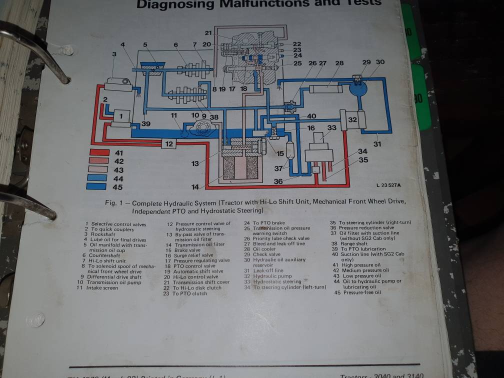

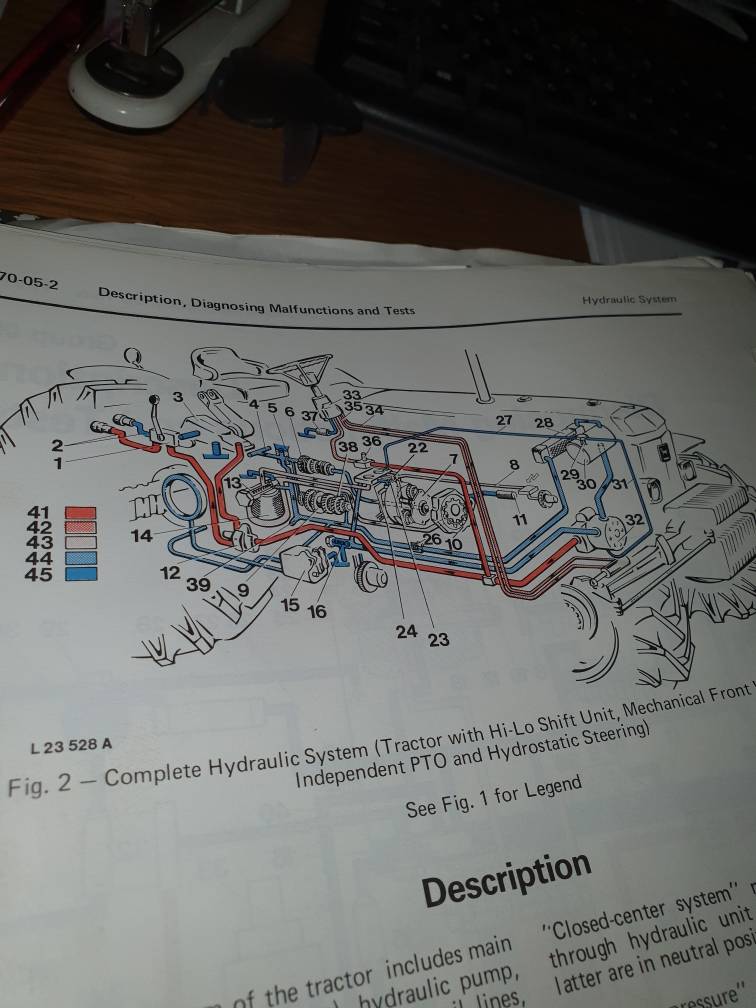

Hi Everyone-
Been having the weirdest problems with the hydraulics on my 1640 and have finally determined that we only have hydraulic oil pressure when the rockshaft lever is in the raised position. Have now determined (due to an oil pressure gauge installed off a port on the hydraulic pump) that it doesn't matter what position the selector lever is in (Lift or Load or in between), when the 3 point hitch rockshaft lever is lowered the pressure drops. Midway you have 1/2 pressure, all the way down you have nothing--no power steering, FEL, nothing.
Does any of this ring a bell or sound familiar?
I can get into taking the top off the rockshaft housing but I kinda need a direction to go in here to see what I should be looking for. Any suggestions or ideas are appreciated. Cheers.

My 1st thought would be to perform the L/D control adjustment procedures described in length in your tractors JD tech manual. My next guess is clearance on mechanism that controls the valves isn't set to correct clearances on the pressure & return valves but this would be addressed if my 1st statement is adhered to. I've witnessed breaking of the cam follower or spring under rockshaft housing causing 3 pt control problems.

Tx Jim-- Ok. Was impossible to complete the L/D controls setup past setting up and verifying the Negative Stop Screw. When I went to the next step, Depth Control Neutral Range with the Selector in the upper "D" position, rockshaft in lower, upon engine startup the lift arms raised about 1/3 and the quadrant lever went up with it. The only way I could get the arms to lower was to put the selector in the lower "L" position, then they would lower. I put the Selector back in D, lowered the quadrant lever and shut off the tractor and they lowered.
When I cranked 'er up again observing carefully, same thing, arms raised and took the quadrant lever with it.
The port hole for the adjusting screw seemed to have a consistent spray of oil that was trying to come through it. I looked in the filler hole and there seemed to be a bit of a water sprinkler thing going on in there with hydraulic oil. Memory plays tricks on me, but I don't remember seeing that before, quite a bit best I could see with a pen light.
That's where I'm at now, kinda dead in the water. Wondering about seals in the rockshaft cylinder.
Any thoughts are appreciated.

To see if it is some adjustments.
Look at rightside of hidge and find a plug that you can unscrew with a t- handle ...inside you will see a screw. Screw that in with a screwdriver to widen the neutral range and see if the spray at the back lessen or stop.
You can test that by moving the lever just a little up and down and see if the arms lower and lift just a little.
All those models have a problem with blowing the o-rings on that valves.
/ John Deere 1640 Strange Hydraulic Problem #11
With your gauge installed on the mainpump loosen the pipe just before the split to the steering and plug that pipe comming from the pump. Start the engine and see if you have full pressure. If so then move your plug to just after the t-fitting to add the powerstering. If pressure is ok then add the next funtion. Image%20(2).jpeg
/ John Deere 1640 Strange Hydraulic Problem #12
You are working on a close center sisteme with "taps" that should be close at all times but when you need some work to be done. By blanking pipe it will give you the same power as closing taps.
/ John Deere 1640 Strange Hydraulic Problem #14
I still think your only solution is to remove rockshaft housing & see what's wrong. I think cam follower or spring is broken or linkage is not in correct location. With rockshaft off would be a good time to replace RS control valve & piston seals that have been known to fail/wear out. 3 pt control lever should have enough tension on friction washers so lever stays where operator positions it.

Yeah, I think lifting the rockshaft housing is in my future. I agree that replacing seals and anything else while it's off is a good idea. Yesterday when I had to make a trip into town I picked up a little borescope or endoscope that attaches to a laptop. If I can get that going and see what is happening inside while it is running or where it is leaking in the various rockshaft lever positions, that would be good idea. In a perfect world, if I can figure this out and order parts ahead of time it may help overall. I will try to figure out how to take a picture with it and that may provide some clues. Thanks for the suggestions.
