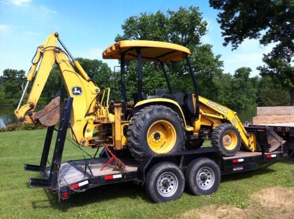

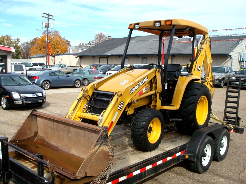

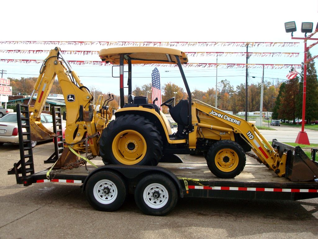

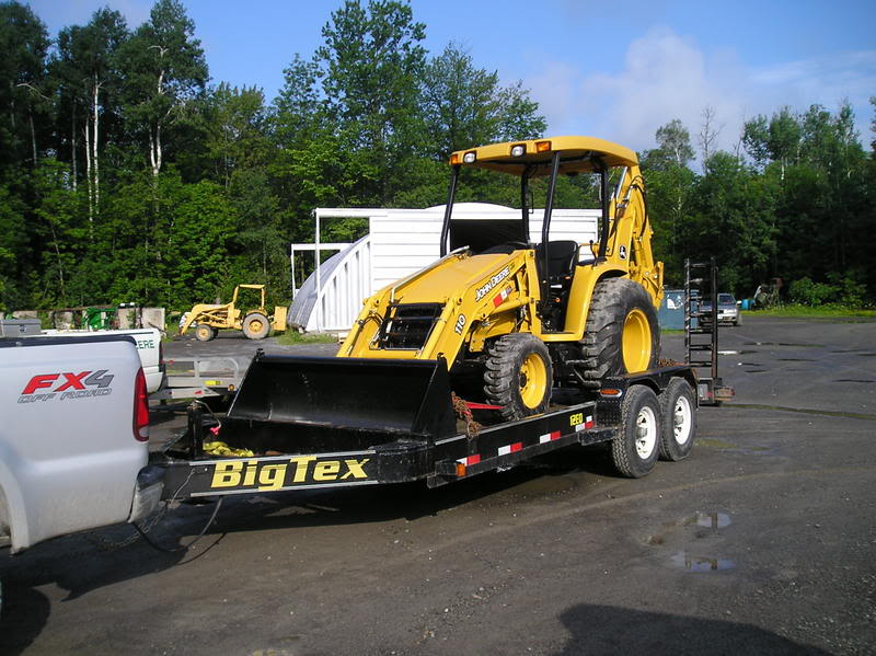

Here is a few photos I found on the net, I was saving them just encase I needed a trailer.

I think the biggest problem you'll find with a dump trailer is weight distribution. Dump trailers typically have their axles located further back then deck trailers. The shorter the trailer, the worse the problem. I've hauled my ctl (9800 lbs) a couple of times in a dump trailer. Last Saturday as a matter of fact. Even with the majority of the weight of the ctl being aft of the machine's centerpoint, it wasn't a comfortable ride. I'm glad they were short trips. This was with a BP trailer...I imagine a GN would be slightly better.
