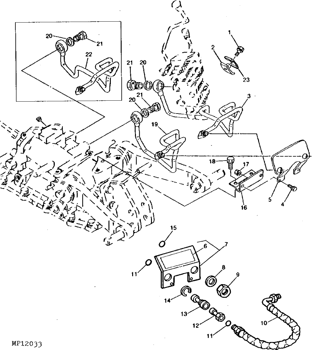

I'm new at the forum thing. I've been working on tractors and mowers all my life but can't find what I'm lookin for and haven't ever added remote hydraulics. I work for a golf course and we use a gang mower to mow the rough. They what to change what tractors we pull it with to a JD 1070. But it doesn't have any remote hydraulics to lift and lower the reels. It's got it's own valve controls for each reel on the mower. We just need some thing to move the fluid if that makes any since. But back to the topic. what can we do to achive this.
Thanks for any advice

To access the auxiliary hydraulics on the 1070, you will need basically a "power beyond" kit like was sold when a backhoe was fitted to the machine. Unfortunately they used banjo fittings for these connections so find a off-the-shelf solution is going to be tough.
With this "kit" though, you can add a valve of you choice to get some remotes...
/ John Deere 1070 remote hydraulics #4
According to the John Deere site (under Parts Look Up) John Deere - Parts Catalog The kit is still available. Call your local JD dealer and ask about part number BM18010
This is fairly easy for a tractor repair shop to install. They don't expect you to do it do they? :D

Yes, the PB kit is a supply of constant hydraulic oil flow for implement with their own valves like backhoes and log splitters, so you will need a valve to actually control the cylinder(s) on the mower.
I did the same with my 4110, you can view the thread HERE, and a few others also:
Jim's remotes
Brad's remotes
And there are PLENTY more if your search the term "remote"
How many spools do you need to operate the mower?

Well then, since the mower has it's own valve's then all your need is the PB kit from JD.
Like I said before:
and mowers with valves!
Just be sure to NEVER interrupt that flow (like unhook the mower or the bypass loop) when the tractor is running...you can damage your pump!

So if we do unhook the mower from the tractor we need to bypass the hoses where the fluid is still able to have a constant flow.
/ John Deere 1070 remote hydraulics #11
Yes, part #10 in the picture above.

Oh ok. so that hose is part of the kit. Thanks I had my friend that works at Greensouth order it today. she got it for me at a cheaper price.
/ John Deere 1070 remote hydraulics #13
Yup, everything you need is in the kit except the two QD's you will need to put on the hoses to the mower.

I just notice that they have a SCV valve in the diagram. Do i have to get that kit to.
/ John Deere 1070 remote hydraulics #16
Your machine does not have it? (it's for the loader)
The PB kit should include parts to hook it up if you do not have the SCV, at least the newer machines do...
