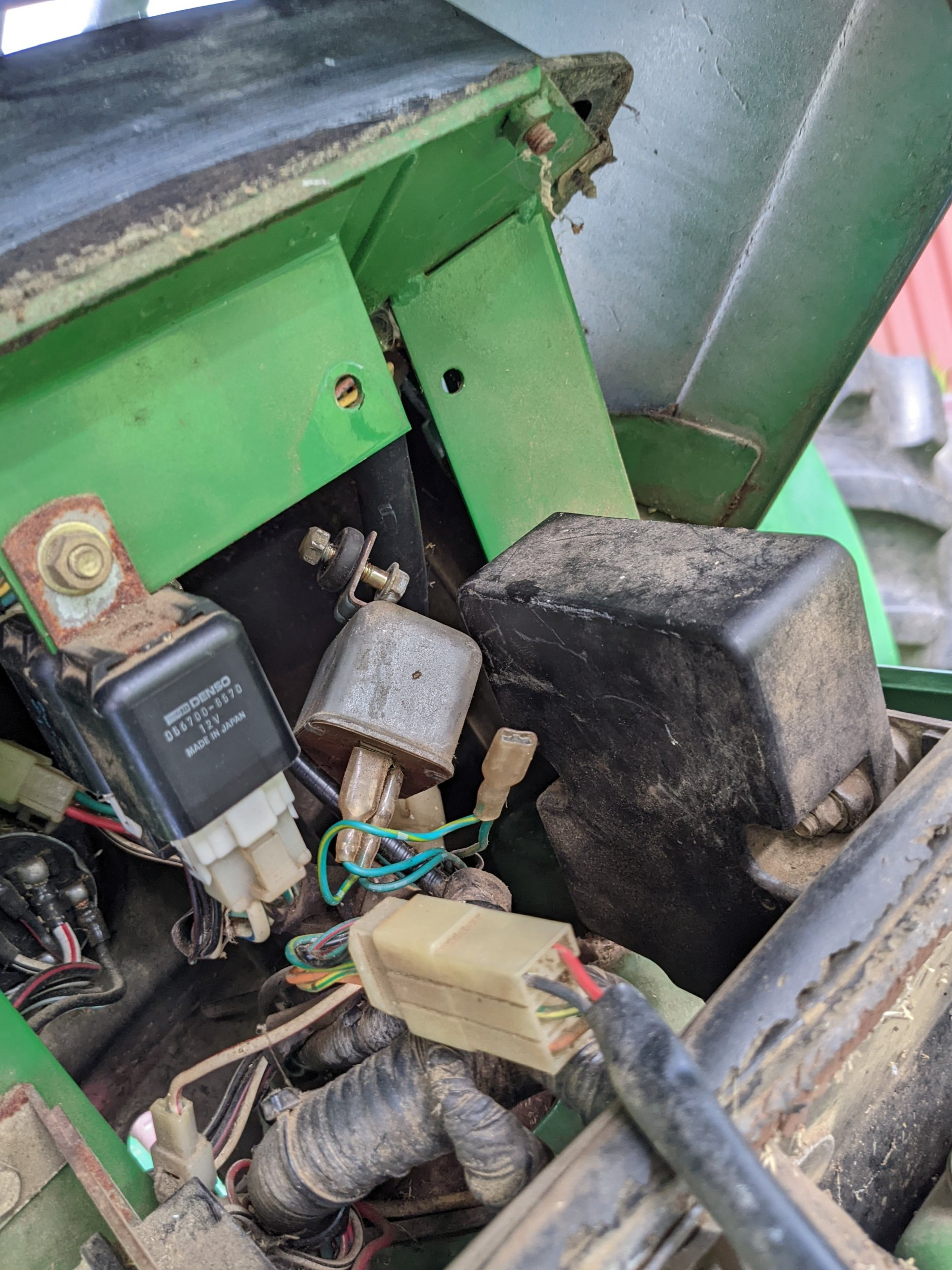

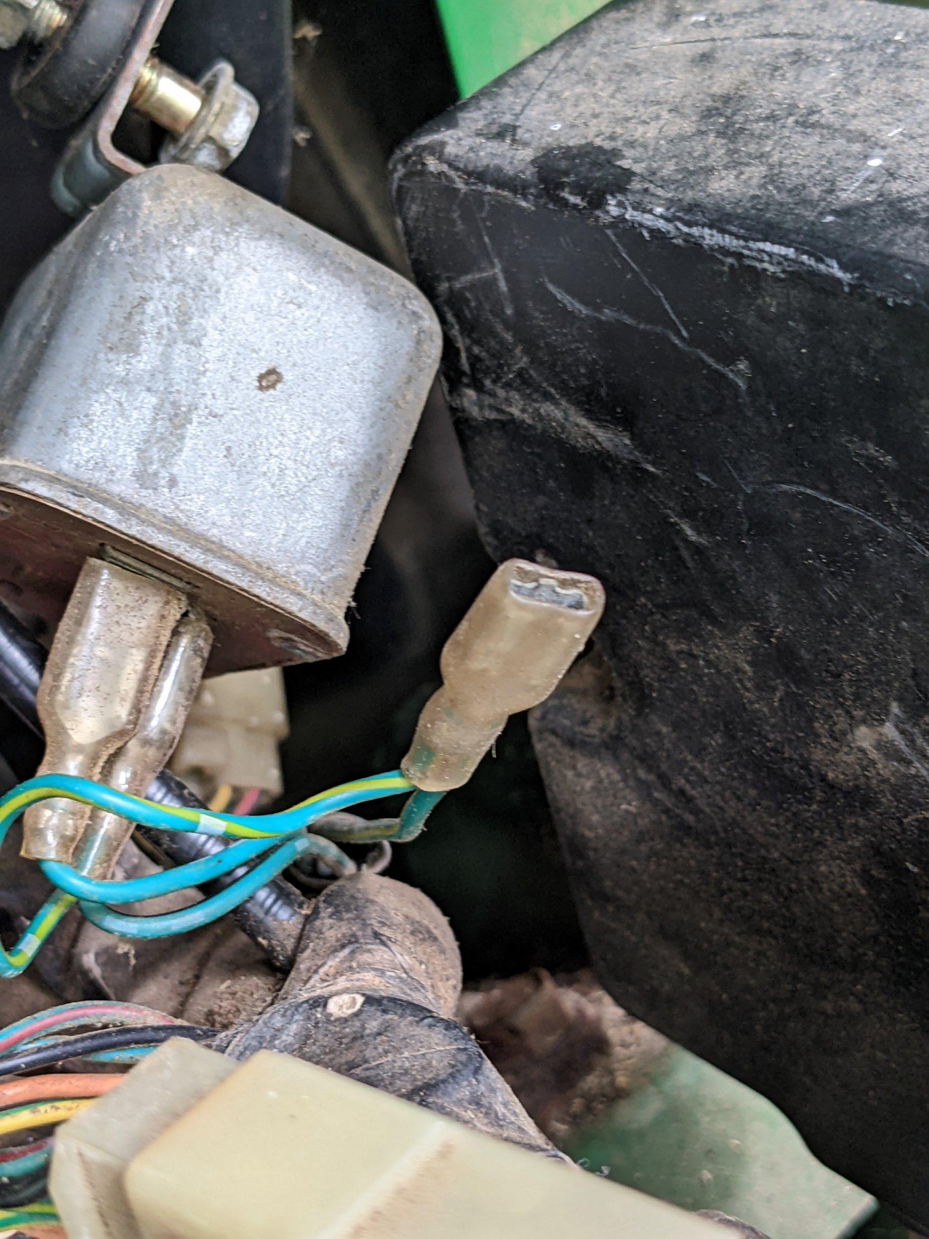

I have a 1070 (bought it new the year they came out) with a disconnected wire under the dash. It has a female connector on it with 2 wires, appears to be yellow + blue, and a solid blue (or could be faded black). The wire comes out of a bundle and is only a couple of inches long. Oh, and my fuel gauge and temp gauge stopped working. (a clue, maybe??)
Problem is I can't figure out where it plugs in!
There are a bunch of relays in the near vicinity but I can't see any empty plugs.
Any ideas?

Female connector, so probably meant to be "plugged into".
A pic of that connector and what voltage it has when the ign switch is off and on.

Runs great. Tough to get a Pic, it's kind of under and behind a bracket that holds a couple of relays. I can't find any blades that aren't in connectors.
I may have to take it all apart. I'm puzzled because the 2 gauge's sometimes stopped working, and almost always together. Then they would both recover. Never noticed the disconnect before.

Here's a pic
/ John Deere 1070 disconnected wire
Another

Thanx for the reply. Unfortunately this wire is under the dash, nowhere near the battery, and it comes out of a bundled wire cluster. I'd have to strip out the entire cluster to trace it.
#9
If it's not apparent, this connector is a female blade connector. Can't find a matching male anywhere. I was thinking maybe it had briken off of something. Incidentally, fuel gauge now works, but no temp.
I may try replacing the temperature sender. Anyone know where I can get a replacement? (About to google it.)
