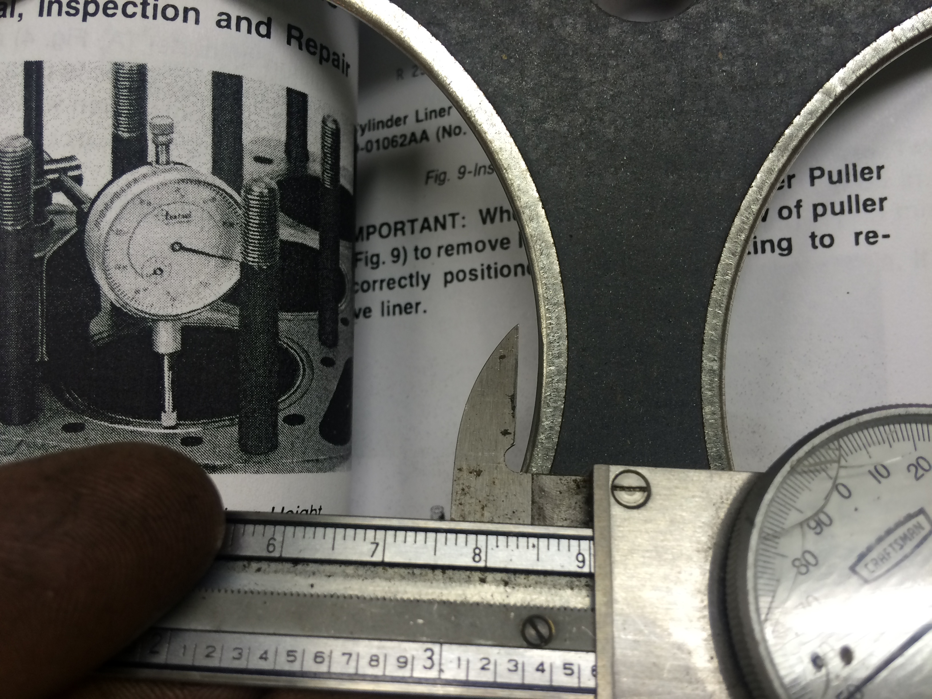

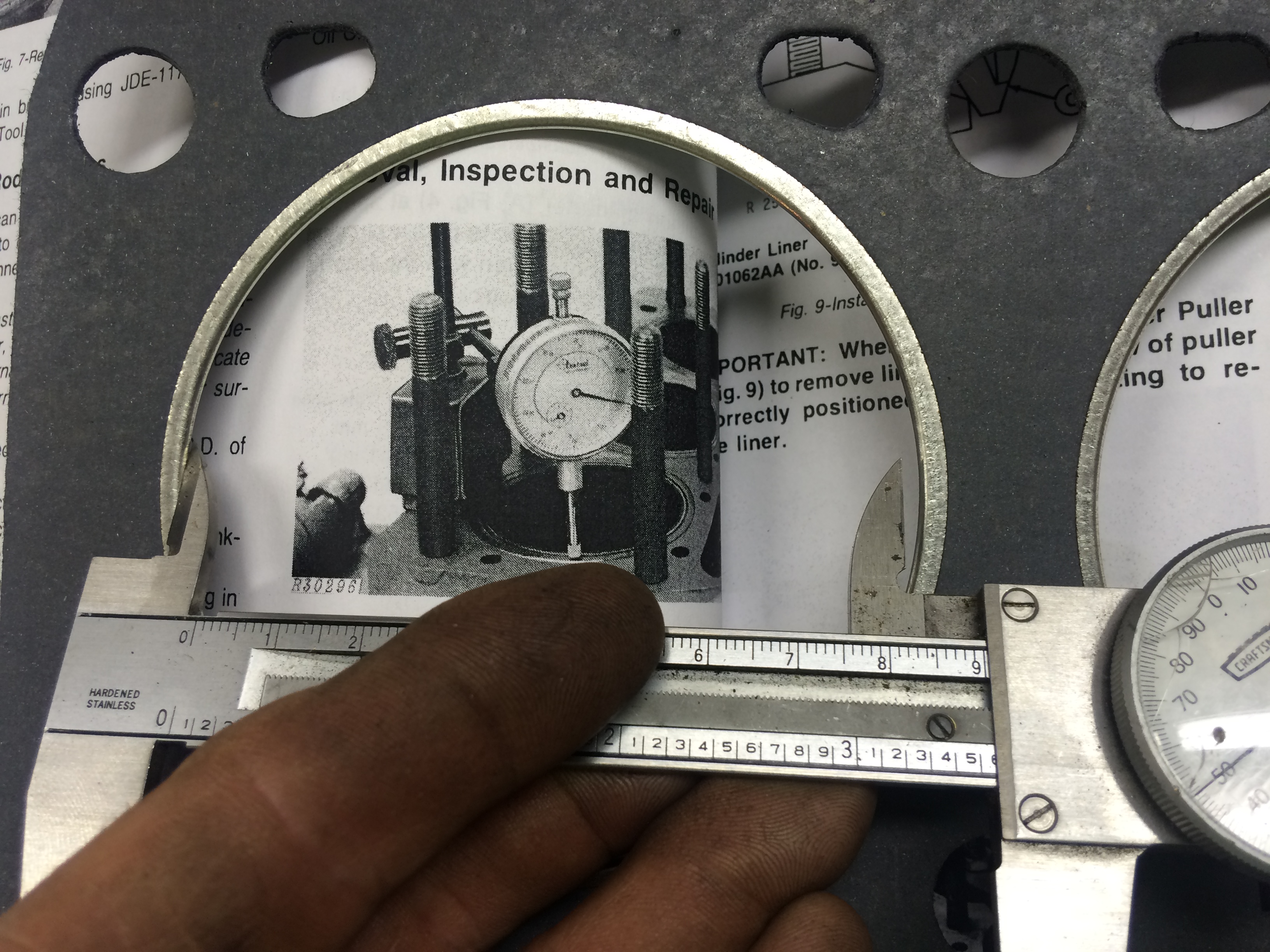

I believe the metal ring should rest on the shoulder of the liner. I wish I had measured the ID of the Deere head gaskets. Here is a pic of an aftermarket gasket I received from Weaver Tractor as part of an overhaul kit. It looked cheap to me and I obviously didn't use it. I think the Deere gasket is the way to go. Regardless, I'm glad you got your fixed.
The break in serials listed in the manual is based on the engine serial.
This gasket is about 1/8" larger than the cylinder bore. The caliper is set to the bore service limit.

Okay thanks, that's something I definitely missed in the service manual... the head gasket on there now rests on the shoulder while the lower S/N gasket metal rings fit on top of the raised portion of the sleeve.
