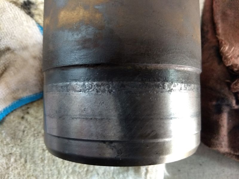

Hey Timberhole, I cleaned up one of the sleeves today and see some pitting down around where the o-rings would sit. Question is whether the pitting is bad enough not to reuse the sleeve. I guess it could come down to a choice as I the sleeve bore doesn't look to bad and measurements indicate it is still within spec...
Would you reuse it?
   / John Deere 1050 Engine Opinion #37
That's the very same pitting I saw on mine. The worst pitting is above the top oring. The witness mark for the lower seal is clear in the pic and the surface doesn't show any pitting at that location. I'm guessing the lower seal will seal perfectly and the top seal might seap a little.
Would I use the sleeves? Yes, if they mic good.
I would consider putting a little stop leak in the radiator. It won't hurt anything and would help seal any minor imperfections at the top seal. Either way I think the sleeve will seal. Obviously you can't go wrong buying new sleeves but they are expensive and these in frame repairs are not really full overhauls. Have to draw the line somewhere. That's my $.02.
