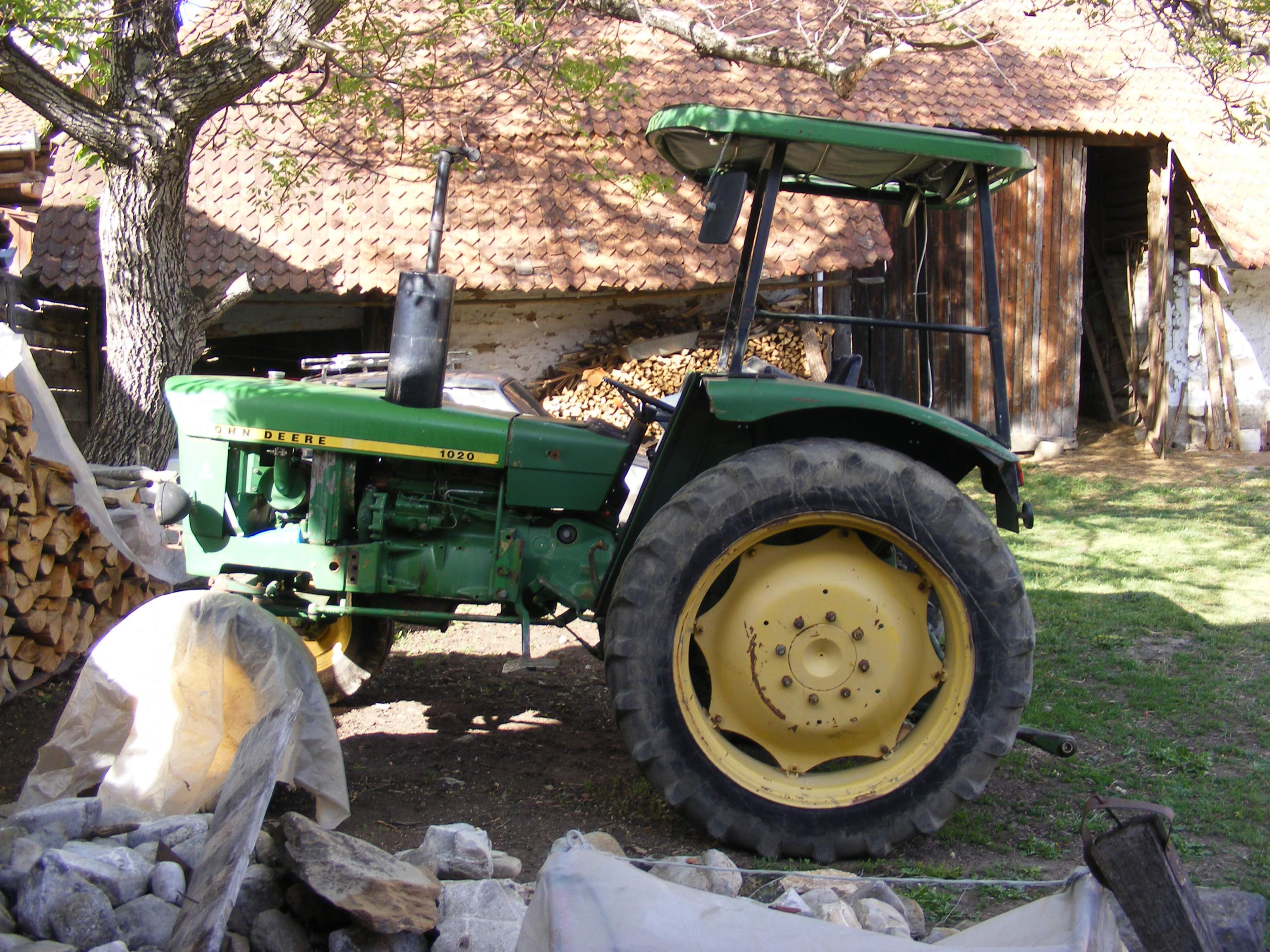

Hi...
I have a JD 1020 tractor .... When I try to shift on the PTO, not responding.... I tryed with the depressed clutch pedal - nothing, with undepressed clutch---- nothing...:confused:
Please, help me.... If you want, I tryied to sending video .... Sorry for the my poor english...........

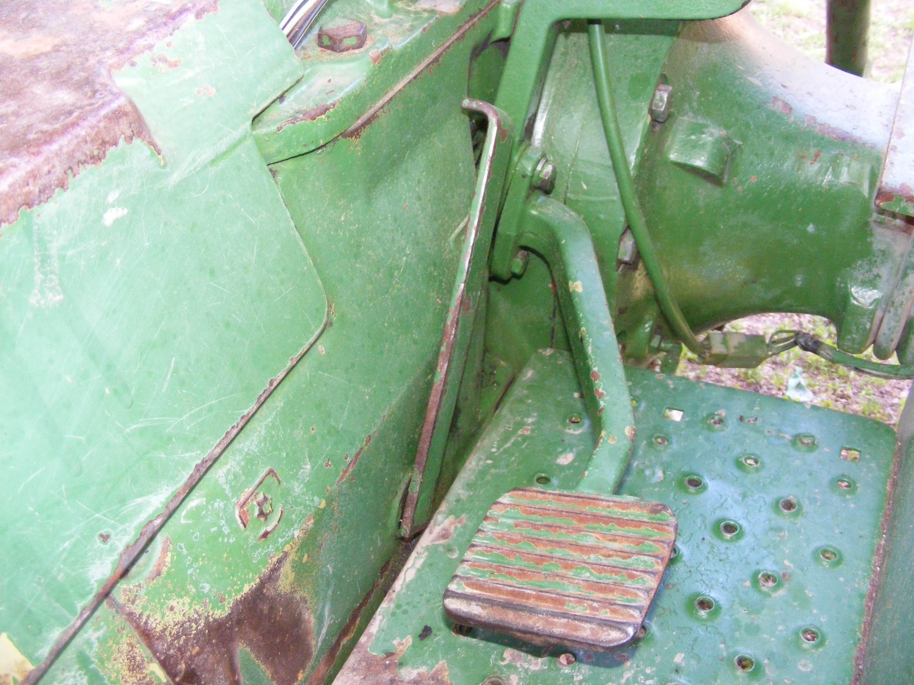

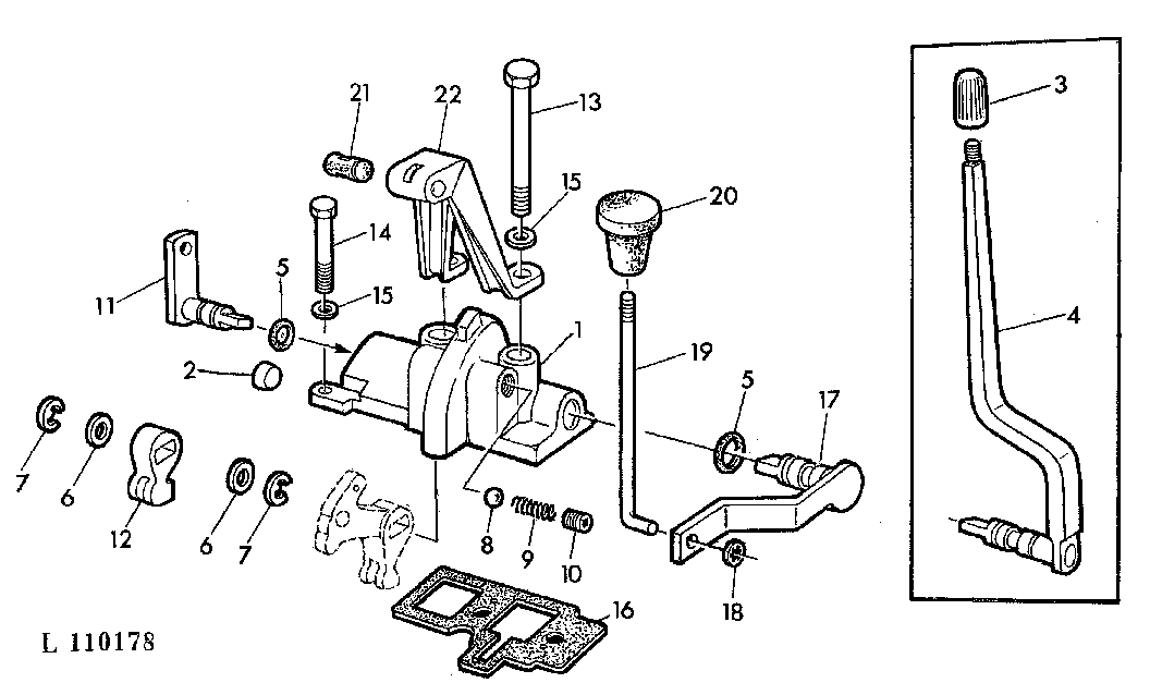

independent pto.gifDo you have a lever like this between the transmission shift levers? If so, then pushing in the clutch has no effect on pto. Push down on this lever to disengage pto clutch. The lever on the left side of transmission beside your left foot disengages the splines on the shaft. The lever between shifters is a hydraulic clutch for pto. If you do not have lever between shifters, then the foot clutch should stop pto and tractor needs to be split to repair.
/ John Deere 1020 PTO (clutch) problems..... #6
jd110
I asked that same question of historyan1975 on a different thread and they stated no lever between gearshift levers.
No lever... only PTO ON/OFF switch lever on the tractor'"s gearbox left side...............
If you watch the following video as I also did you will see that the tractor JD 1020 made in 1966 has PTO/engage lever.... But my tractor made in 1975 does not have PTO lever between shifters...
Then the final conclusion is that the foot clutch should stop pto... which in my case is not working in this way...

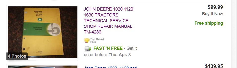

Have you considered purchasing a JD 1020 tech manual??? Technical Manual TM4286 1020, 1120 & 1630 Tractor Here's one on Ebay.
