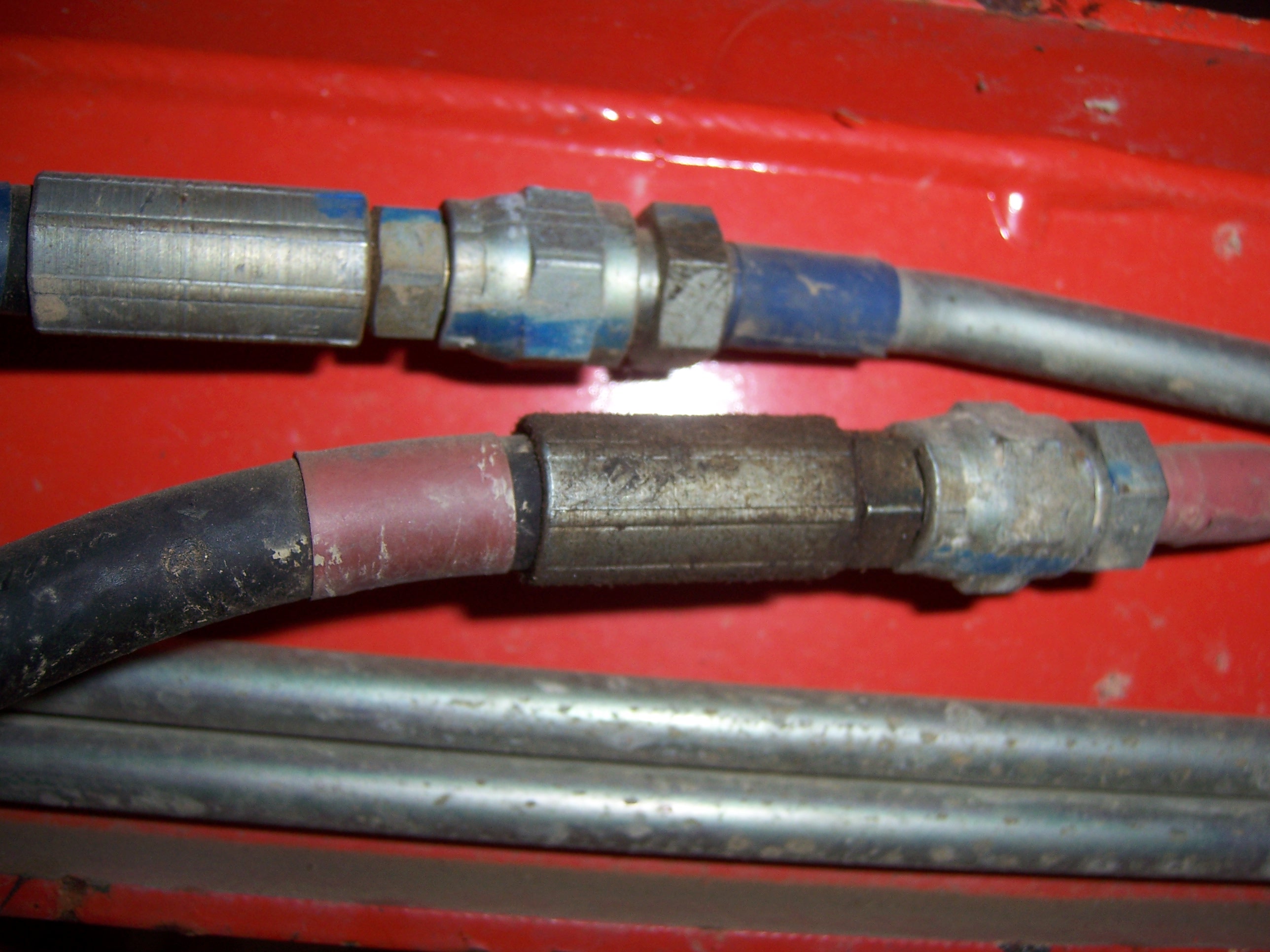

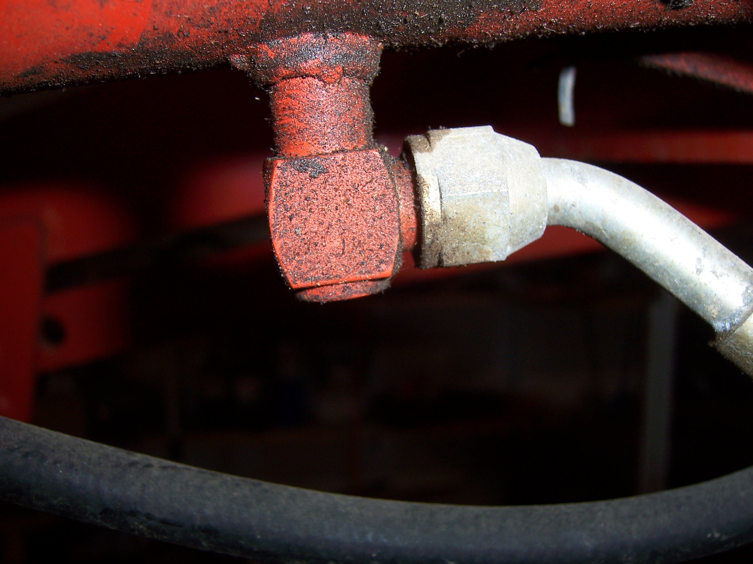

Can anyone tell me by looking at the attached pictures if these are JIC fittings? They are both on our BX23. The first is where the hard lines change to the hoses for the curl cylinder. The second picture is where the hose goes into curl cylinder.

I would say they probably are but maybe someone with a BX 23 will verify that for you. zman

Is this a test? Why not just take them apart and find out for sure? It's not like you will loose a lot of fluid. Take it apart and put it back together.

Agreed:thumbsup:
It is very difficult to tell the difference between a JIC and a NPSM swivel fitting without taking them apart and verifying

May be an ISO metric fitting. My MF has em on the loader. Not sure on the Kubota, I heard the loader was made in the US.

I would suspect they are 37 degree flare. The unknown is are the tubes american size or metric?
3/8 tube should use an 11/16 wrench on the tube nuts.

Thank you Roy,
I just checked and the flare nuts do take an 11/16 inch wrench.:)

The only way to identify your connection with 100% certainty is to disassemble it. That said, the fittings do look like JIC from what you've shown us. Especially the second picture, which appears to a male fitting and flared tubing with a tube nut and sleeve.
Once you've taken the fittings apart, they should like the ones shown here:
JIC 37ー Hydraulic Tube Fittings > Discount Hydraulic Hose.com
The next step will be determining the correct size, which you can do by measuring the threads and comparing with the reference tables here:
Thread Size and Identification> Discount Hydraulic Hose.com

In case the subject ever comes up again I took the hose pictured in the original post off and took it to a hydraulic shop. They are 3/8" JIC fittings on a 1/4" hose. With this information I hope to get the hydraulic parts ordered for my grapple in the next couple of days.
