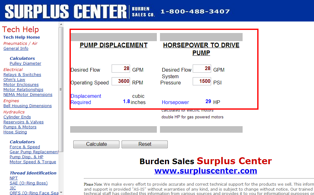

If you get anywhere close to the 1500 psi, you will stall the engine.
1100 psi will probably stall that 21 HP engine.
It is hard to keep going with this as things are not matched up. You are having to make adjustments after the facts, using what you have .
There are ways to make almost anything work, but you should not have to do that. We could call it bailing wire, or band aids.
This is not to different from matching all the parts for a log splitter from scratch.
From the pump matched to the engine, to the manual log splitter valve to the auto valves matched to the GPM's of the pump. Log lift perhaps as an aid to the work cycle.
Hoses matched to the ports or pump valve and cyl.
Selecting the filter and tank to hold the fluid.
Selecting the cyl to give the expected splitting times and the power in tons to get the job done.
If done right, there should be no add on's to help make the system work.

The lower relief cartridge setting should fix the stalling. I worked as a design engineer for about 10 years, not everything works perfectly the first time. You just have to keep working on it until the problems are fixed. All the new 787's are grounded because of a battery problem, somebody screwed up. All they can do is fix the problem and keep going.
/ Jerky project cylinder action
#90
I knew the engine was going to be underpowered for the pump but thought the flow for the motors was more important and the ram was way more tan I needed. The stall came as the biggest and only surprise. A1.3 or 1.5 ci pump would have worked but then a higher engine speed woukd be needed for the rpm range. In a perfect world I would have purchased a 450$ more engine for the 6 extra hp but I will not need that. Now I am paying 85$ for these two parts? Theseparts woukd have been needed even with a larger engine.
Yes, we learn from mistakes as most do. In the hundreds of choices and decissions made to design and build this from scratch as my first hydraulic and gas welding project, I will not appologize for making this mistake. I also enjoy this learning process, it beats the h. Out of my formal classes!
I just went to the tech part of the surplus center site that JJ just posted!
Nice resource, if I had seen it before sellecting I may have gotten a 1.3 ci pump but at least I see it now.
