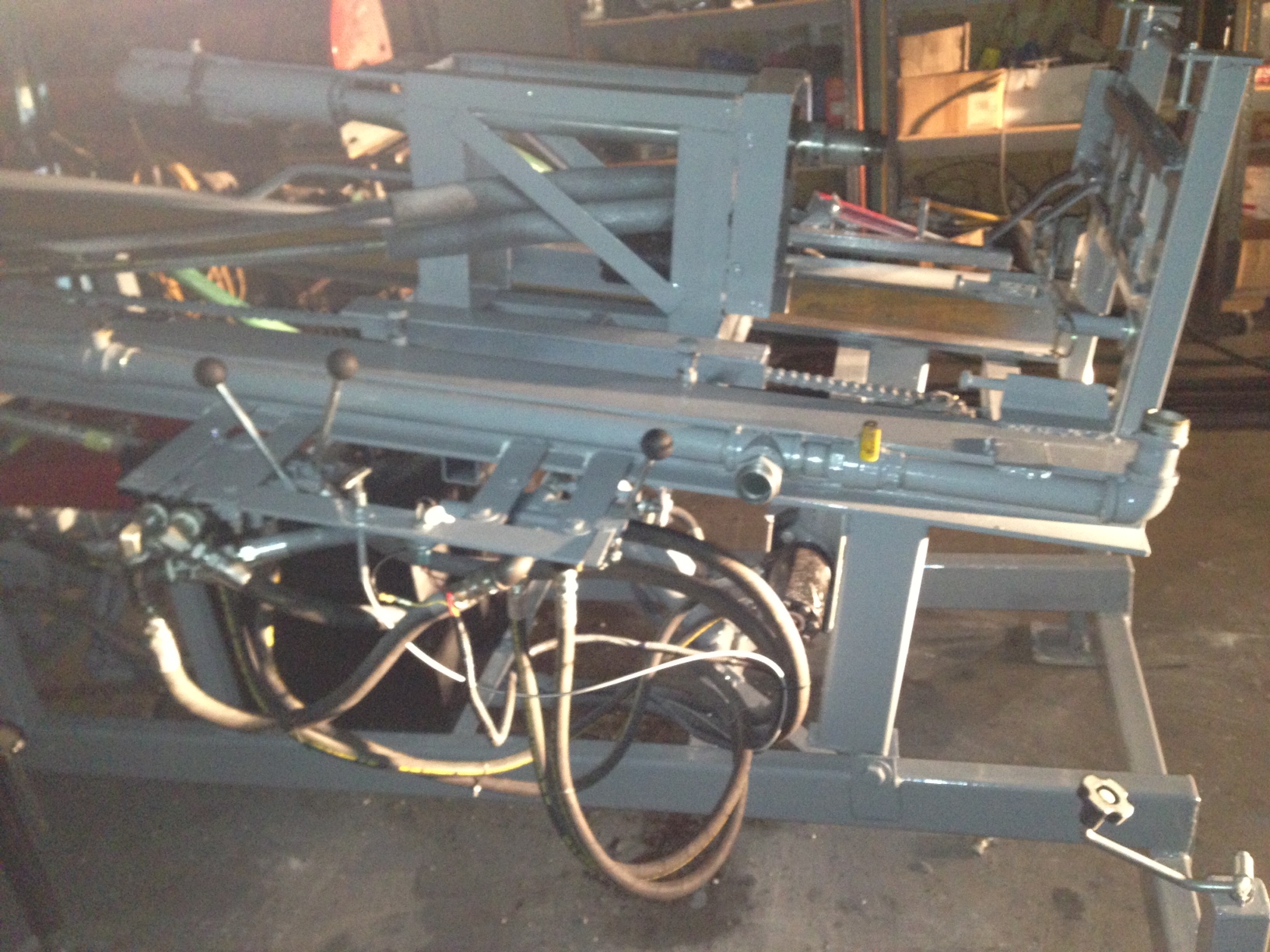

/ Jerky project cylinder action #66
By having the motor running yarg is limiting the pressure available to the ram to the back pressure developed by the motor. If the motor was under load there would be more pressure available to the ram.
/ Jerky project cylinder action #67
bigdeano,
I think you aced it! Better answers than mine but the same concepts. I said in the beginning that I am a beginner and it shows but I am a quick study most often? I am not as much a technician in my terms but I do get the ideas.
My biggest confussion is on the proportioning valve option. If the excess flow is or is not subject to a pressure relief valve in such a unit? No matter whether I go to such a modification or not, I would like to know----the learner in me. I am not ashamed of learning from anyone who offers information. Healthy for me.
Technically, the excess flow does go thru a relief valve, but the pressure of that valve is controlled by the flow in the controlled flow port. The flow out the excess flow port has to be restricted to develop pressure for the controlled flow port, otherwise all the flow would just go to the tank, if that's where it's hooked to.
The excess flow port can be used to power another circuit as well.

I think the problem may be more about flow and (lack of) flow capacity then "pressure".
yarg, what happens when you extend and retract the lift cylinder at both full throttle and at an idle with the lift control valve at maximum both ways and also the same test "feathering" the lift control valve?

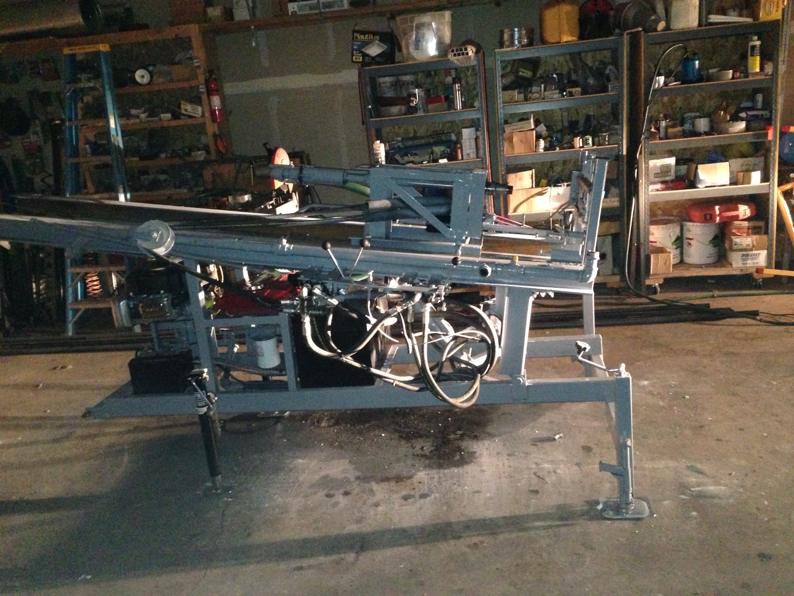

Well, no matter the throttle point the engine is stalled. The valve would just bearly be able to handle the flow at high RPM and the pressure at any speed is such that it would reguire HP to work because the ram volume is so small that it fills or looks full to the flow as soon as you trigger it.
Feathering is almost impossible. The only way I could get good action was running a motor ( taking most of the flow away to the tank ) while valving the ram. In taking most of the flow away, I could throttle the flow to a lower pressure than the spool relief valve. Given this info. I decided that my first attempt at a change is to get the low pressure relief and a needle for flow control?

If I order one of these, I will get the one that is 1.5 GPM as I do not need any speed on this ram, just even slow flow. I will look into it tomorrow.
I would likely do this on the input side of the ram spool. Pipe the working port to the spool and the excess to the tank. This allows full flow at all times to go to motors and then after those, a split flow to the ram spool?

Hmmmm. Over the years I have operated a lot of hydraulic equipment from tractors on the farm to radial arm diggers and bucket trucks and I never had an instance that matched your situation. I have never encountered a hydraulic valve that I couldn't feather although some were indeed touchy.
Trouble shooting can often be facilitated by isolating sections of the system.
Have you tried using a different hose than is connected to the lift cylinder to make a loop between the in and out ports on the lift control valve? If nothing changes, you have eliminated any problem with the cylinder and hoses and the raising/lowering mechanism but if everything works great you've narrowed it down to the lift cylinder and hoses and the the raising/lowering mechanism.
The next step would be disconnecting the ram and cycle it in and out. If things are great then you might have a bind in the raising/lowering mechanism. If things remain the same look for a problem with the hoses or cylinder. Is there an unseen kink in a line? It's rare but sometimes the inner lining can become detached and fold over on itself causing a severe restriction to flow.
If nothing changes after the loop test, I would run two open ended lines from the lift control valve to a very clean bucket to catch the reusable oil and see what happens. If you still have a problem I would have to think it's in the valve itself and it would likely need replacing to make sure.
If you can't narrow it down after jumping through all those hoops...well, as they say, we'll cross that bridge when we get to it. :D
