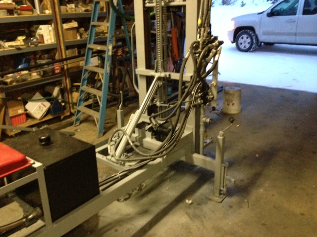

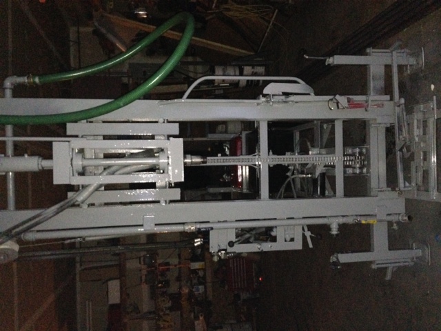

/ Jerky project cylinder action
#40
photo (6).JPGphoto (4).JPGphoto (1).JPGGentalmen,
I just got home and have taken a few pics for you all to examine this project.
One will show the drill end with the mast up and head about middle.
One has the unit folded down but you can see the hinge point is back from the rear of the machine and maybe you can spot the ram location and understand the it is a short pivot and requires power up and down due to the pivot geometry. This allows a worker to keep the unit set in place and tilt the mast and head away for well work and still not lose the allignment.
Hope these help the final fix?
Gray
Opps, I included the pic that shows how I worked on it in my garage that was 8 inches short rather than be outside in 10 below for weeks:))))))) Simple cieling patch!
