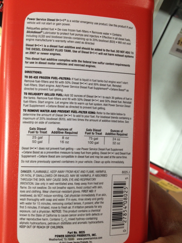

Hello ksbowhuner I have went the extra mile and while I was getting fuel I checked out the precautions and directions of power service diesel 911. The picture above is the back of the bottle. I myself am a heavy truck technician but I also work on other equipment and am very interested in learning the correct procedure to completing task the right way.
Note it says on the bottle the safe mixture is 50% d911 to diesel fuel inside the fuel filter. If it were me, I would remove the fuel filter, replace with new fuel filter and add between 1/3 to 1/2 D911 to the filter. Add the rest to the fuel tank if any is left.

<img src="http://www.tractorbynet.com/forums/attachment.php?attachmentid=359593"/> Hello ksbowhuner I have went the extra mile and while I was getting fuel I checked out the precautions and directions of power service diesel 911. The picture above is the back of the bottle. I myself am a heavy truck technician but I also work on other equipment and am very interested in learning the correct procedure to completing task the right way. Note it says on the bottle the safe mixture is 50% d911 to diesel fuel inside the fuel filter. If it were me, I would remove the fuel filter, replace with new fuel filter and add between 1/3 to 1/2 D911 to the filter. Add the rest to the fuel tank if any is left. I purchased a tool box and tools from a tool man in my area and make regular payments. I saw an opened bottle of diesel 911 on his truck. He made the comment that he uses it as a regular winter anti gel and conditioner. NOTE as it says on the bottle this is not the correct use for the product. Although it de-ices and liquifies fuel instantly it DOES not work as an anti-gel to keep fuel unthawed permently. It will unthaw the wax that has formed but it will not keep the wax unthawed, it will let it freeze/wax over again. It's best to apply this product in the fuel tank and or the fuel filter and also apply an anti-gel formulated chemical. As said Howes and the power service white bottles are just great products! I am familiar with someone who had a dodge one ton pickup truck, and a 5.9 common rail cummins engine. The injectors were going out on his truck and it was a rather costly fix. In order to get him through the next few months of winter he would add a bottle of Diesel 911 every single fuel tank. His injectors would not atomize the fuel properly for a complete burn in cold temperatures. It was a hard starting truck. What did the diesel 911 do in this case? It lowered the combustion temperatures required for the fuel to ignite. For instance adding gasoline to diesel lowers the ignition point. It's something I do not practice doing. I do not add gasoline to diesel fuel. It's an unsafe practice. The vapor of diesel fuel no 2 is ignitable between 140 and 200F roughly depending on blend etc. Gasoline's vapor is ignitable -45F. If injectors cannot properly atomize the fuel in cold weather to start, you may need to lower the ignition point. This is normally correctly done with a blend of number one and number 2 diesel fuel mixed. My friend was using diesel 911 to lower his ignition point of the fuel. Did he cause any fuel system damage? I'm not sure. Once he had the money was he able to install fuel injectors and the engine ran like new again? Yes. Didn't know if you wanted a long explanation but there it is! If you ever have to use diesel 911 use it correctly and add fuel anti-gel shortly after. Enjoy
Edit: The lower the ignition point of the fuel, the colder temperatures it can safely be used in as when the ignition point lowers so does the cloud point and gel point. As you lower the ignition point you raise the cetane number.

Wow, i did not know that. I 'assumed' that 911 was 'extra strength' Power Service (white bottle)
That explains why we can use 911 to get the CTL going when it gels up, but after a while it will bog down again and lose power.
We even dosed a 100 gallon transfer tank with 911 thinking that would be good for winter use.
From now on it will be...
911 for emergencies only and also always add Power Service to the fuel when below 20 - 25 degrees.
