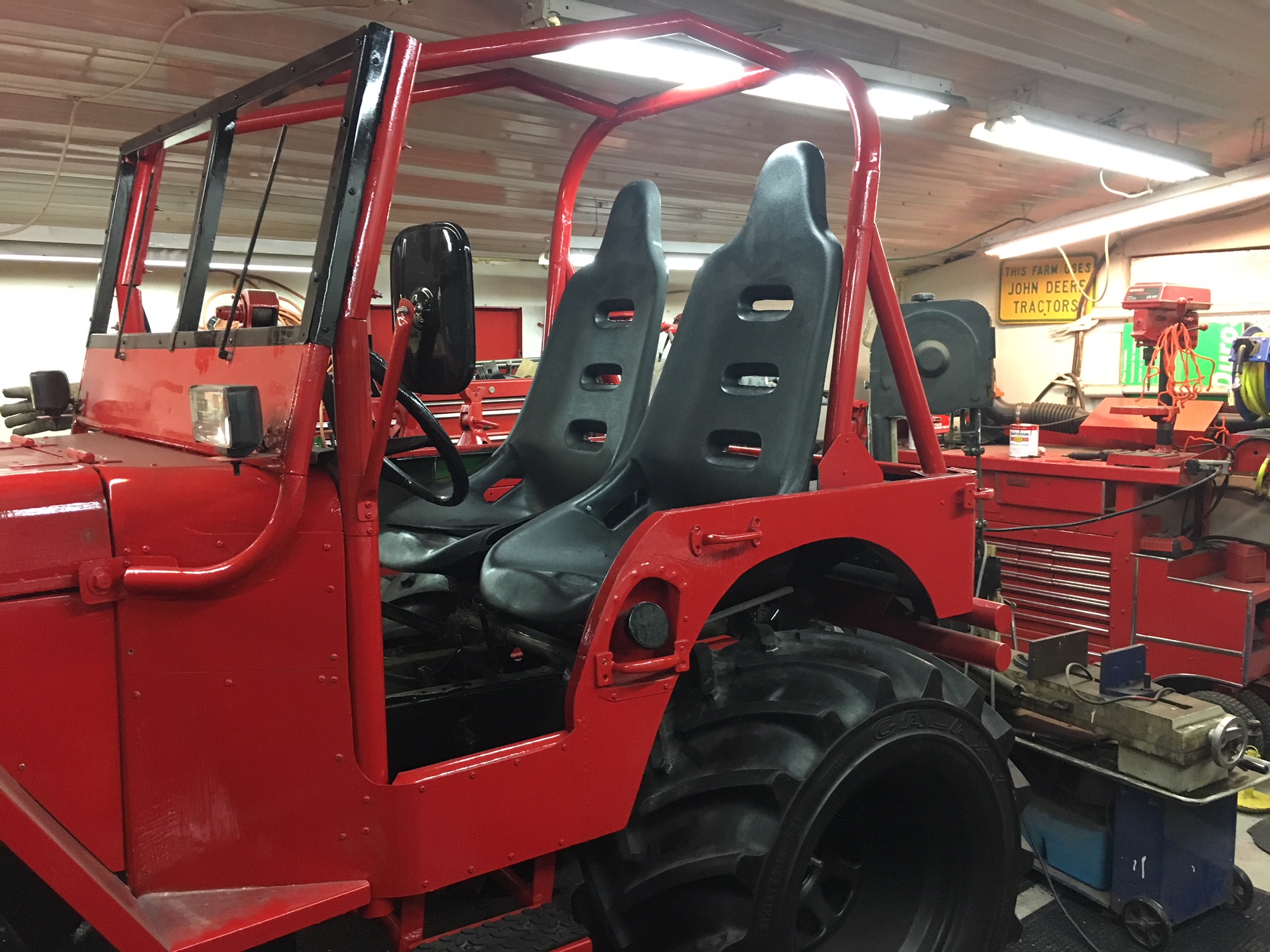

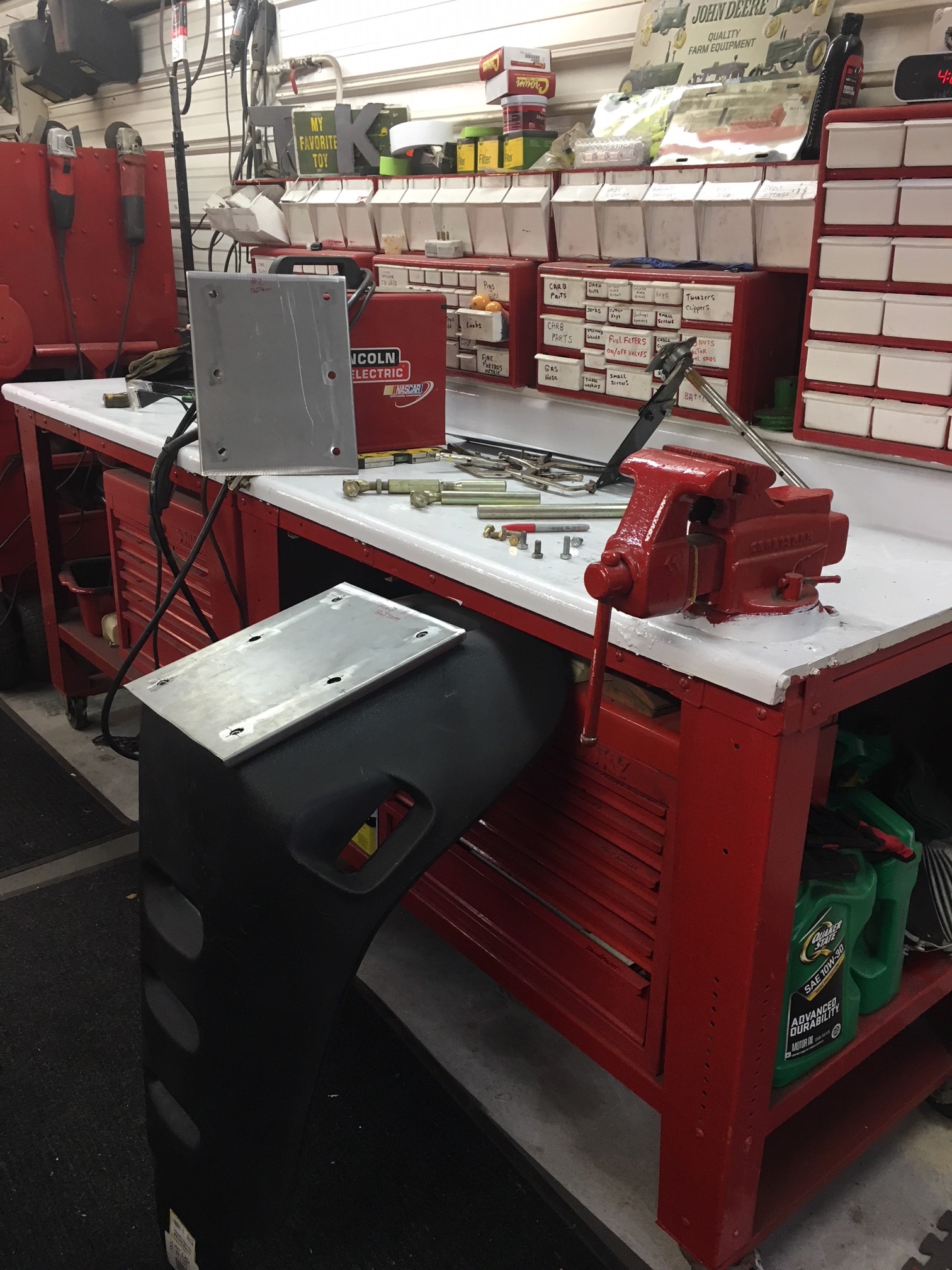

Yes it was a Wheel Horse 10hp riding mower. The mower was junk and I bought it for $85.00 . I puttered on the motor one afternoon and got it running great. I put big tires on it and eventually made the grader, ha,ha. Today I trimmed a bunch of sheet metal from the inside of the Wheel Horse Go- Cart. I fabricated all new frame work to support the two high back seats. Going to be a tight fit and I already trimmed a inch off the sides of the first seat. I also built the mounting brackets for the bottom of the seats. IMG_9474.JPGIMG_9475.JPGIMG_9476.JPG

I got the new seat frame work welded in place and got the seats mounted for the first time. It's a tight fit but I like them. I decided this week to work on the Mini Loader bucket. I am adding 16" to the bottom of the bucket and several inches to the sides. We get a lot of light fluffy lake effect snow and it would be nice to be able to move more of it each pass. I saw this cool bucket on line today , Sweet. IMG_9491.JPGj.jpg

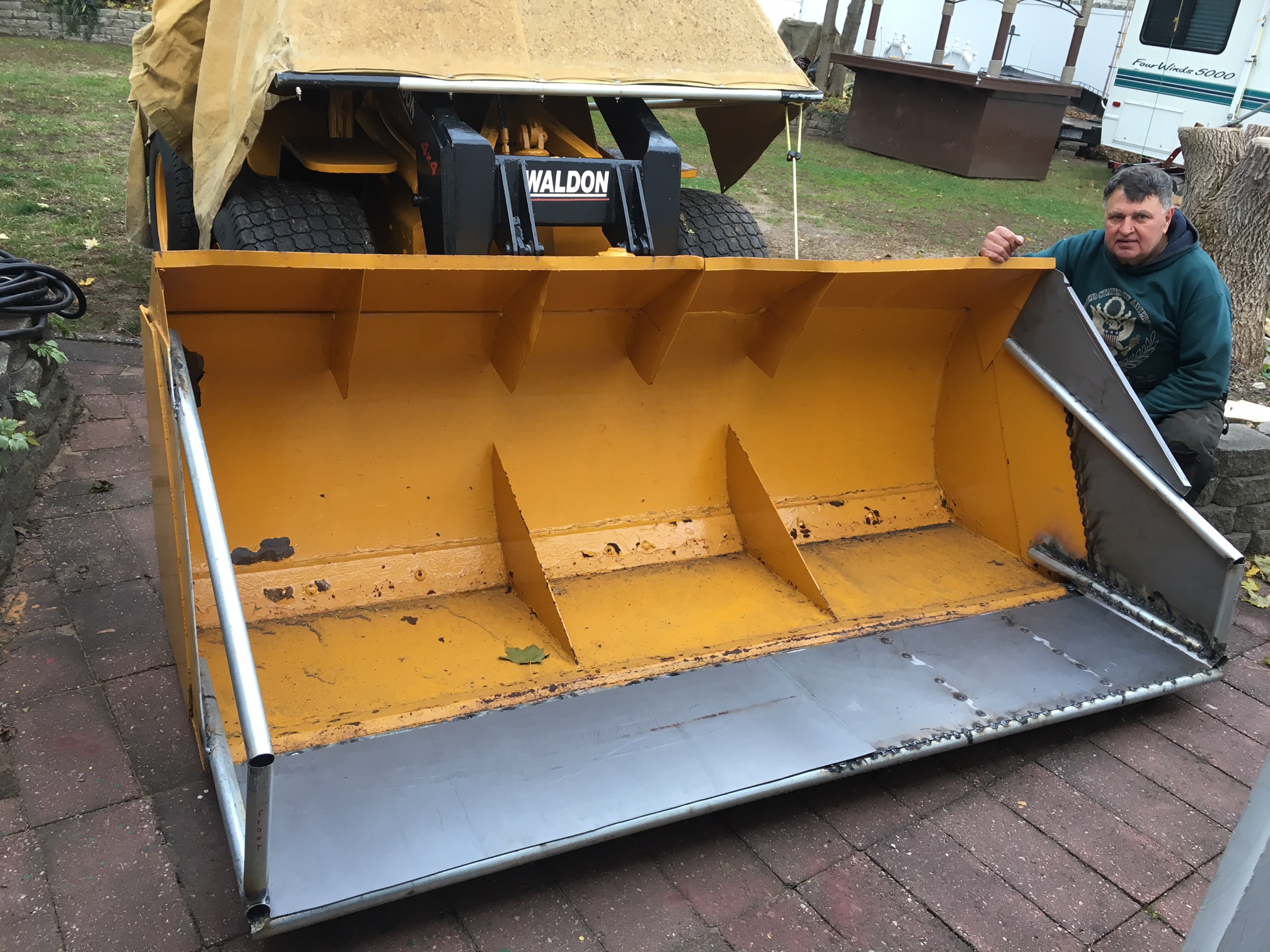

Taking a break from the Mini Jeep project to work on the mini loader bucket extensions. I'm trying to keep it light as possible. I don't actually plow with it , mostly move the snow piles from the front to the back yard when the snowbanks get too high. I am very limited where to stack the snow in front. We get 160+ of snow every winter so the banks get high and it is dangerous pulling out on the main road. The bucket looks rough yeat but will look much better when finished.IMG_9494.JPG

Taking a break from the Mini Jeep project to work on the mini loader bucket extensions. I'm trying to keep it light as possible. I don't actually plow with it , mostly move the snow piles from the front to the back yard when the snowbanks get too high. I am very limited where to stack the snow in front. We get 160+ of snow every winter so the banks get high and it is dangerous pulling out on the main road. The bucket looks rough yeat but will look much better when finished.View attachment 577099
Is this just going to be a removable extension for the bucket or are you welding it on?
/ JEEP GARDEN TRACTOR PROJECT
#65
The new extension will be welded on. I have forks for it for summer use. This bucket is 100% snow use and mostly lake effect snow that is light and fluffy. I have used the smaller bucket for 7 years and it is going to be great to have this larger bucket. I will be curious if I will be able to carry a full bucket of heavy wet snow without lifting the rear of the machine .
If not it will still be nicer filling the bucket with the larger bottom floor even half or 3/4 full .

Snowing the last two days so back in the workshop. I cut out more of the center tunnel today and now I have plenty of leg room . But the drive belt shield will stay leaving a little less leg room on the passengers side. I finished the bucket extension project and I am excited to try it out.IMG_9521.JPG

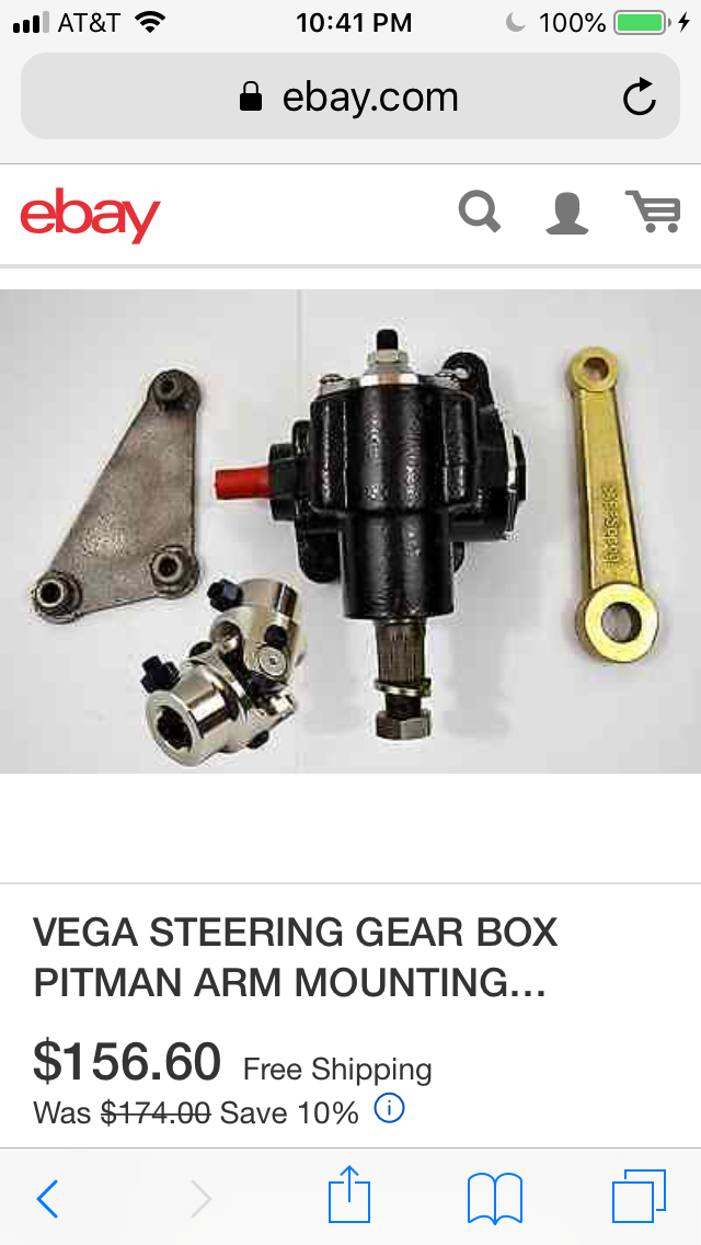

My new 17" steering wheel arrived today and that should give me more steering leverage. But if it still steers hard I may get a Vega style steering box like the hot rod guys use. I trimmed the Wheelhorse dash and attached it to the new dash panel. I also attached most of the wiring left over on the side . That will get a cover to enclose all that.IMG_9539.JPGIMG_9538.JPGIMG_9534.PNG

Steering design FAILED !!! This afternoon I got everything connected together for the first time and it did not work smooth at all. Too many u-joints and too tight of angles. So I started cutting out metal from the frame and tomorrow will start over. This time the geag box will be in direct alignment with the steering wheel. This will eliminate most of the u-joints and angles. I still think it will all work. But if not , then I will order the Vega parts. It's always more fun to make things work without having to spend a bunch of money.IMG_9555.JPG

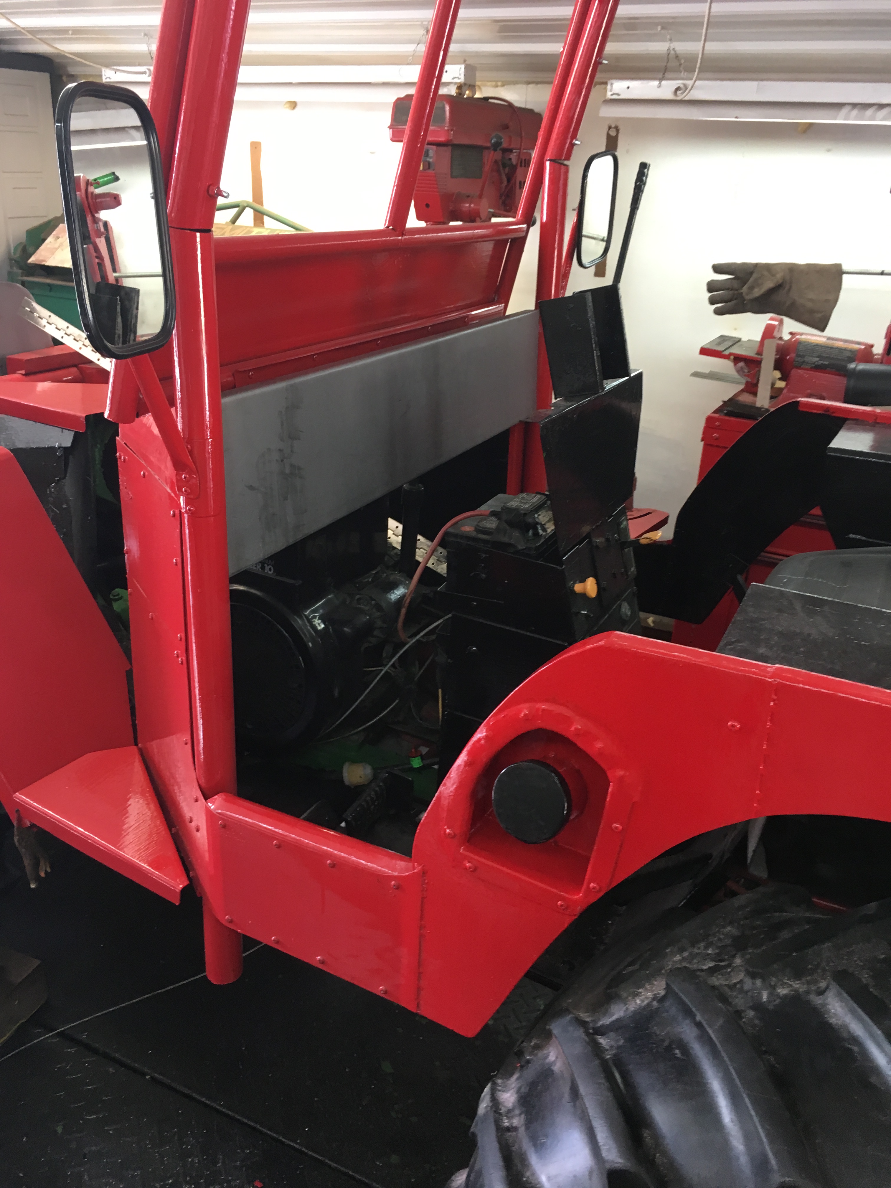

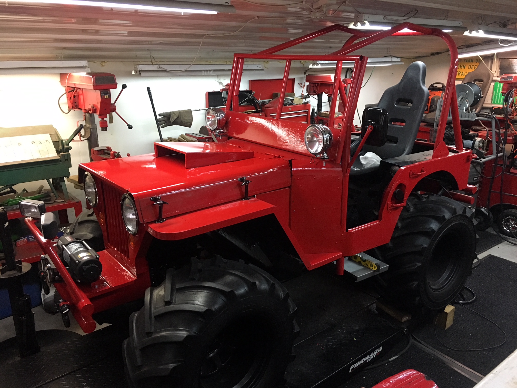

#79
The new battery box is built and attached along with the battery. The new gas tank brackets are also installed along with the tank. You can see the vertical mounted muffler mounted behind the right side fender. And yesterday I mounted the choke and throttle cables on the dash for the first time. Now back to the wiring to see if I can get it running . It has been a excellent running little engine.IMG_9573.JPGIMG_9572.JPGIMG_9571(1).JPG
