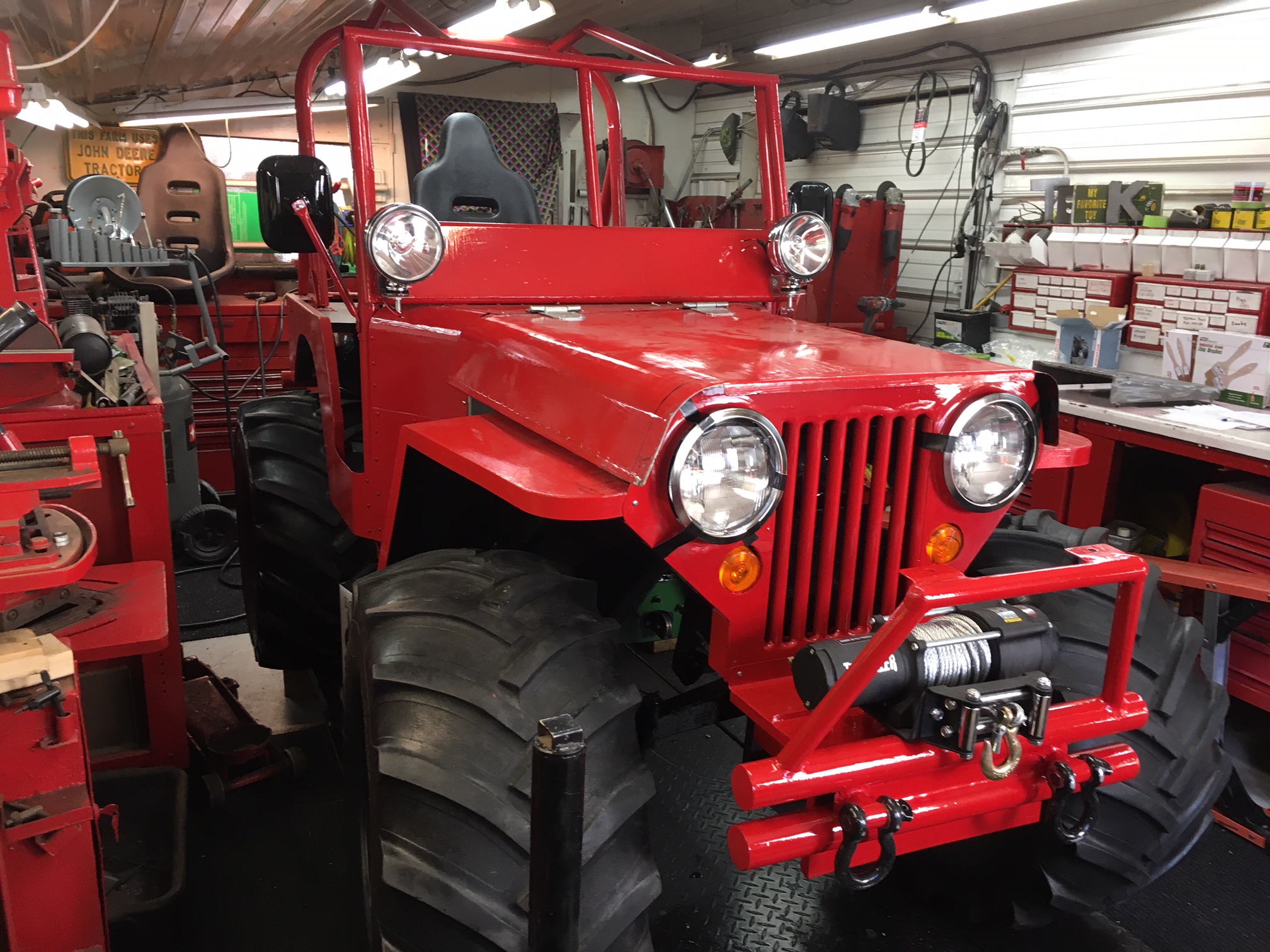

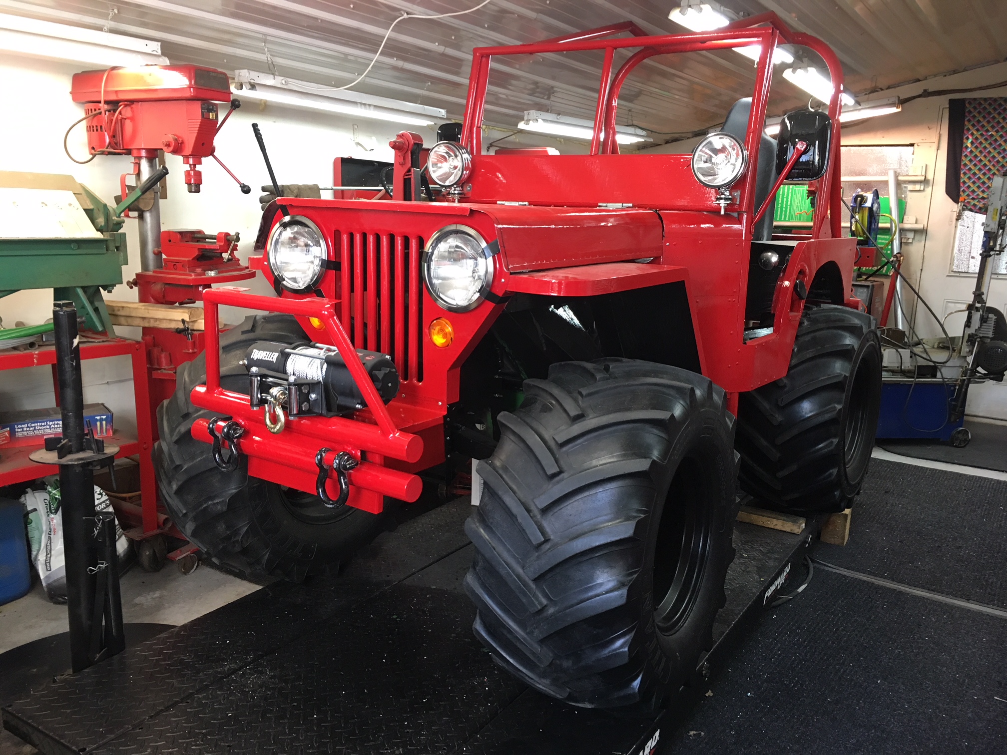

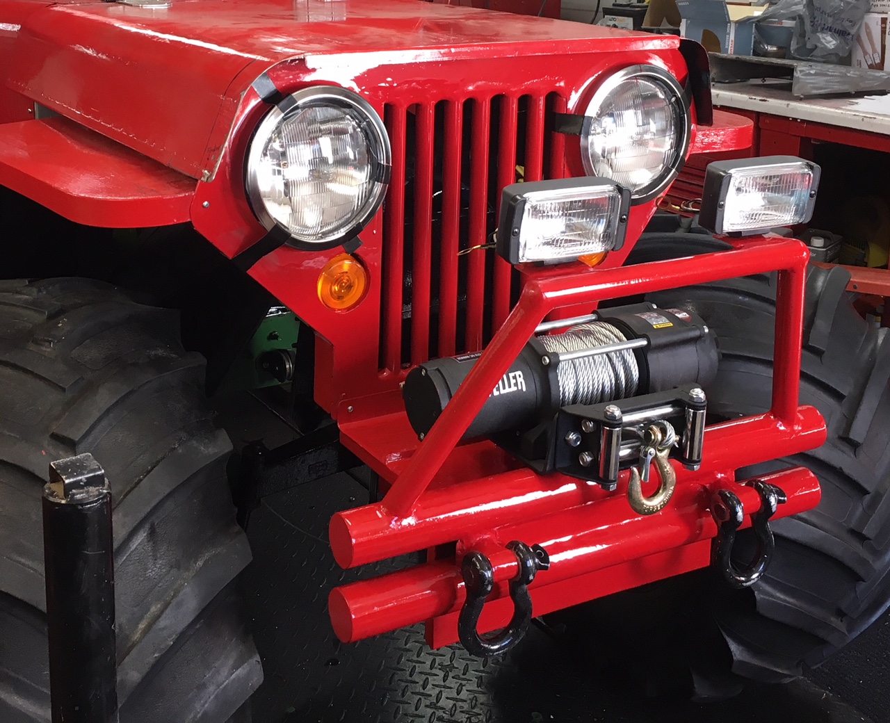

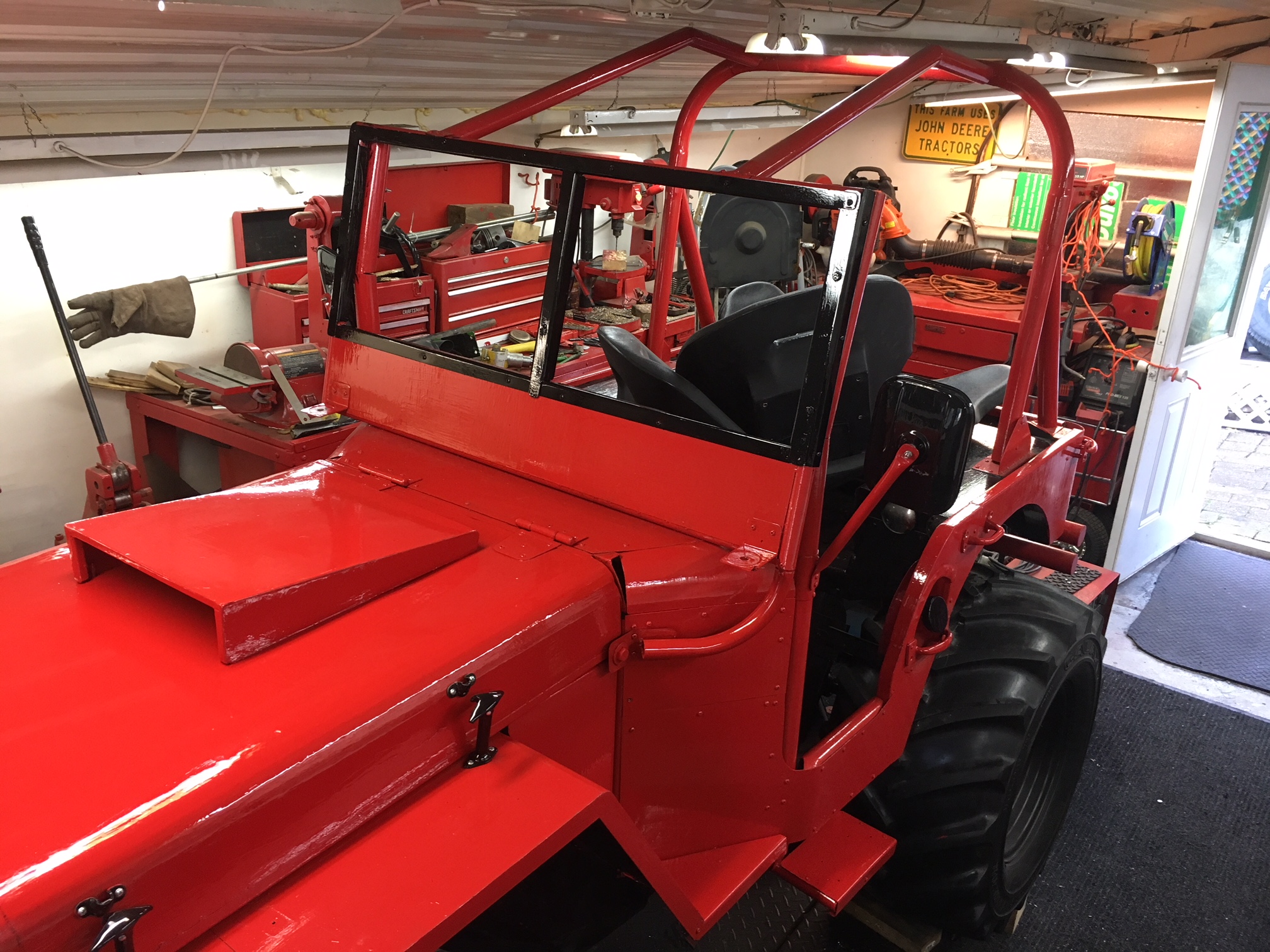

I did not get to the shop much yesterday but I did get the new windshield parts painted and the new step. I also slapped a new coat of paint on my main workbench as it was looking pretty bad. I decided the hood scoop is coming off the little Jeep go cart. I do not like how it looks. I want it to look a little like a old Willys flat fender and that takes away the look too much. Also the big spot lights by the windshield are coming off too as I don't like how they took away the look. But I do like the front winch lights and front lights. jeep 1.JPGjeep 2.JPG
/ JEEP GARDEN TRACTOR PROJECT #43

I am not happy with the overhead roll bars either. They will probably be altered. I got to be happy how it looks overall or I need to change it. This is what I love doing so it isn't any problem. That is why things are painted with a paint brush , ha,ha. I can cut a hole or weld something in and grind it, sand it do a little body work and get the paint brush out and paint it in the same day . That makes it nice and less complicated. No showroom paint jobs here, ha,ha,ha. I have done a few nice smooth spray paint projects but the overspray is terrible. I do sand the paint and wheel it out eventually and it does shine ok but no problem getting scratches . :cool2:
/ JEEP GARDEN TRACTOR PROJECT #45
wait, what's wrong with the roll bars??.. safety should come first!.. the flat section is for head clearance, the section that angles down is to connect to the frame, so what is wrong?..

I'm keeping the roll bars , I just may have to tweak the top two bars after I get the seats mounted. They may look too tall , not sure until I fit the seats. They may be ok too ??

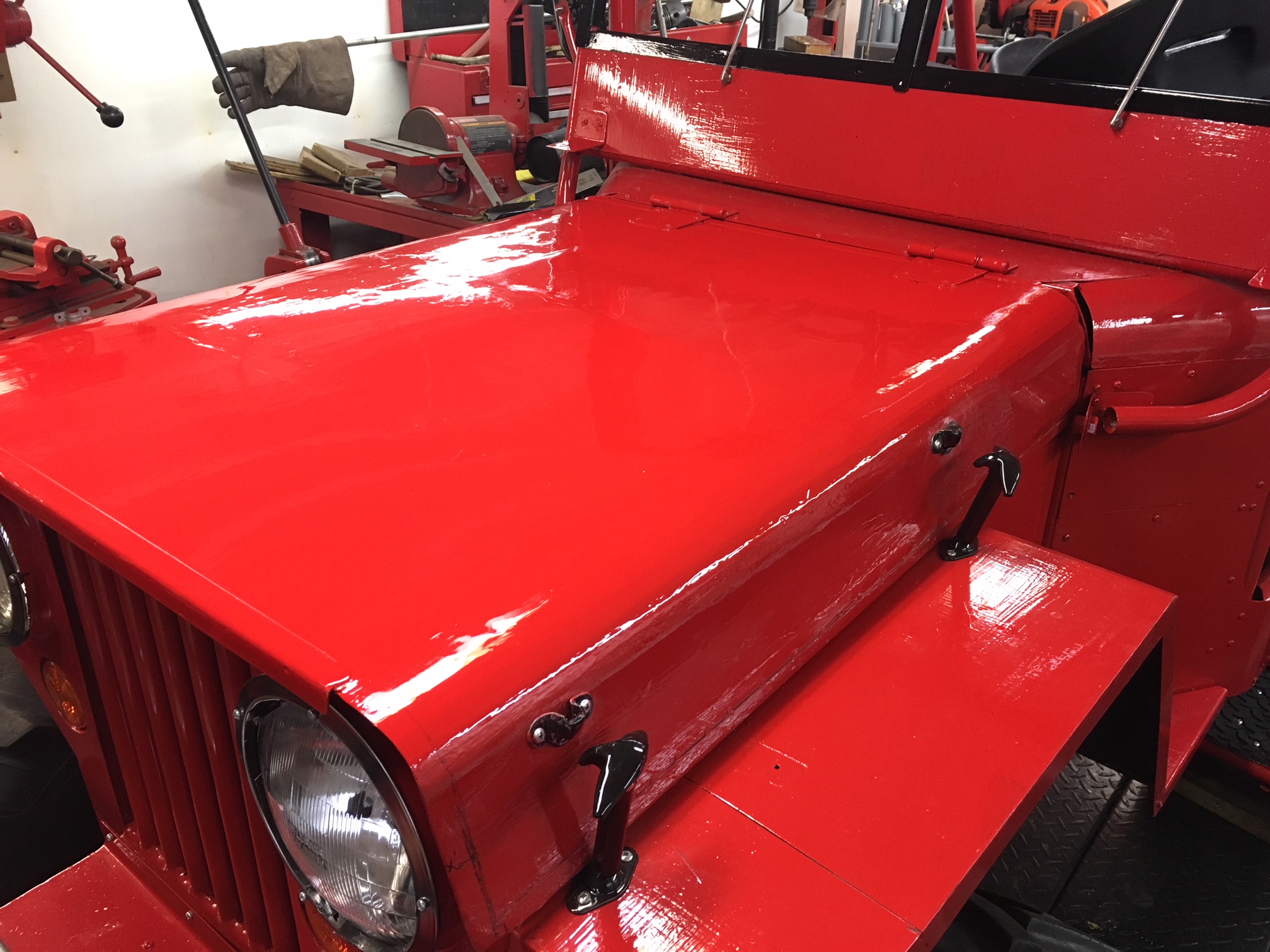

Painting these projects with a brush is crude I know , but it really is so easy. Today will finish spot welding the piece in the hood back in place, then I'll do the body work and get the paint brush out and slap a nice coat of paint on it . No worryies about overspray or paint thinner or cleaning the guns. No problem matching the paint either, ha,ha. I painted the rims black yesterday that were on the back of the grader with the 33" tires. These will be used for the Jeep go cart matching trailer project. Also the round fender sulky has never been used and will be tweaked . It has brand new spindles and hubs that will be great for the trailer. The trailer should get built this winter too . Two very fun projects.jeep 1.JPGjeep 3.JPGjeep 4.JPG

I got the body work on the hood and got it painted yesterday . Nothing fancy but looks so much better with no hood scoop. I also built the right side step , the right side panel and the right side fender step.jeep 1.JPGjeep 2.JPG

Your Jeep looks like a lot of fun memories. Today I should get the outside of the Wheelhorse mini Jeep / go cart roughed in . I am very happy how it looks so far. I made the wooden blocks for the hood but not sure if I will put them on or not. Here are two pics of two styles of trailers I may build for the Jeep. I have much of the materials so it won't cost much. The whold Jeep project has been pretty inexpensive. The winch and the tires and the sheet metal were the biggest expenses around $1,200.00 total. That pretty cheap for all the enjoyment I have had the last few weeks in the shop. The little 10 hp engine won't pull much but its another great little project for me to putter on this winter.IMG_9361.jpgIMG_9365.jpg

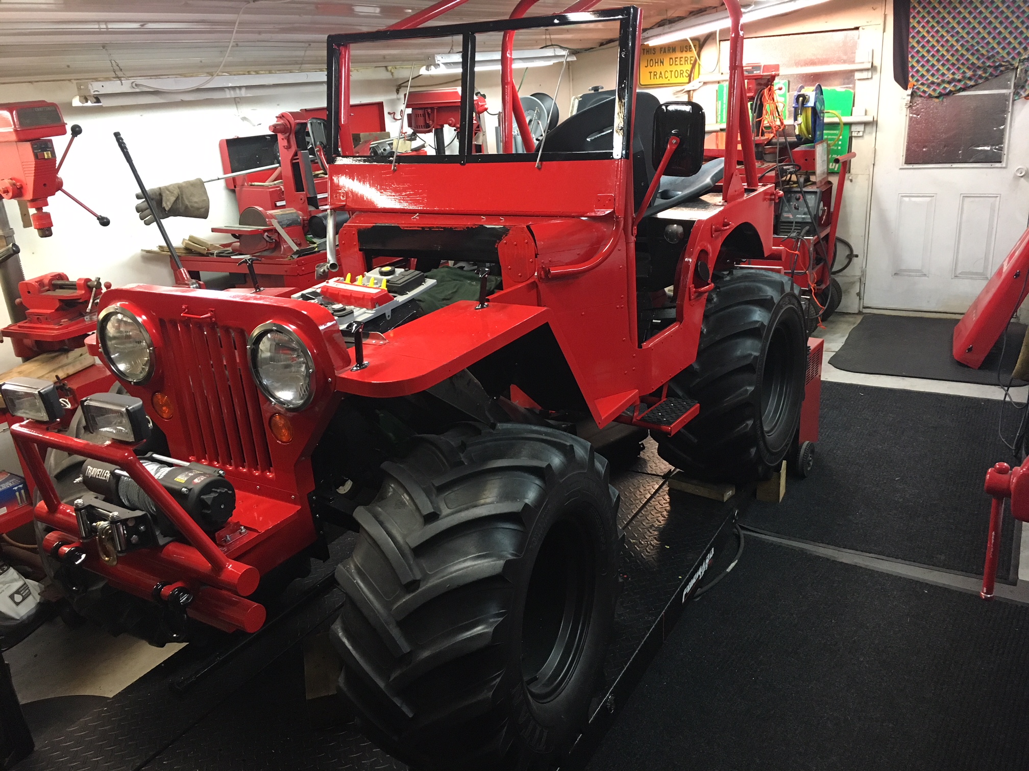

Yesterday I worked on the three worse spots on the go cart body. I cut out some metal and bent it to fit the wholes and welded them in place. Then I did the bodywork and slapped some paint on them. Looks much better.IMG_9391.JPGIMG_9392.JPGIMG_9395.JPG

Now with the outside of the Wheelhorse Jeep roughed in I can slow down and do the inside this winter. Also I will rough in the little matching trailer in the next couple weeks . Once that is roughed in I can work on that this winter too. A lot to redo inside the jeep , center console all has to come out for two peoples feet, exhaust has to be redone, steering all has to be redone, electrical to new dash , under the hood cut more old metal out for new battery box with big battery. Possibly the gas tank will go under the hood too, ?? Lots of fun for this winter. It sure looks different than four weeks ago. Here is my Cub Cadet Powered Gator I tweaked a couple years ago. My grandson loves it. One lever to operate it all with hydrostatic drive.DSC_9916.JPGIMG_9389.JPGjeep b.JPG

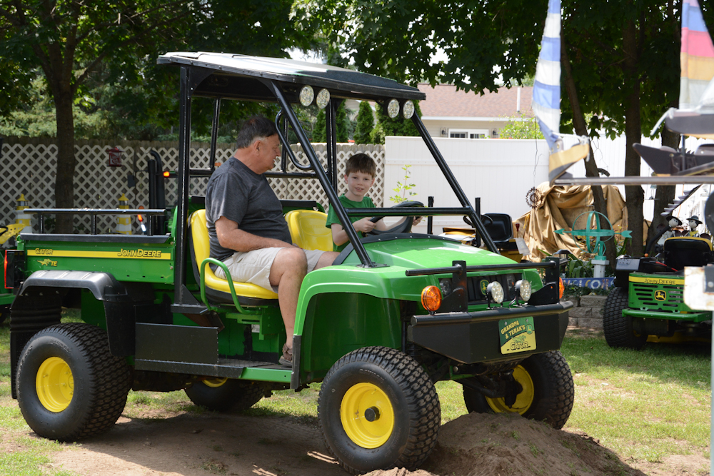

The gator was a lawn mower???? Wow - you have some amazing skills and vision! Totally impressed!
Please keep posting pictures of your projects. Its very entertaining and inspiring!
