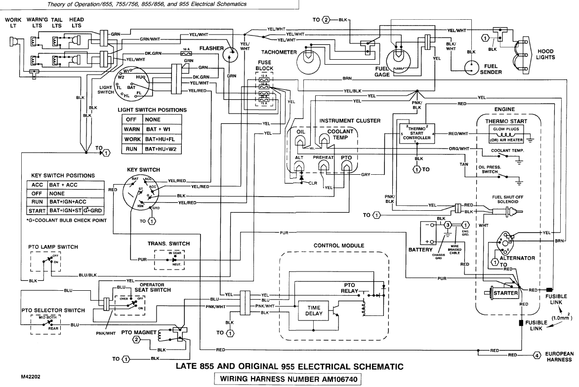

Another update. I removed the starter and had it tested and it was fine. I agree looks like a connection issue. Does any one have a wiring and or fuse diagram?
/ JD855 wont start #7
