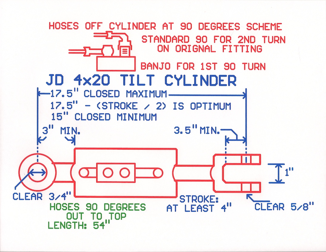

After a delay of game (see http://www.tractorbynet.com/forums/john-deere-owning-operating/162706-new-jd4520-cab-destroyed.html) I've got the TnT back on track. I had CCM make a cylinder to my specs. I've attached the drawing I sent them. The final closed length of the cylinder (center hole to center hole) worked out to be about 15.25", which is fine. They blew the clear 3/4 at the top, so a brass bushing had to be drilled out to get it to fit. They made both ends 5/8".
You can see where the side tilt cylinder (green) has the lines coming out of the DPOCV at 90 degrees by using banjo bolts. There is then this incredible arc of hose that comes down to the rear of the tractor where the plate that used to be at the front for the loader has been re-located. The hoses do 90 degree turn into the QCs (need better pix of this....). I suspect that I'll play with this a bit and shorten the hoses so they just rest on above the SMV sign holder when the 3 PT hitch is at it's lowest. There isn't any good way to route the hoses without having them crunch in on something, so while the big arc is funny looking it is functional. Might also flip the cylinder 180 around so the hose lines come out closer to the tractor. This is where Steve's (jenkinsph) method of in line QCs is a bit more accommodating.

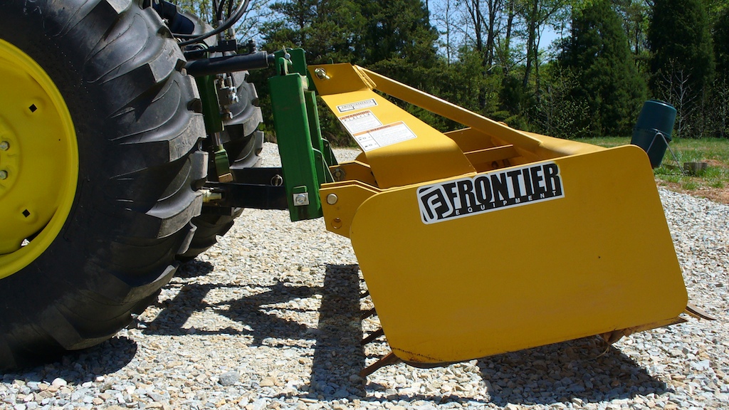

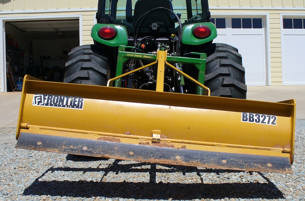

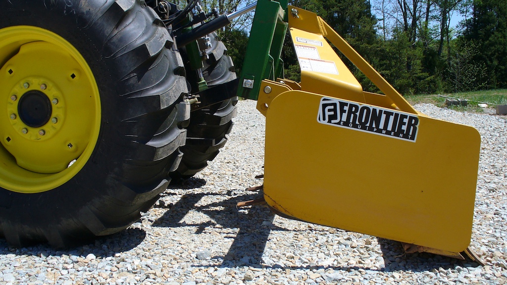

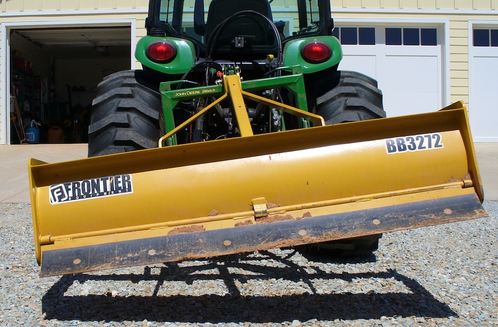

An update to round out this thread. I had the box blade on my JD 4520, and took pictures of the range of movement with the TnT/iMatch. The stroke on the side cylinder is 4". The adjustable arm is out .9 "
I'm just organizing things in the new tractor garage, in about a week I'll start moving dirt with the boxblade and landplane and get a feel for it all.
I hear everyone likes pictures... :)

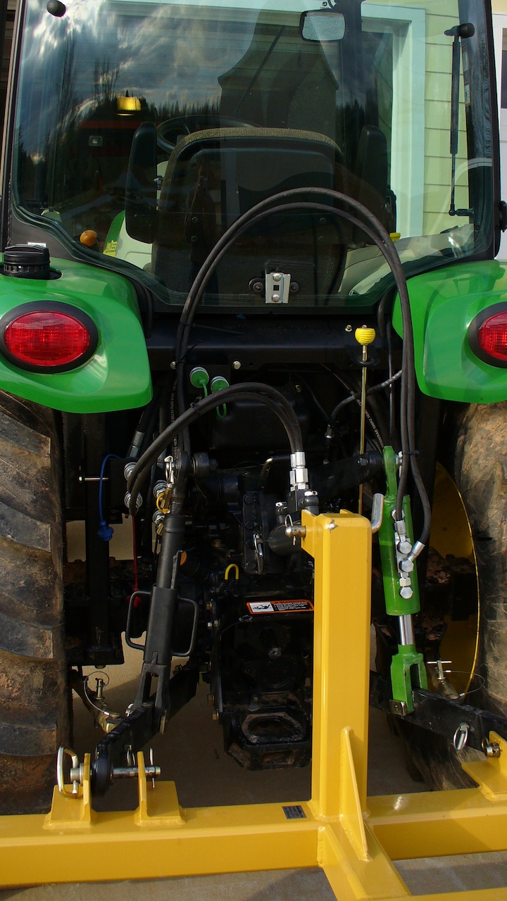

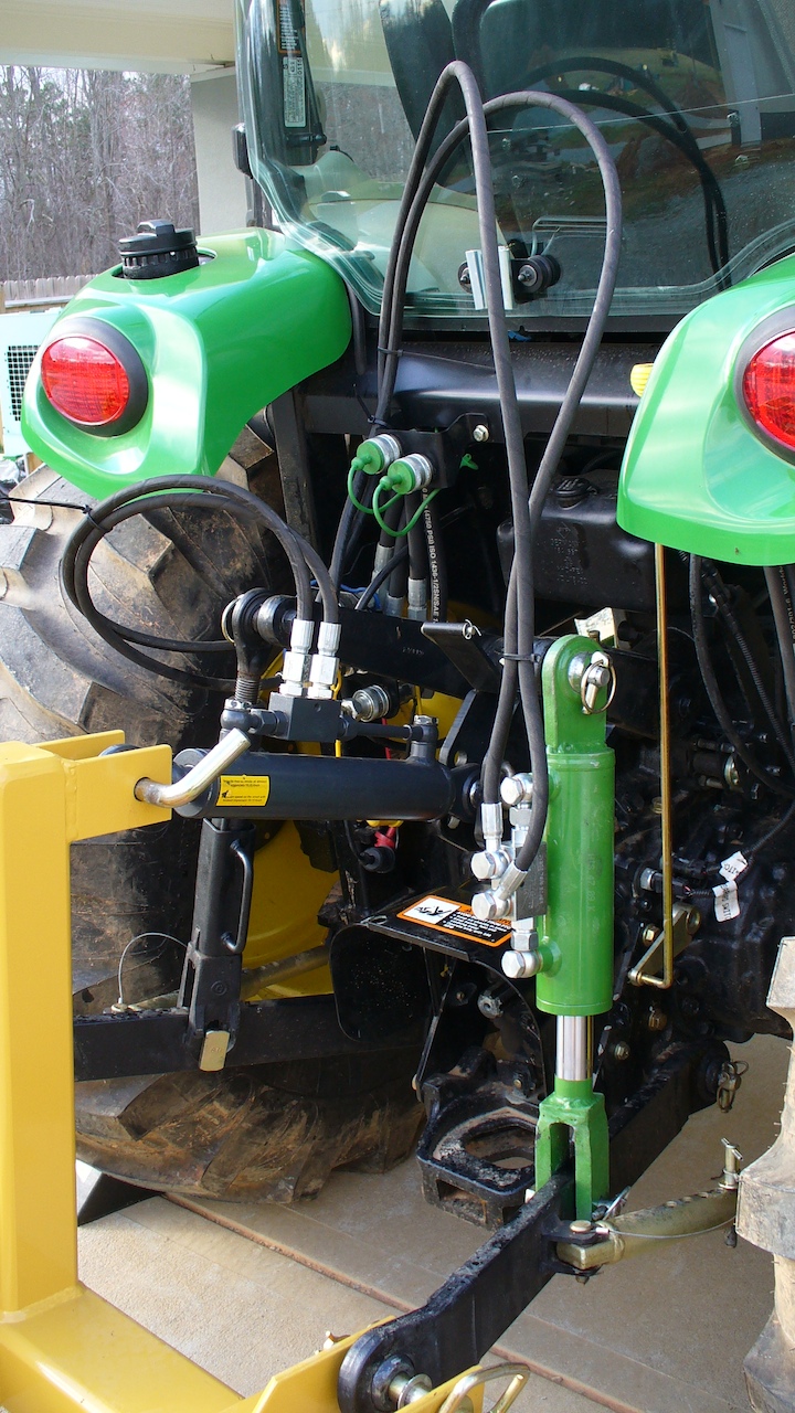

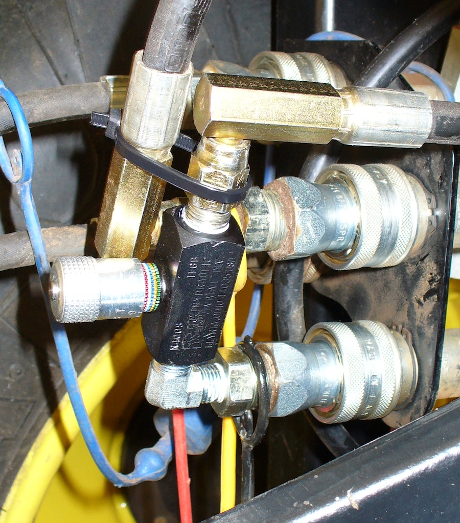

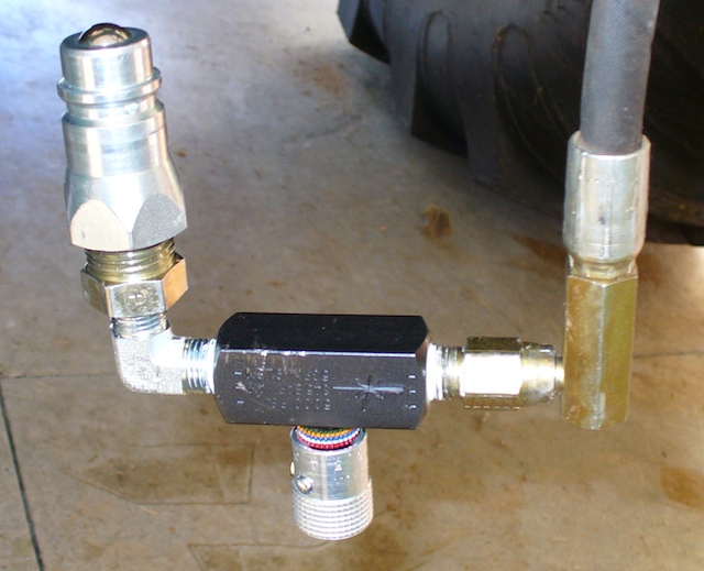

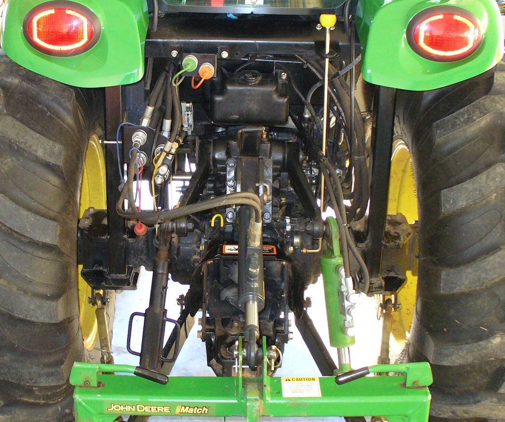

Another update: Today I added a needle valve to the tilt cylinder, and re-dressed the hoses so they are not up over the glass.
The 1st pix is the needle valve and QC. The next pic shows how the hoses route out of there. They had to be dressed just right to avoid hitting the lift arm.
The last pix is the finished product, the new rear of the tractor with the TnT. The needle valve is installed, and the hoses now run below the washer fluid tank and not up on the rear window. So now it's easier to open the rear window.

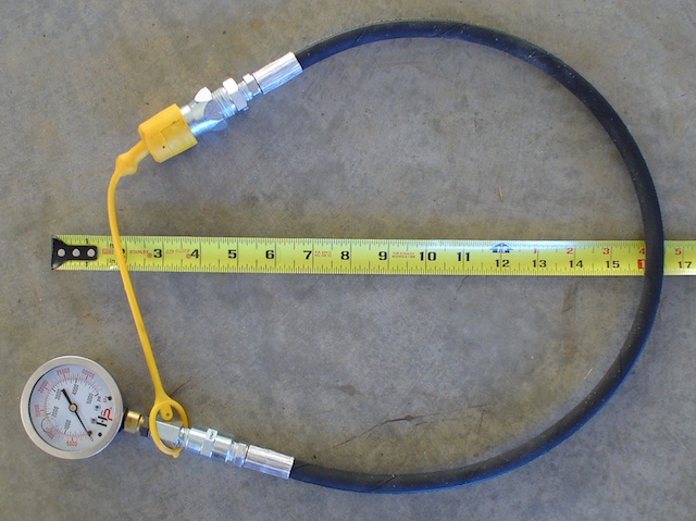

Finally, I listened to Kennyd and made a pressure gauge I could plug in. My 4520 was right on the money at 2500 pounds when the relief valve kicked in. I used teflon paste, not tape BTW- no leaks, no problems :thumbsup:.
Before the needle valve, I had to stop the tractor to adjust the tilt. Just the slightest movement of the joystick slammed it to one side or the other. Learned to manage it, but it could be better. Thought about a fixed orafice but liked the idea that I didn't have to be right about the size, I could just dial the needle valve until it was the response I thought was right.
So now it takes about 3-4 seconds to go from one side to the other, and I can adjust on the fly. It sounds different because you can hear the relief valve kick in, but thats OK, I know the pressure is where it should be.

To be frank, I wouldn't have accepted the job your dealer did with the hoses looped in front of the rear window. How have you been able to open the rear window to operate the IMatch latches? It is apparent that you went to lots of trouble to get this much neater appearance.
When I ran my couplers to the rear I used 1/4" x48" length hoses, I did not mount the quick couplers on a plate as yours. My quick couplers are forward and tucked under the cab. I haven't needed to unplug them yet and feel that this position allows you to route the hoses with less movement and flexing. Having the hoses cross over the pin or hinge point allows for less movement. My couplers do have enough slack to move out from under the cab to connect and disconnect easily.
If I were to do this again I would locate the tilt cylinder quick couplers to the spool valve, since there isn't much point in having the hoses crossing back and forth. The tilt cylinder hoses could connect in an almost straight path to the valve with quick coupler. Two 90 degree ells on the valve would take the place of the hoses we both have now.
About the needle valve setup, I suspect the check valves are causing your issues with control of the cylinders. IIRC most of the check valves require about 600 psi to open thus creating the slingshot effect you are getting. I can feather my cylinders and move the tilt and top cylinders in tiny increments with no problems just as you can with your loader and backhoe. I have never found the need for the check valves on the cylinders because when grading I am constantly making adjustments to the plane and boxblade. Instead of taking 4 seconds to extend or retract at full speed I would rather about 2 seconds or less. This allows you to adjust the boxblade on the fly, if I feather mine it could take over 5 seconds to extend or retract.
