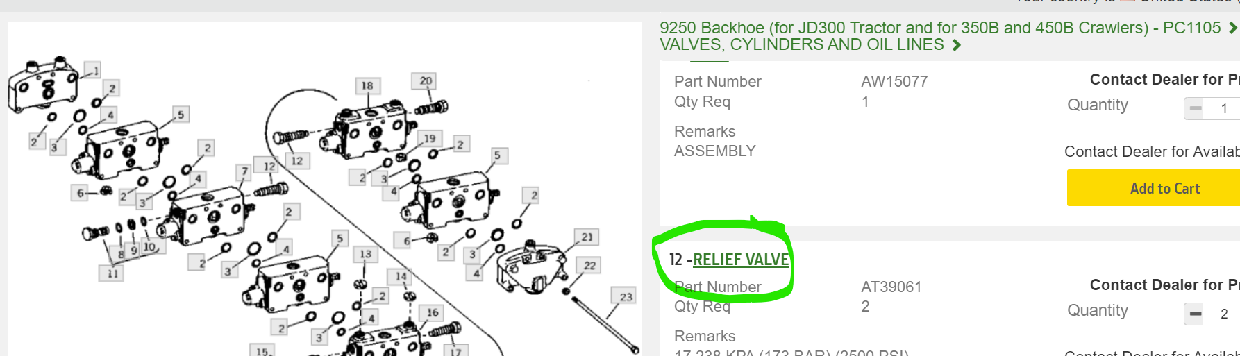

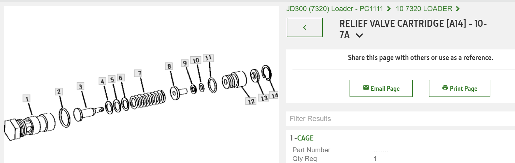

JD 300 uses a closed center hydraulic system, so there aren't any relief valves.
Sorry but your statement that JD 300 series hyd system utilizes no relief valves is inaccurate. The factory valve that controls front end loader & backhoe that fit 300 has relief valves.
Hm, no reason to apologize, thank you for correcting me. They do all have closed center hydraulics though, correct? My bigger point was that the system pressure is controlled by the pump, not a relief valve. So running to the end of a function would load an open center system, but would not load a closed center system. Relief valves aren't a part of normal operating parameters like they are with an open center system.
As I recall with mine, an excess load will cause destroking of the pump, not bypass through a relief valve. My response was just to the suggestion of plugged relief valves or something to that effect. It is my understanding that the pump will destroke to control pressure. That's how it worked with mine, maybe they aren't all the same.
I suspect those relief valves are there to control overpressurizing if an excess load is applied in another manner - I.E. curling a very heavy load with loader arms raised, allowing the arms to drop before buckling a cylinder or blowing a line.
