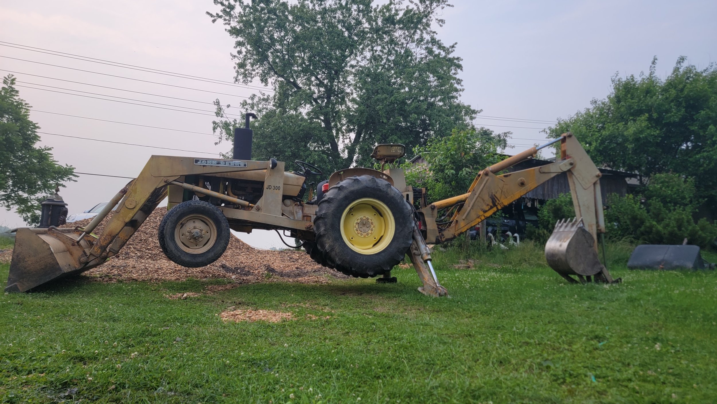

Hello, I recently purchased a JD300 backhoe/loader. First industrial heavy equipment I've purchased.
Issue is, when I need to start the backhoe, I need to pull the choke in and out and in and out and "pumping" the choke while turning the key for like 5 to 10 seconds to get it started.
Once started, it idles and revs up fine. But when I start to move or use the backhoe or loader, the engine slows down and stalls and dies. I can move forward and back only on the lowest gear, but even then the engine slows down a lot.

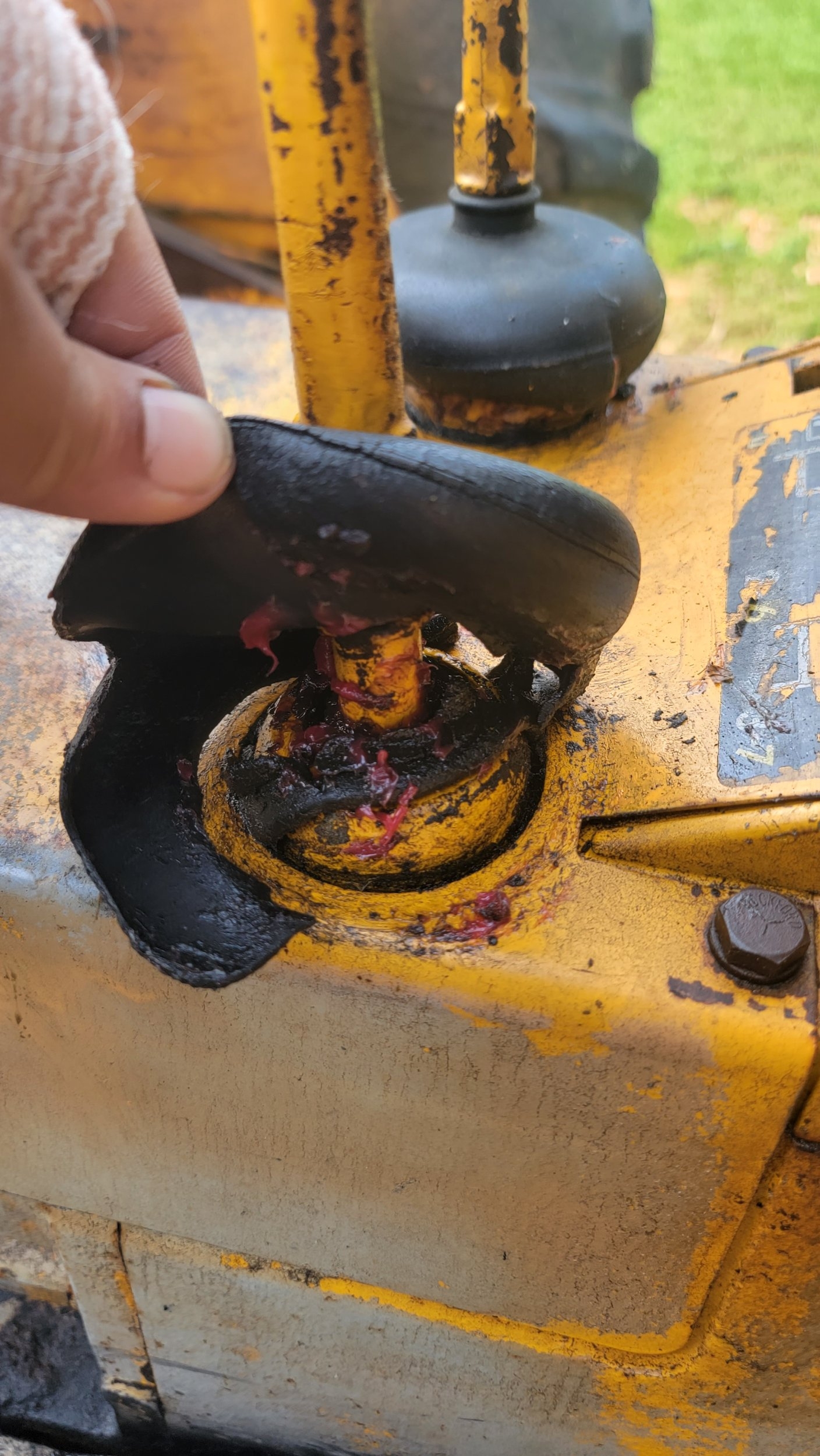

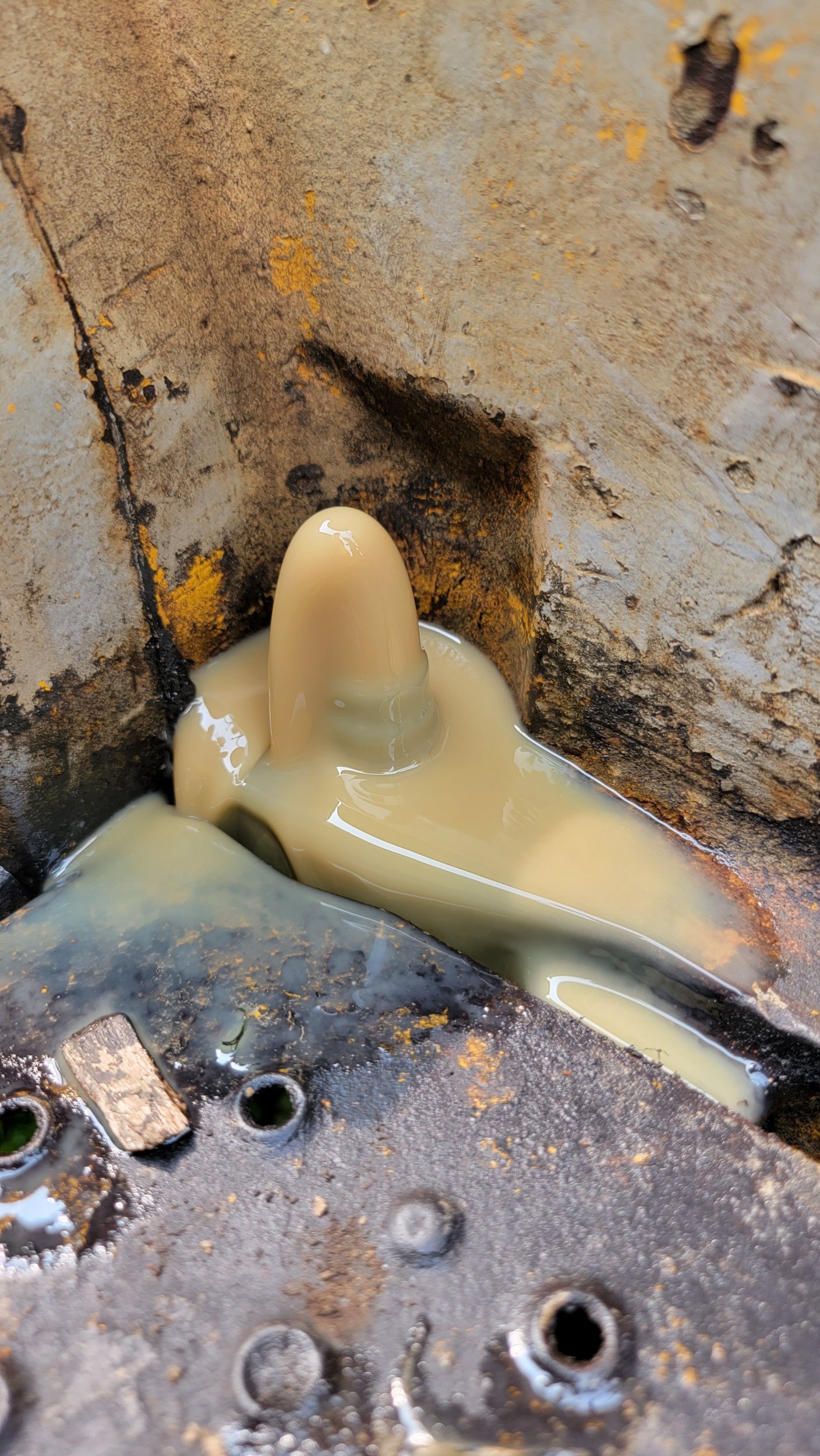

Thank you for the suggestions! The previous owner put on a new fuel tank so it looks clean. I did take the bottom bolt out of the carb bowl to drain that. I'm going to change the hydraulic fluid because when I opened the dipstick, hydraulic fluid just spilled out of it for a good...10 minutes? And it's not clear..more like a milky brown. Could the hydraulic oil being bad cause the engine to stall when in gear and moving forward?

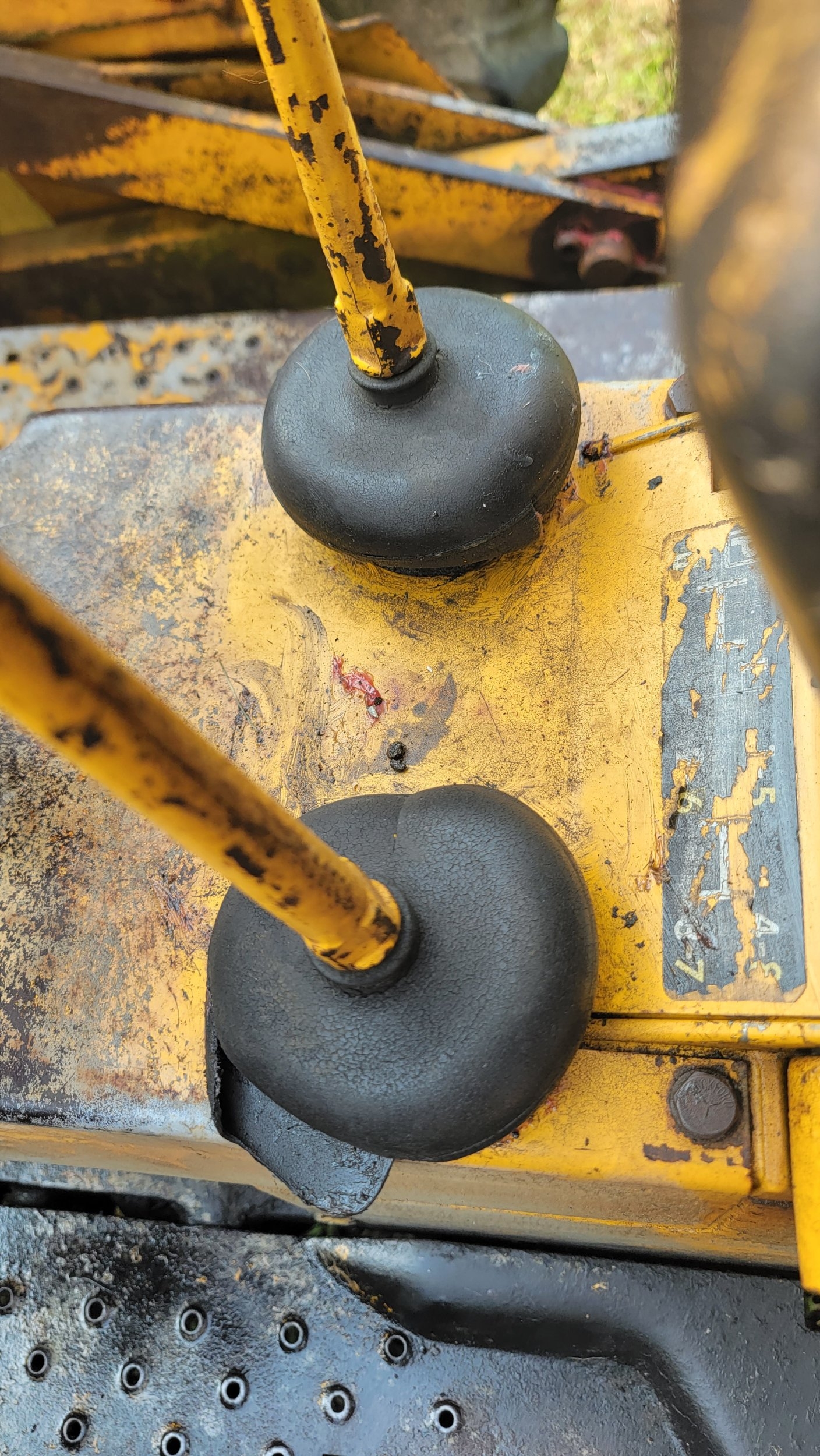

Try to find out how the water (rain or coolant) got into your hyd. oil. Solve that problem first, IMO. Is or was the coolant low? Or is there a way for rain water to get into the hyd. system, like a bad rubber boot around the shifters?
   / JD300 Rough Start and Stalls when moving or using hydraulics
Coolant is full. It was overheating but I cleaned the radiator and filled the coolant and it doesn't seem to be overheating now.
Is the shifters the two levers for gear and number? Yes those rubber things around them are cracked

Thank you I didn't even think of that to be an entry point. I'll get some new ones. Should I use hygard or low vis hygard? Looks like $125 for 5 gallons, any better suggestions on where to purchase? Also it says in the manual hydraulic capacity is 15 gallons but then later in the manual about maintenance it says it'll hold 10 gallons? Which is true?

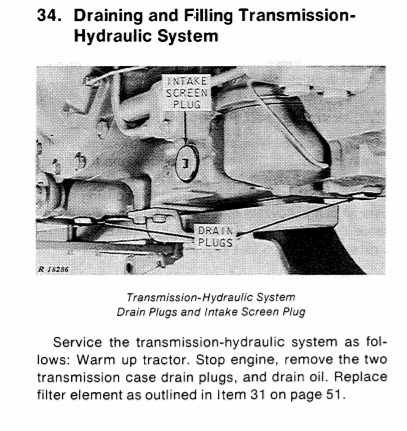

Engine coolant & hyd system on a JD 300 ind tractor has no direct connection. As previously mentioned cracked shifter boots is the most likely cause. It will take several oil changes to eliminate the water in 300 hyd system. Be sure breather in hyd filler cap isn't clogged. Also be sure to check/clean hyd oil suction screen

So should I change it with cheap hydraulic oil and then later fill with hygard? I'm not sure if I saw a breather in the filler cap, so I will check that today.
I will replace the hydrualic filter. Where would the hyd oil suction screen be located and what does it look like? Thank you

Oh nevermind. You sent the picture. Thank you so much! That is very helpful! What manual are you using? My manual didn't have that picture
