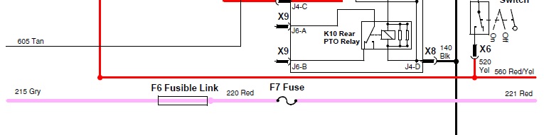

Thought I ran out of fuel, but added fuel and then could not hear the fuel pump run when the ignition key turned to on.
Service tech manual pages give schematics of electrical and test points to check. Indication there is a fusible link (F6) and fuse (F7) in the wire (221 red) to the pump.. cannot find where fuse (F7) is located.
Heard the fuel pump kick on when starting the x485 upon leaving the shed.
May have to remove the fender deck and check if voltage going to the fuel pump.. if so, then will plan to replace the pump.
Just had a thought tho, that if the fuel gauge sensor works, then that indicates there is power to the fuel pump..

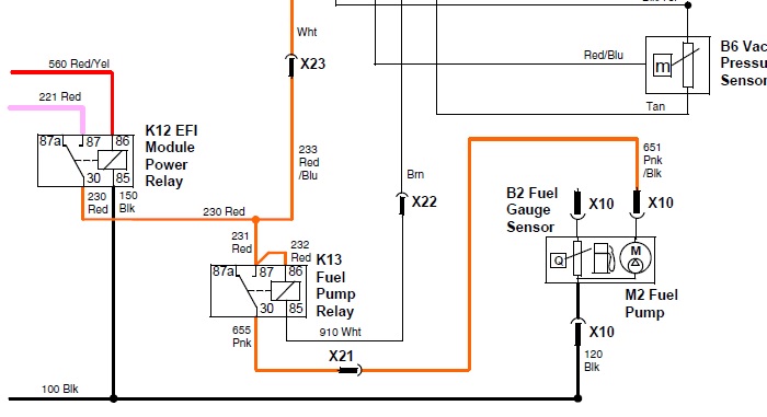

Attached files show the schematic with the fusible link and fuse feeding the 221 red wire. The next file shows this 221 red wire going to the EFI Module Power Relay and the Fuel Pump Relay, then on to the 651 pink/blk wire at the Fuel Sensor and Fuel pump. The Sensor gauge shows the added fuel so assume there is power at that fuel tank location.
Any additional thoughts much appreciated.

F7 fuse not in the fuse-block?
Fuel gauge and fuel pump share a common 'ground/earth' on the black wire in the X10 connector.
The feed from the gauge is grounded through the variable resistor in the tank which causes the gauge needle to move. You should find the gauge feed in the X10 comes from the dash cluster
The pump and gauge have separate power feeds but a common Ground.
Check for Fuel Pump power at the 30 terminal on the relay or the 655 Pink wire before lifting the seat base to access tank wiring further.
i.e the Relay only powers the pump.

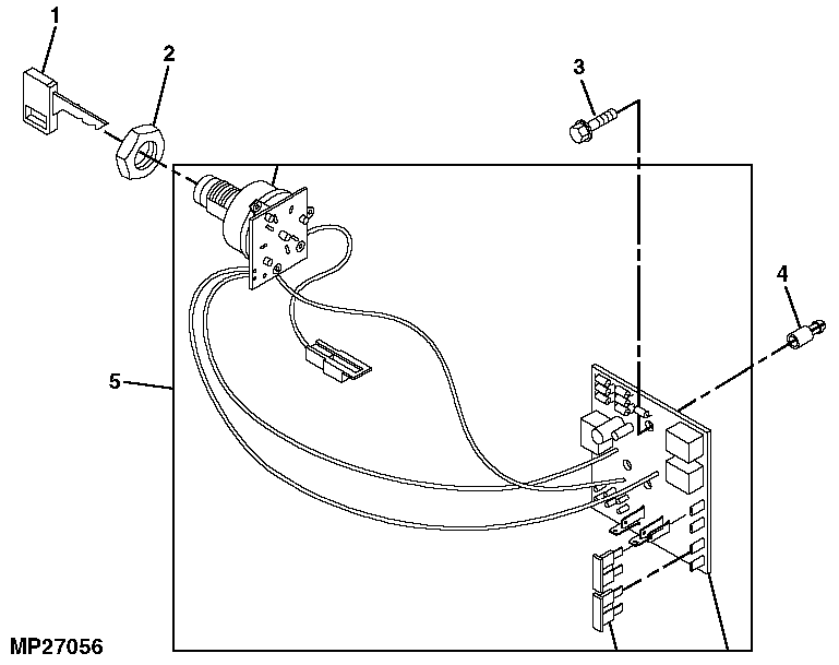

Open the hood and remove the right side screen. Look on the key switch module, it has two fuses. I don't know which is F7, but it might be one of these two. Lower right in the drawing

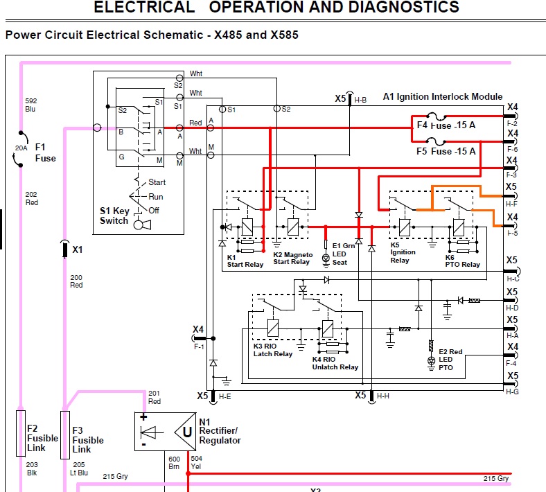

With a flashlight, checked the 15A fuses (looks like F4 and F5 on the Ignition Interlock Module board) and both ok. See attached, as found them on one of the many schematics.
Spanner, I recall a schematic with the F7 Fuse, but cannot find it again.. Will keep looking..

Yes, F4 & F5 on the board.
Don't look at the 'Schematics' now. Look at the illustrations. Perhaps "Fuel Pump Test" ?
The text will say check F7 and there will be a picture or drawing of the location of F7.

Checked out Spanners suggestion for voltage at the Fuel Pump Relay.. there is a connector (X21) from the pump relay to the Fuel pump that is hanging out and easy to get at (see pic of it disconnected) with pink wire connected to the pink/black wire.
The pink has battery voltage for about 2 sec after the key is turned on (same length of time that the service engine light comes on the instrument panel) then goes off.
Will have to look for the reason for that.
Think I will feed 12v to that pink/black wire to see if the fuel pump will run.. can then take that out of the equation.
Edit: Put 12v to the pink/black wire and fuel pump didn't function. So suspecting fuel pump needs replacing.

Lets go back a step.
How are you measuring the fuel pump performance? ('Sound' or disconnecting the fuel line and watching fuel pump through?)
The K13 Fuel Pump Relay goes off after a second or two? (Measured at the X21 connector which is the 655 wire/30 terminal I suggested.)
But the K13 gets its power direct from the K12 EFI Module Power Relay beside it. (221 Red Live power 'In' and 230 Red 'Out' to power the K13.)
So, go back a step and check that the K12 isn't failing to 'Hold' in for more than a brief second or two. (Measure Voltage at the 221-Red first to prove the power supply and then at the 230-Red (30 terminal) 'output' when you turn the key switch 'On')
That K12 relay is controlled by the 560-Red wire. Where does that come from?? You can measure the voltage on that wire also.
All of these circuits share the 'Ground' through the 100-Black wire spliced with the 150 & 120. These are normally crimped splice connections. Check your Ground/Earth circuits also for continuity.
The K12 & K13 relays are identical and you can swap them over to check the K12 is/isn't working.

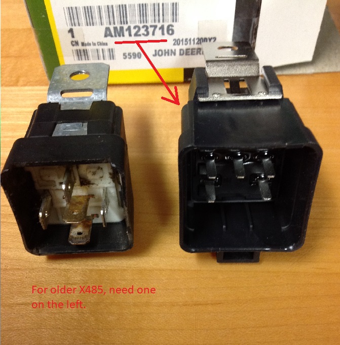

Learned my pre-40000 s/n x485 has different set of relay's than post 40000. Part #AT75769 instead of AM123716.
Chasing down another new one as prefer to switch in a new one and not try moving existing ones around. There are three in the pre-40000 apparently and 4 of different style in the post 40000. Just more delay.. Have not removed seat and fender deck yet.. but if relays don't suggest a different problem, will change up to the new post 40000 fuel pump assembly.

Yes, the later S/n relays have all pins in a straight line whereas the earlier models have the traditional relay with pins in a 'T-cross pattern'.
Later model Fuel Pump has some subtle differences to be aware of. Harness connector is different. There is a short adaptor harness to make the connection work. #AM133839.

After exchange, now have the correct relay.. but a dinner party tonight will keep me occupied until tomorrow morning.. thanks for the help.. some I knew, but some I'll be finding out I'm sure. Good to have the heads up.
Relay differences that you mention.

Yes both have 5-pins and they are numbered the same so you can make jumper wires to adapt the newer one if desperate.
The change is an annoying result of the automotive industry move to smaller pins and fuses etc.

Two more relays to check.
K5 which is the IGN Relay on the Ignition interlock module. It powers K11, which is the Module Ground relay for the Fuel Injection Module.
Both needed for the fuel pump to run.
