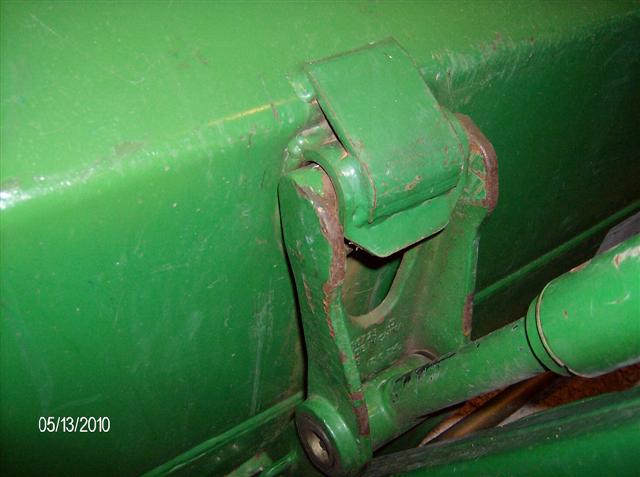

Does any body know of a source for the "weld-on "hooks" to make other attachments for the 300 loader? I can make my own, but it would be easier to buy "ready-made" if they aren't too high. ~~ grnspot110

You can get them from JD parts. A couple years back I got those brackets and the lower pins. I got them for 200 loader, but I think it's the same parts for the 300. I think the whole set was only around $60. I definitely thought that was easier than building the parts.
/ JD Quick-Attach Brackets #6
You can buy the "hooks" and "pins" from JDParts...The #'s are:
W47211 PIN,
W43359 HOOK, BUCKET

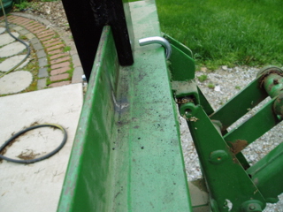

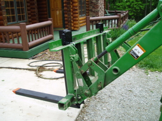

Or you can make your own with angle iron and CAT3 pins, see attached pictures.

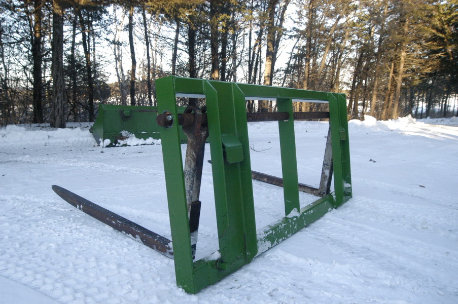

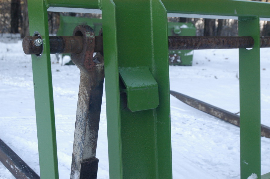

It isn't a weight factor for me, I take mine of when mowing (3-pt finish mower) & the tractor is stored inside, the bucket outside (shortage of space)!
Got the boom finished, both hook & boom have been cleaned up & painted after pictures were taken!
Next, a set of pallet forks! ~~ grnspot110

Nice job on the boom. How long is it?
