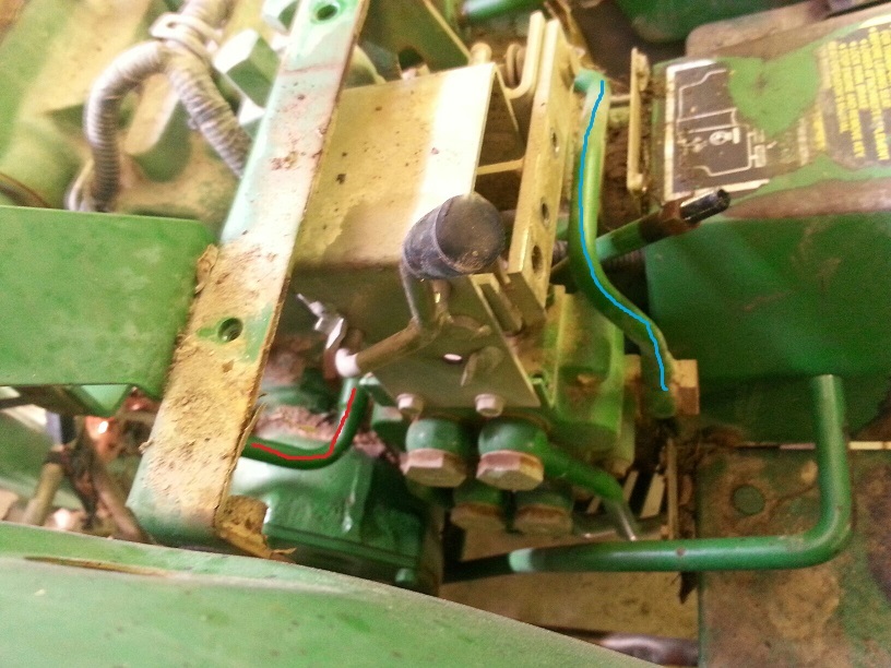

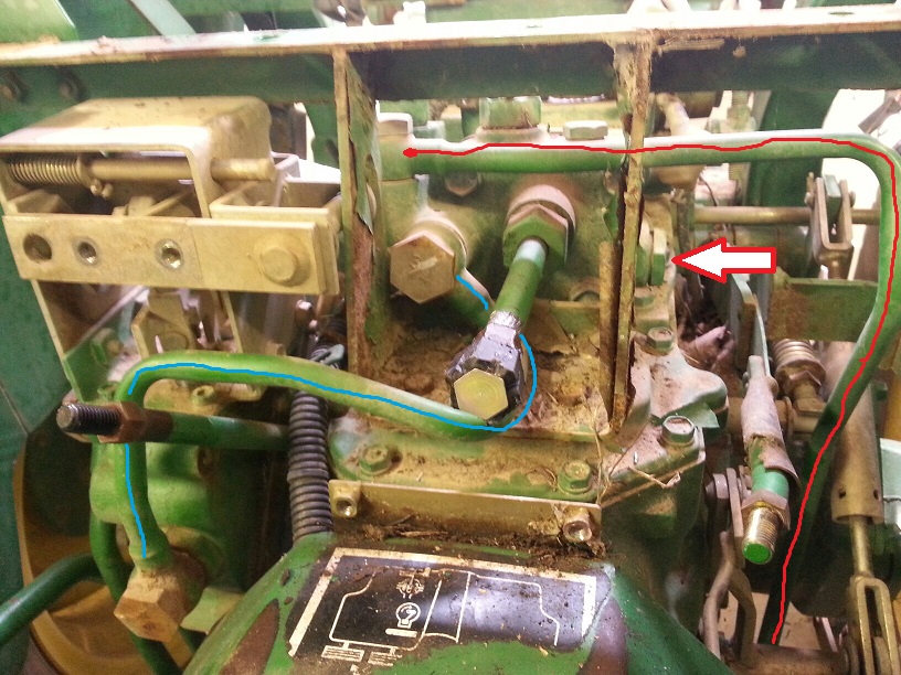

I haven't abandoned this yet, just got sidetracked. So, the pump feeds the rockshaft case that feeds the Danfoss loader valve. The PB is then tied back to the rockshaft case. Red is from the pump and blue is from the loader PB. I'm thinking I can pull the plug (arrow) and replace with a banjo.
Second drawing is loader valve, same color code

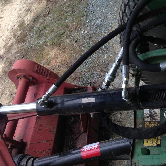

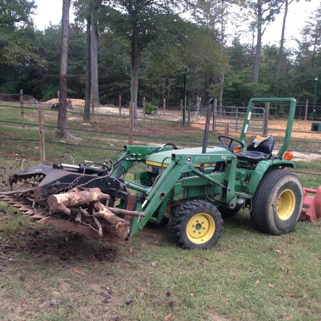

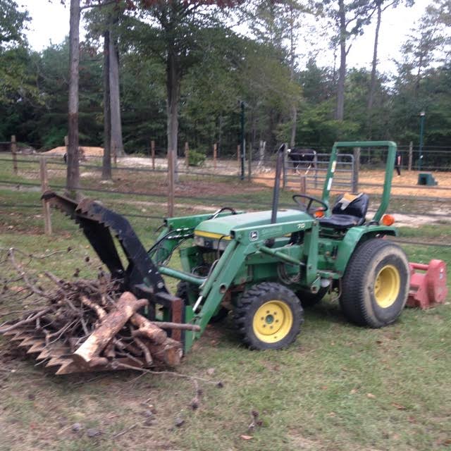

To finish this up, the Danfoss loader valve is supply side, the rockshaft case is the return. I removed the line between these two (second drawing above, blue) to plumb in a 3 spool valve from a JD 400 garden tractor. It tucked in nicely on the left side of the seat. Now have hydraulic toplink, sidelink (no cylinder yet) and front remote. Need to fab up some better handles, but for ~$300.00 we're up and running. I also built a SS quick attach to swap from bucket to grapple.
