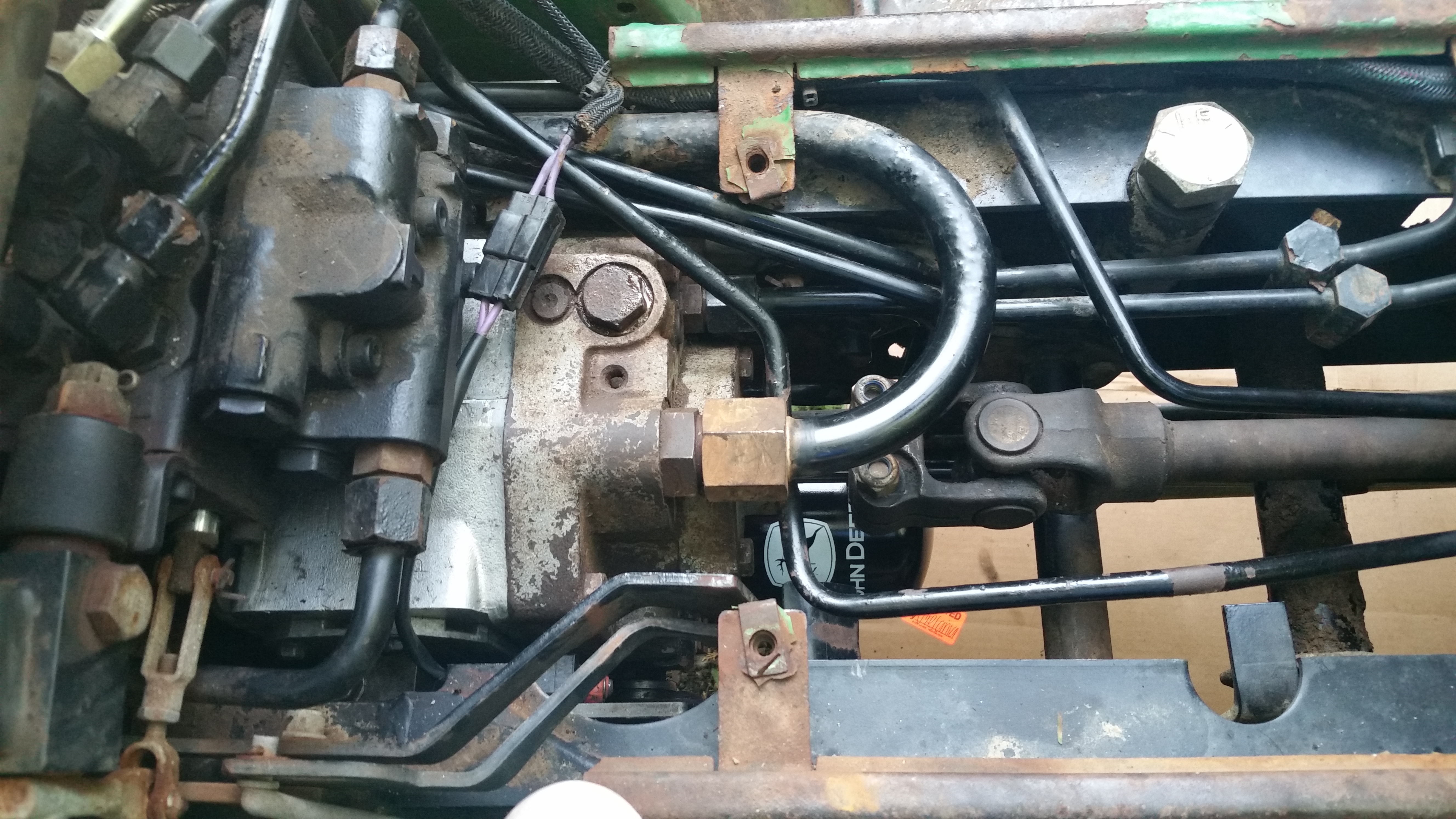

Another update on the 755, my brother and I were able to successfully re-install the hydro-trans yesterday. We ended up using a make shift lifting eye and used the ROPS to hoist it up, my brother lifting and I was underneath guiding it. It was a bit tricky getting it in there but after about 30 minutes, we succeeded. After that, we were able to get the drive shaft installed and the MFWD link sort of installed. We still need to get the pin hole to line up on the MFWD and will have to jack the front end in order to get it aligned and the pin re-installed.
After that, it's pretty much adding the Hy-Gard, checking the rest of the fluid levels and then doing a start up on it. What do you guys recommend for start up procedures since its been sitting a while? The tractor was last running to my knowledge at the end of November of 2016. Is there a way to prime some of the hydraulic lines and hydro transmission? And do you think I need to purge the fuel tank and add new fuel in it since its been sitting? Would just adding some fuel and fuel treatment be okay?

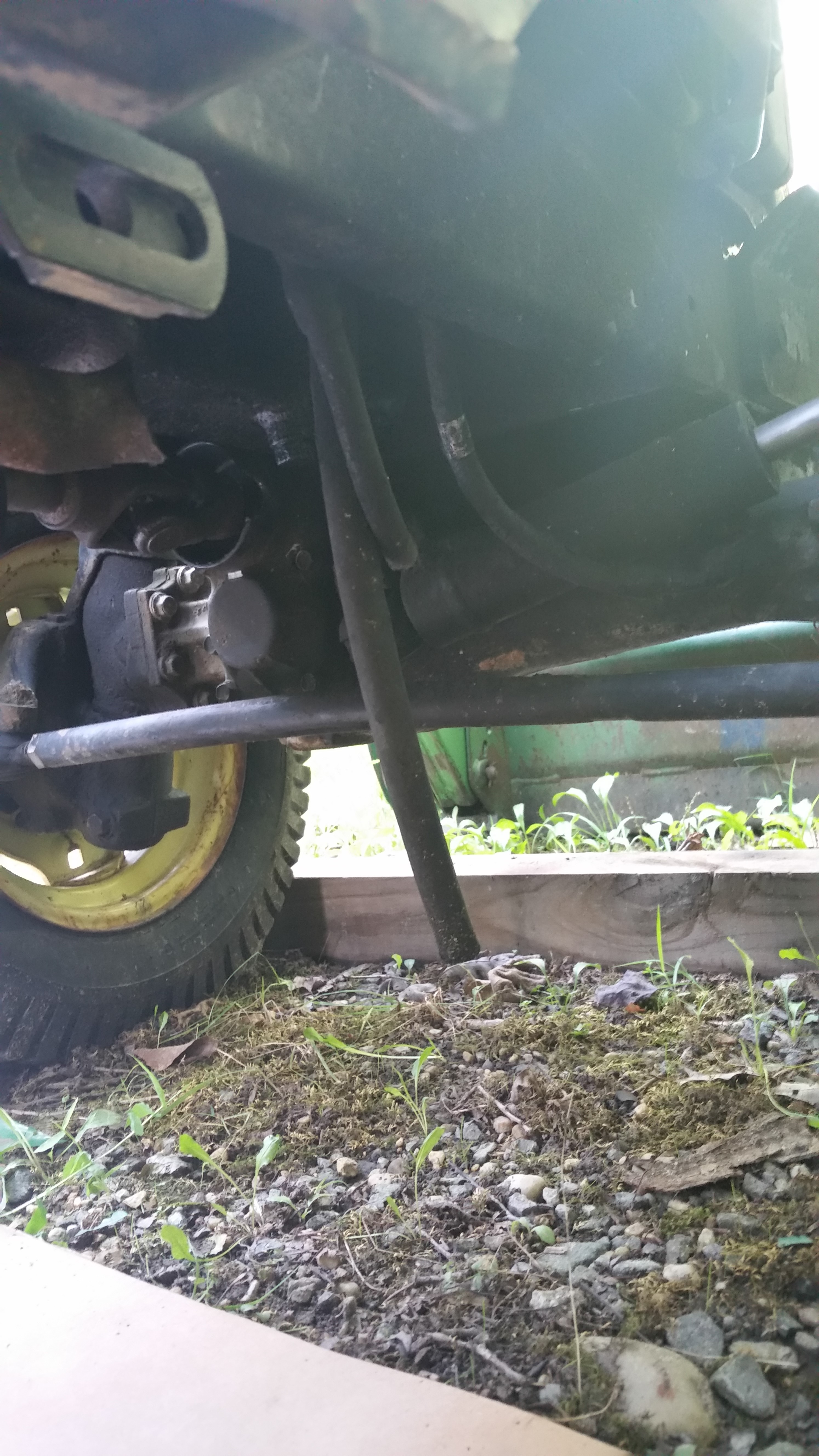

And lastly, I was underneath the tractor and there was a hose coming down from the front. Do you guys happen to know if this is for? Here's some a pic of it and the trans installed.

? Inside sitting that long, or outside? undercover or in the open?
/ JD 755 Project
#25
Its been outside and in the open that long
/ JD 755 Project #26
Given the long outdoor storage it might be prudent to drain the fuel and be sure of no water. Fit a new fuel filter too.
Hydraulic lines should self-purge upon start-up.
With the seat base and floor off now is a great time to grease that driveshaft UJ shown in your picture. (The joint with the loose clamp bolts. Make sure you tighten them asap.)
The 'pipe' hanging down could be the engine breather tube. Follow it upwards and confirm it connects to the rocker cover breather?

/ JD 755 Project #37
Fuel fill overflow tube???
It does look like the fuel fill overflow tube. They degrade and pull away from the fitting just below the fuel cap.

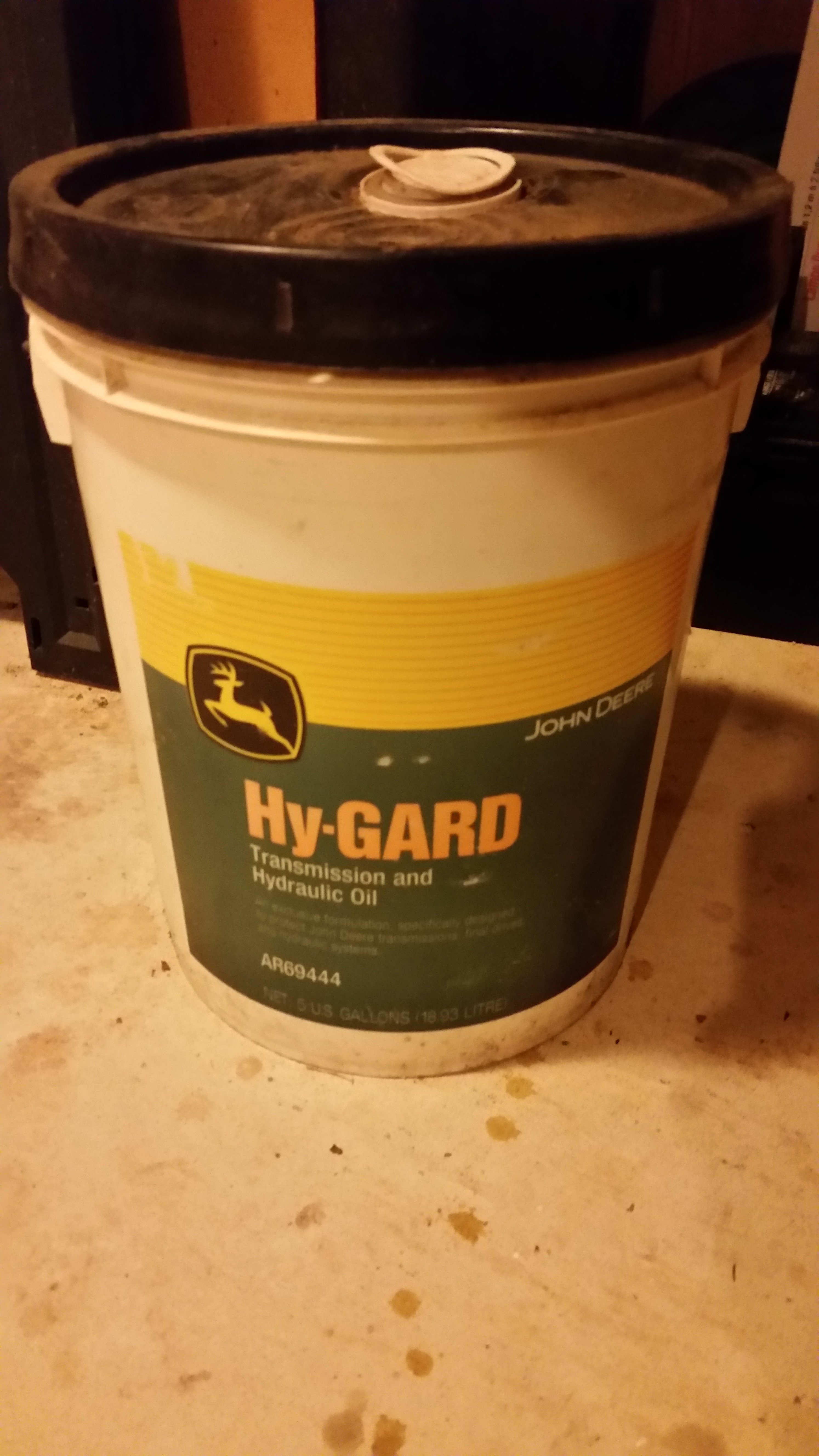

We didn't end up using the left over HyGard on the tractor because it looked like it had been previously opened and weren't really sure if it was hydraulic fluid. This set us back a week and last Friday, I stopped by the local JD dealer and bought 5 1 gallon buckets of low-viscosity HyGard. I ended up buying some diesel fuel treatment from Amazon and putting that in the fuel tank and didn't bother draining it.
