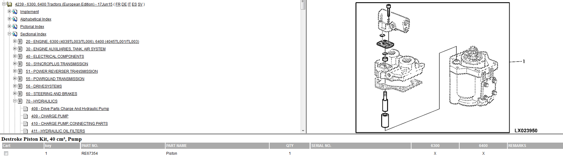

Your tractors starting problem sounds similar to older JD tractors such as 3020/4020's that CC hyd pump was trying to build pressure during starting procedure putting extra load on starter. I see JD once offered a hyd pump destroking kit for 6400 which is NLA. The part RE67354 is no longer available. Contact your local John Deere dealer for other options.

Might look into that tx jim, thanks for replying, I'll look at the electrical things first such as starter relay etc, just because it located so far from civilisation etc ... lol. 😂 And it would be an easier fix if it was electrical
