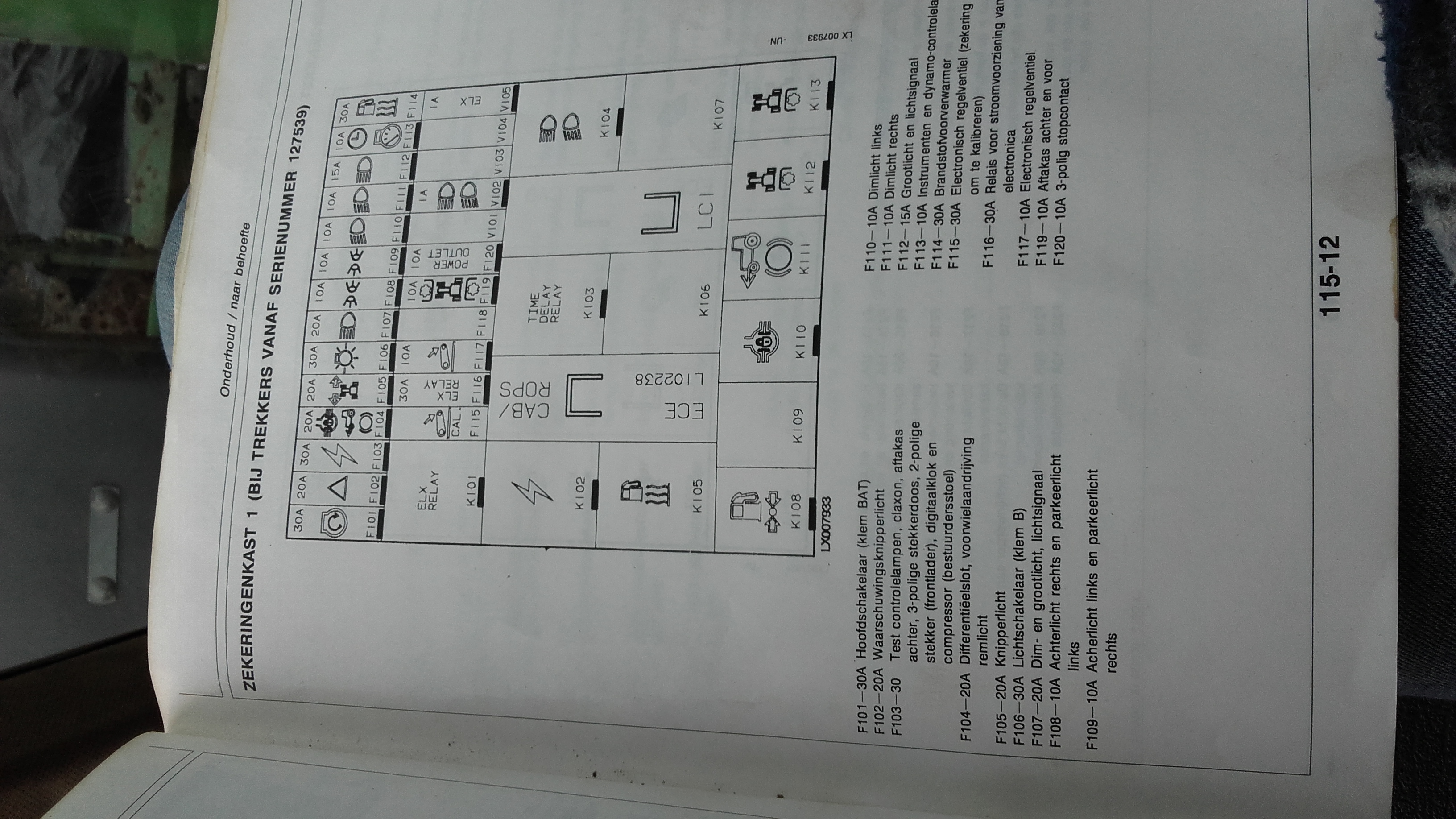

But in my manuell there is a picture of the fuse box.
I have make a picture of it so you can see what i meen.
The fuse F102 and F105 I thought this are the fuses for turn left/richt and the hazard lights.
This fuses or good.
Ol so the relays: K111,K112 and K113 or in my opinion not for turn left turn right or hazard lights
Maybe you can see on this picture something you say that can help you.
thanks in advance for the help
Kind regards
MantsjeKlaas
This fuses or good.
Kind regards
MantsjeKlaas
Sorry, I was thinking a made for USA tractor. You must have European edition?

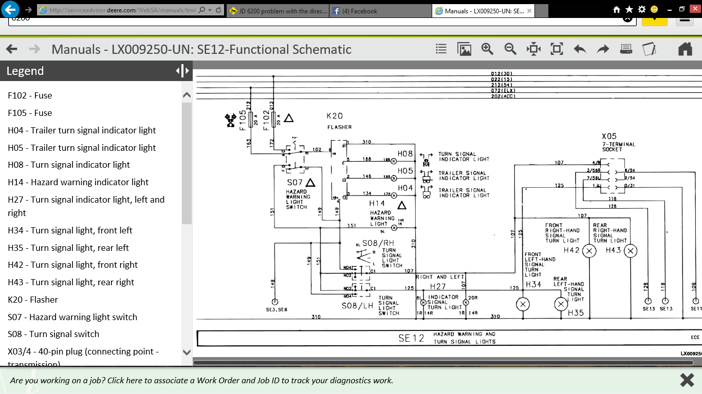

Looks like all power goes through the warning light switch. May be something wrong there. Here is the wiring diagram ...
